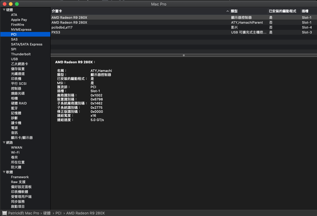

Hai bro..
my 3.1 run Mojave 14.4.6 patch from dosdude...
and msi R9 280x flashed mac efi.rom get metal support ..
everything look good....but Im get OpebCL bandwidth only 61 fps
it that normal...?????
it no full graphics acceleration ..?
.....am I miss something ..?

Your card is fine.
You use the wrong benchmark. Your card is too strong for that, and will able to deliver way over 60 FPS. However, the v-sync limited the FPS to 60. That's why you have that 61.7.
I just made a short video to illustrate how this OceanWave benchmark affected by v-sync.
[P.S. My monitor has 144Hz refresh rate, that's why my score is around 144 when v-sync is ON]

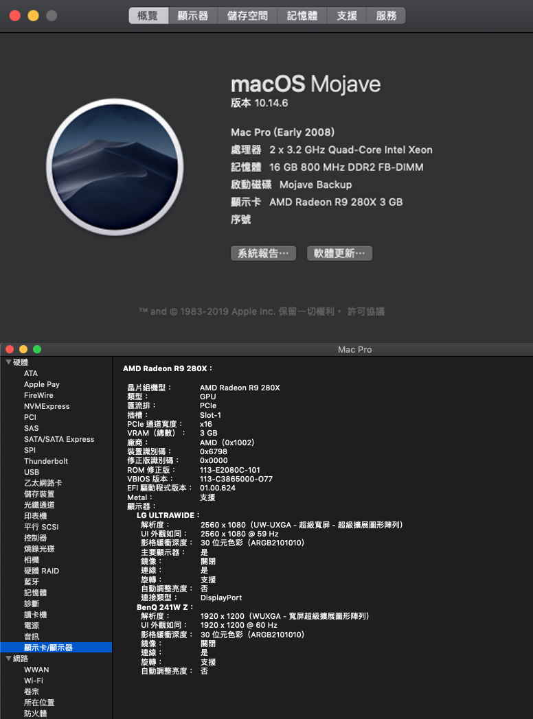

same Mojave & Catalina on patch in 3.1
thanks bro for reply..
and now open Virtual machines...make slow down the speed...
but GTX 680...is no issue
lucky it get 410.7 fps ++
is it unsupport R9 280x right...???

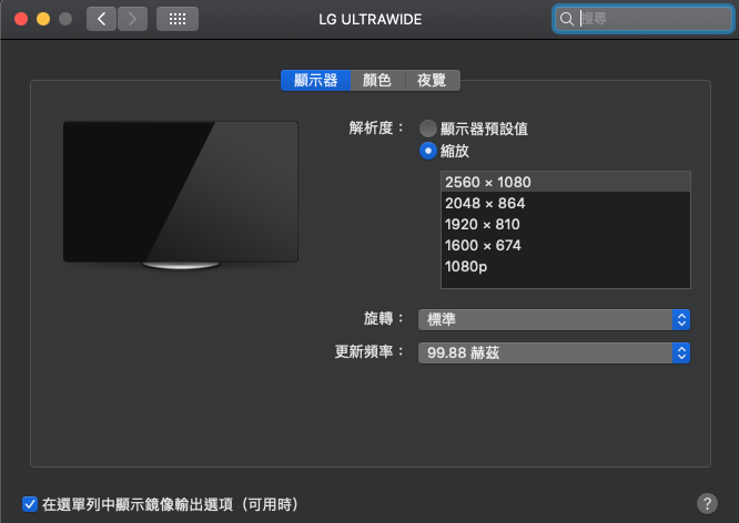

btw my LG ultrawide FreeSync was off
now i get what u means.
that i set Display Preference on 99.88 hz and turn on Freesync
and now a little bit speed up over 60 fps

For 3,1, there should be a power management bug for 280X, which may make the card can’t even deliver 50% of its performance.
I am not sure if that also exist in patcher Mojave or Catalina.
Anyway, please use Luxmark to check the card’s performance. That’s much more reliable and stable. So that easier to diagnose or compare.
