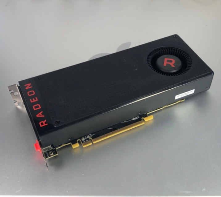

But that shouldn't be a problem because i did read online many people with no problem with the card with only the 6pin plugged in.
Some even saying that it worked with any of them plugged in.
So like this it should work anyways no?
All these cards have different power envelopes and requirements. You may be able to use the 6 pin if you modify the power table. Apparently in your case 6 pin can't power through the 8 pin on the card.
Ok so i can't use 2 sata ports, but i can try to use one.
So i just ordered a dual mini 6 pin to 8 pin cable and a sata to 6 pin cable.
This should do the trick no?
I really hope so.
if you don't perform videocard demanding tasks it should work. But it is nit recommended. I would also get an EVGA powerlink to combine all of them.
But this way it has all the electric plugs it asks, with all the electrical needs.
Because tgis card only has a 6 pin and a 8 pin connectors

Sata only provides 54W and the 6 pin requires 75W.
Os gosh, i'm really praying it works.
But i don't understand, i did read people online using this same card only with the 6 pin connected...

At least 2xmini 6 pin to 8 pin - and another 8 pin to 2x6plus2.
To give load balancing and to power both the 6 pin and the 8 pin.
In theory thats 225 watt max and overloads the board - but imo better than using adapters and blocking sata ports. Plus the danger of cross currents what may flow between sata and pcie Power ports.
Saviest is getting the power from the psu by pixlas mod or alike.

Its not 100% clear: I mean two mini 6 pin to one single 8 pin. Like this
Any photo? It's hard to know how you powering the card exactly, and hard to know if you do it correctly (or at least in a workable way)
Reactions: Macschrauber
If you are powering the 8 pin connector with the mini 6 pin alone it will not work. You need to power the 8 pin with 2 mini 6 pins and the 6 pin with 2 SATA to 6 pin cable.
Well, i tried with the 2x mini six pin to 8 pin and nothing, tried to put a 8 pin to 2x 6+2 pin on the tip of that one and the comouter doesn't even start. And unfortunetly i can loose two sata ports on the computer. One i could try but two is too much.
Looks like the only option is sell this card and buy another one.
I did read that the rx580 works without any problems with just a 8 pin.
Is there any specific version/brand of it that is better?
Would it work out of the box with my mac and the macos 10.12.6?
thanks mate but it was not enough :(
If you gonna buy RX580 I would recommend the reference model:
This card has 2 slots width and does not interfere with a device installed in the second PCIE slot. This particular model has an 8 pin connector. There is an RX-480 with a reference model design which looks exactly the same as this one, but it uses 6 pin connector. I personally have 2 RX-480 reference models, but some people do not recommend them due to excessive power draw from the PCIE slot.

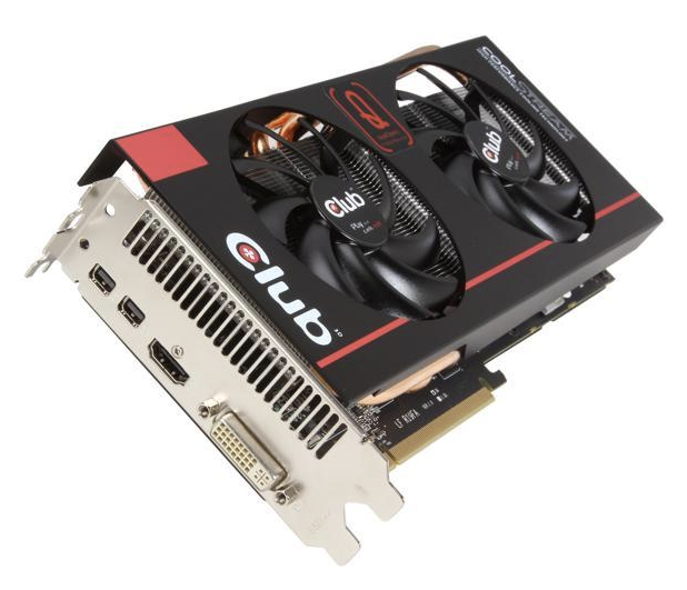

Hi guys,
I have already done a few changes of the firmware in the graphics card, until today it is still 7950 and there have never been problems, even in cards that had a BIOS switch,
today I wanted to "make" the R9 280X for the first time,
the operation of adding efi itself went ok but after flashing the card nothing has changed, no boot screen, no full card name in OSX,
I switched the switch on the card to another BIOS and repeated the whole operation, this time everything as expected, there is boot screen, name 7950 in OSX :)
maybe my story will help someone
my card is:
Club 3D royalQueen Radeon R9 280X
This is the expected behaviour of all 7950/7970 cards. Switch 1 is the legacy BIOS and is flashable. Switch 2 is the UEFI BIOS and is not flashable.
I had an HIS HD 7950 and currently ( my spare GPU ) is a Sapphire dual-X HD 7970. I EFI flashed both cards 9 AND downvolted the 7970.
NOTE : I always have used BIOS SWITCH Position #2
No issues at all.
Power cables for the HD 7970.
TWO x Mini 6 pin - plus - ONE dual SATA to 6 pin.
NOTE : BOTH of the 7970's power sockets must be powered.​
