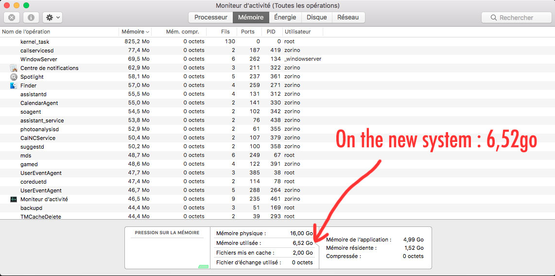

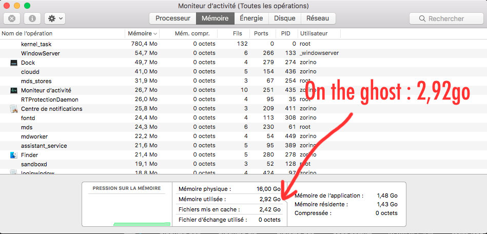

Hello AppleMacFinder ! Hey Everybody !!
I had to re-apply the ( great ) fix ( because : reseted Pram and Smc ).
No problem to apply the fix ( for 3rd time for me ) but ...
When I checked Activity Monitor ( see attachments ) :
The first time i had to apply the fix ( 2017 ), everything Ok.
The second time ( 2019 ): My system started with with 6go ram already used on 16go installed. ( I mean on Activity Monitor ). I fixed the problem with Onyx ( Automation : cache rebuilded ).
The Third time ( today ) : I applied the fix, and when I checked Activity Monitor bim ! again : more than 6go already used, without any application launched.
I tried : AppleJack, Onyx, Yasu, nothing worked ... ( note : they don't kill the fix )
Before patching, I made a Ghost with Carbon Copy Cloner.
So I am able to boot on my old system with external drive to compare both system. ( the ghost was alrealy patched with AppleMacFinder's fix )
See attachments : less than 3GO before - Now, 7go
So i decided to replace the actual system by the Ghost.
and when i restarted ... My system used 7go de ram again, with exacty the same system i checked on the ghost 30 mn before ( the ghost use only 3go ).
Still some cache somewhere ... prelinkedkernel ?
If someone can help me, thanks.
