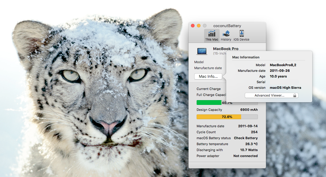

Remains to be 100% stock, never clean installed unsure what to do with it. Recently it's been standing in as the HTPC due to the 2014 13" MBP going haywire.
Q-6
Reactions: 0134168
