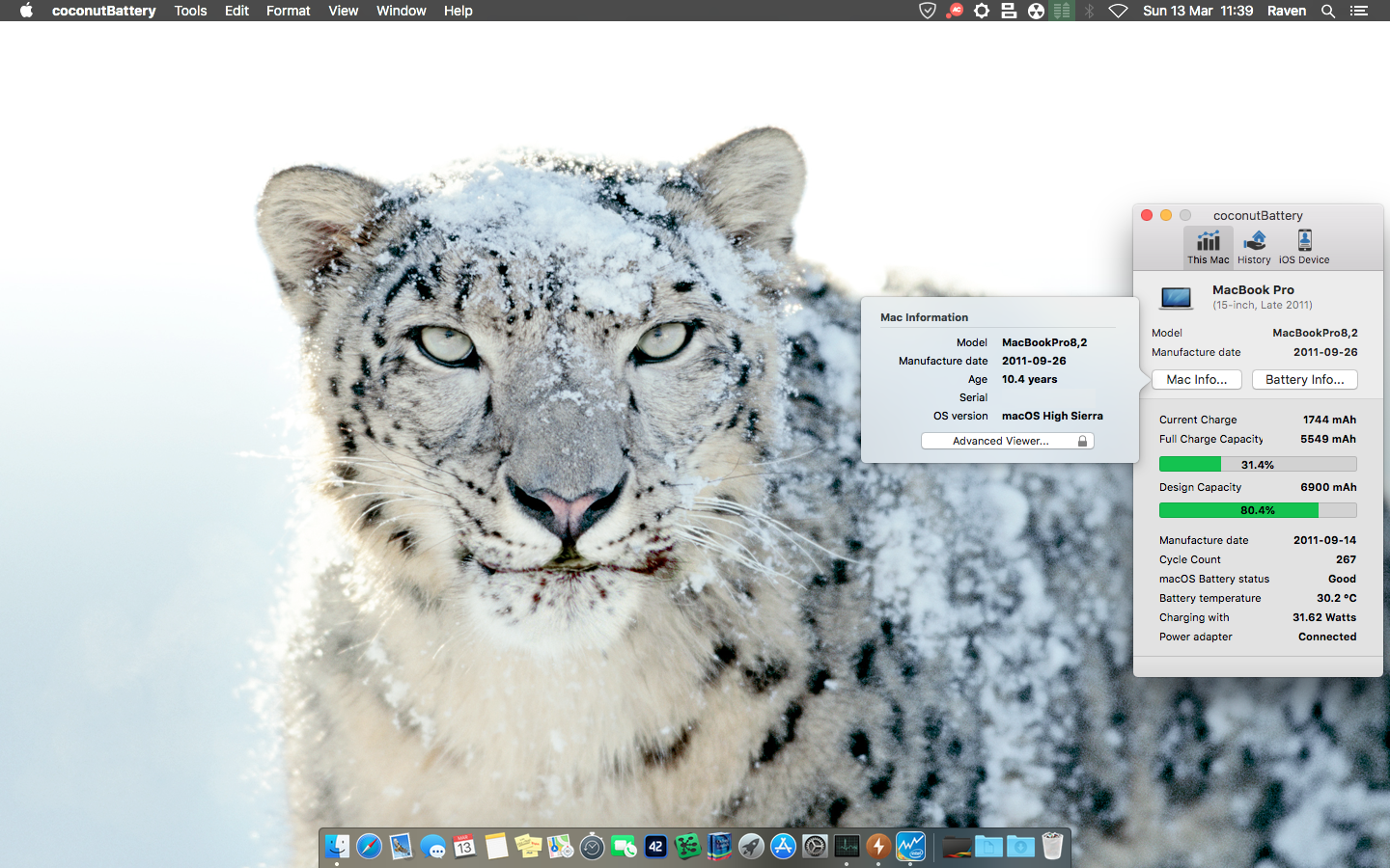

Never Clean Installed, 100% stock including the battery, runs well and truly owes me nothing. For any serious workloads I have an M1 Mac and PC's...
This 2011 MBP was used by myself professionally, passed around the family. My daughter used it to game until it didn't. The notebook then sat dead in a box for a good year, enter COVID & time on hands. I cleaned up the SW image and thx to FW/SW updates from Apple the 2011 now runs better than when I first booted it up fresh out the box back in 2011, doesn't even throttle :)
When this 2011 fails, it fails I don't worry about it...
