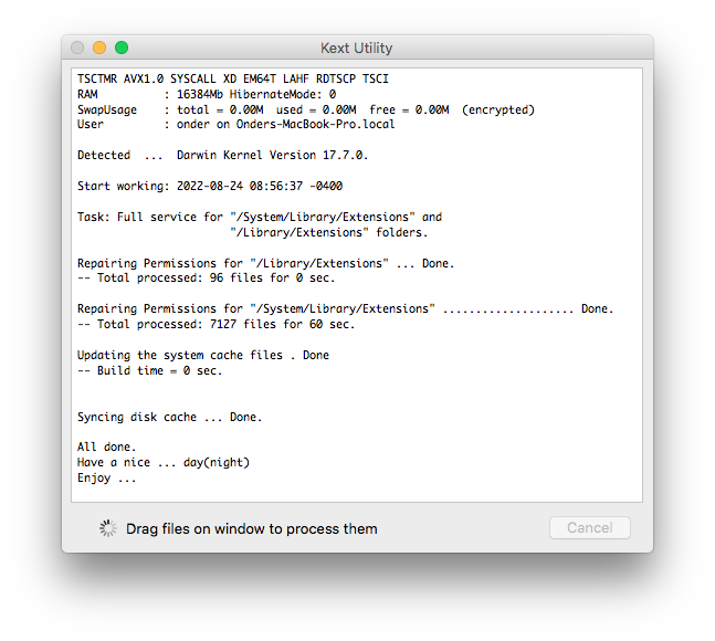

edit2: Alright, I run the kext utility at first it says repairing permissions and makes me wait for about a minute then gives me this screen;

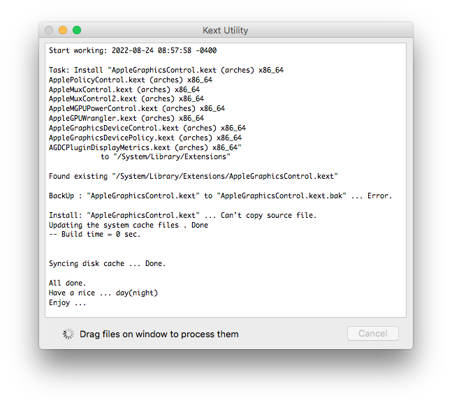

Then I drag and drop AppleGraphicsConrol.kext file but it gives me an error saying like this;

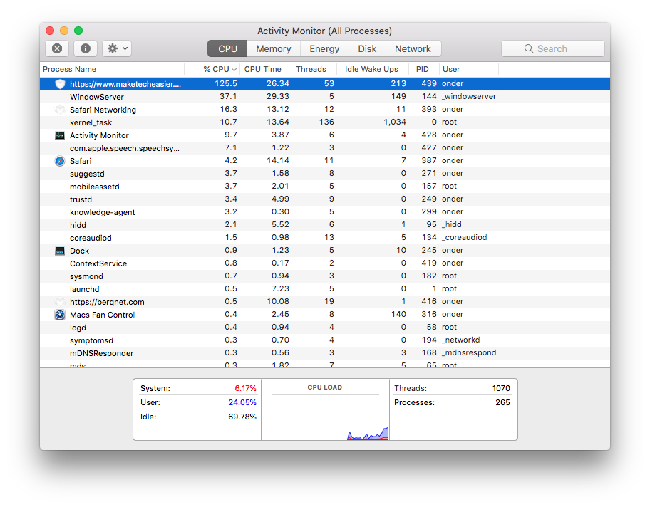

Lastly, after running this program the cpu temp has increased and found this process on activity monitor;
Okay turns out that's the website I opened while looking for kext editor and somehow it makes the cpu run at 97 Celsius degree.

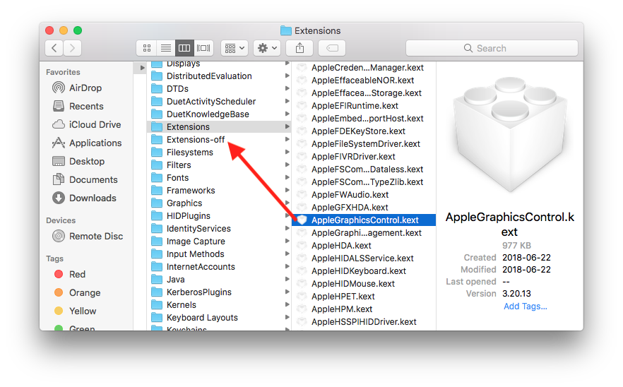

one last thing; Can I move this kext file to the extensions-off folder and copy and paste the new kext file I downloaded to the extensions folder?
Okay I saw that was a super silly question :D
