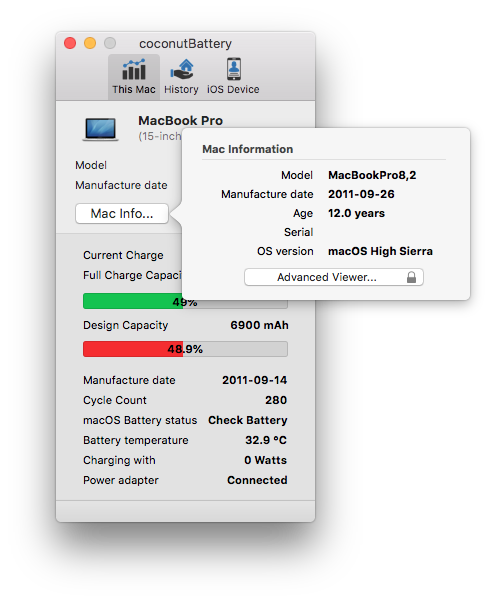

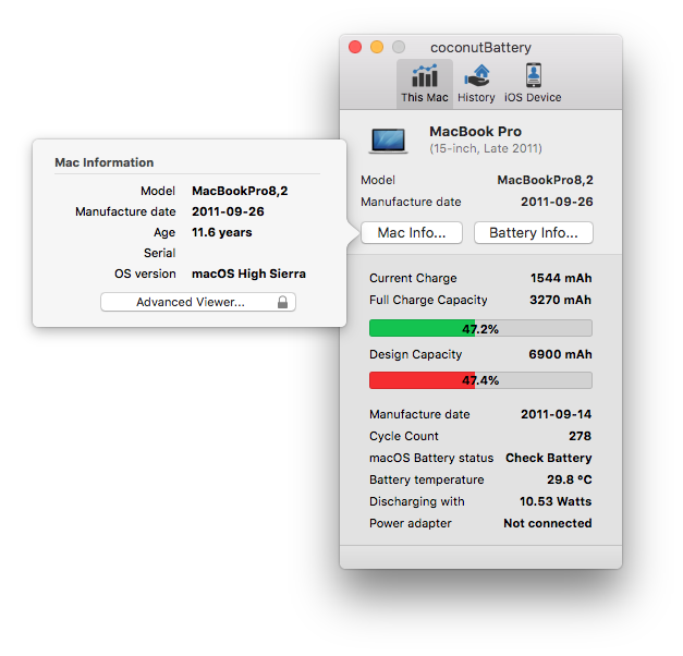

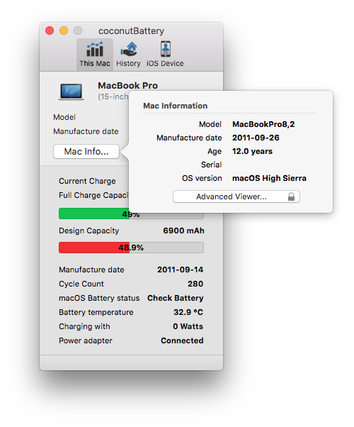

After owing the 2011 from day one I dont overly worry about it. The MBP will likely remain on High Serra as it's the simplest solution for my needs and it works without any issues or deficits. If I advance the OS it will only serve to create complications with few if any if any benefit.
The API may be mentioned on the gSwitch site, other than that would need to research. Think I would want to investigate the difference in voltage between High Sierra & Mojave, if the dGPU kicks in may raise issue. gSwitch was indeed designed for High Serra if memory serves and is a big improvement on the older GFXCardStatus.
The later 15" MBP 8.2 is more complex to deal with and to get full functionality will likely require HW modification. Detailed instructions are on dosdude1's site. As my own 8.2 has been well and truly used with the dGPU active for multiple years. gSwitch keeps the dGPU in it's idle state so I rather expect it to run until something eventually fails due to age.
Biggest concern is the battery as it's now below 50% of capacity,. Doubt many of the available replacements will be greatly better at this age. When the time comes may look to rebuild the battery pack as that may be the best option short of removing it. Right now I'm using a script to stop charging at 50% which seems to be helping to slow the wear rate on the battery.
Either ways been a great value at over 11.6 years old and never been much of a problem :) I have several other Mac's including an M1 MBP so the 2011 isn't a priority system for me, equally it serves purpose :)

@dowser With the Late 2011 15" MBP you need to mod the HW if the dGPU is fully disabled in SW, hence the instability & loss of some functionality. The Early 2011 15" MBP is more forgiving with far more chance of retaining full functionality with a SW disabled dGPU. My 2011 is a Late model, it's dGPU is fully functional, yet is heavily restricted by gSwitch. Only time it's activated is on a cold boot, soon as gSwitch is loaded the Intel GPU is forced on in a matter of milliseconds.
I literally shut it down yesterday to check the battery, clean the fans & heatsinks. Likely the first time in over a year. It's up 24/7 as it's now our media server and maybe that's the key to it's longevity as it keeps a stable operating temperature.
The solution is to wipe and install High Sierra and use gSwitch if the dGPU is still good. If the dGPU is damaged is a very different story. As ever with a notebook of such age we're just buying time day by day. I deliberately kept the 2011 in the family as I was very much aware that they are timebombs. Ironically the 2011 has seen off multiple Retina Mac's, I fully expect my 2014 MBP to fold in the near future as it shows all the signs. The 2011 has never ran better, it's a 100% stock machine performance remains strong hitting the power limits way before TDP, never throttles even under extreme loads such as HandBrake, fans don't even pass 5K.
I'm guestimating it's way past 50K hours of up time. My 2008 15" MBP battery exploded at around 50K operating hours. My brother in-law bought the same 2011 model, gave him no end of trouble, battery swelled and resultantly broke the trackpad, eventually the dGPU let go...
