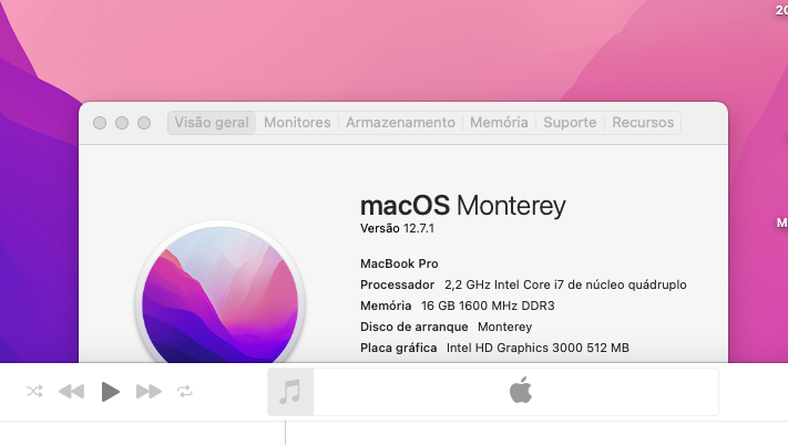

2011 Macbook Pro 15"
Works keyboard and lcd light brightness!!
Now the "fun".
This MBP don´t work hibernation in macOS or Manjaro.
The fun is, I repair another 2011 15" MBP and the pause/hibernation works 100%.
He have 8 GB 1333Mhz of Ram.
Could be 1333 vs 1600 Mhz the hibernation fail?
(The true is in my case I can hear the 3 beeps, after suspend).
Now the "fun".

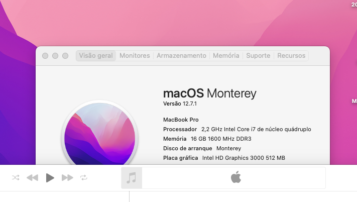

Now the "fun".
Update
I got one 8GB and one 4GB module 1333Mhz RAM, (so 12GB) and hibernation/pause WORKS! vs 16GB 1600Mhz!
I think my MPB do not like the 1600 Mhz, also, I think that he is running more cold.
My 5cents.
