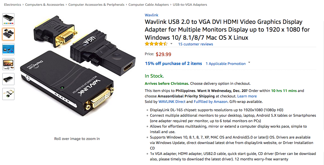

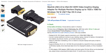

In particular, this USB to DVI/HDMI/VGA adapter.
The "HP USB Graphics adapter", or the Wavlink adapter?
Thanks!
Wavlink (I don't know why the screen shot did not upload when I first posted). At any rate, they use the same display link driver, which means they probably use the same display link OEM hardware.
So, just to be clear, you're macbook pro has the graphics card failure issue, and you're still able to use an external monitor using the wav link adapter?
