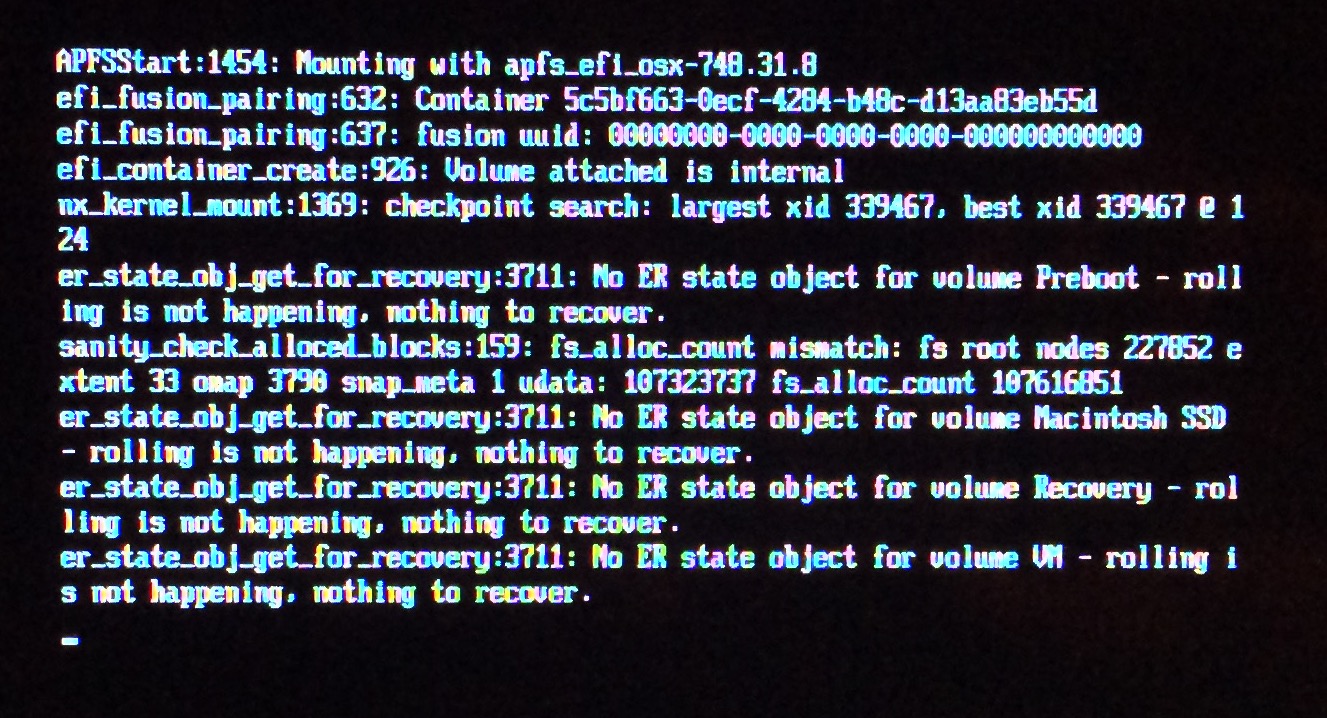

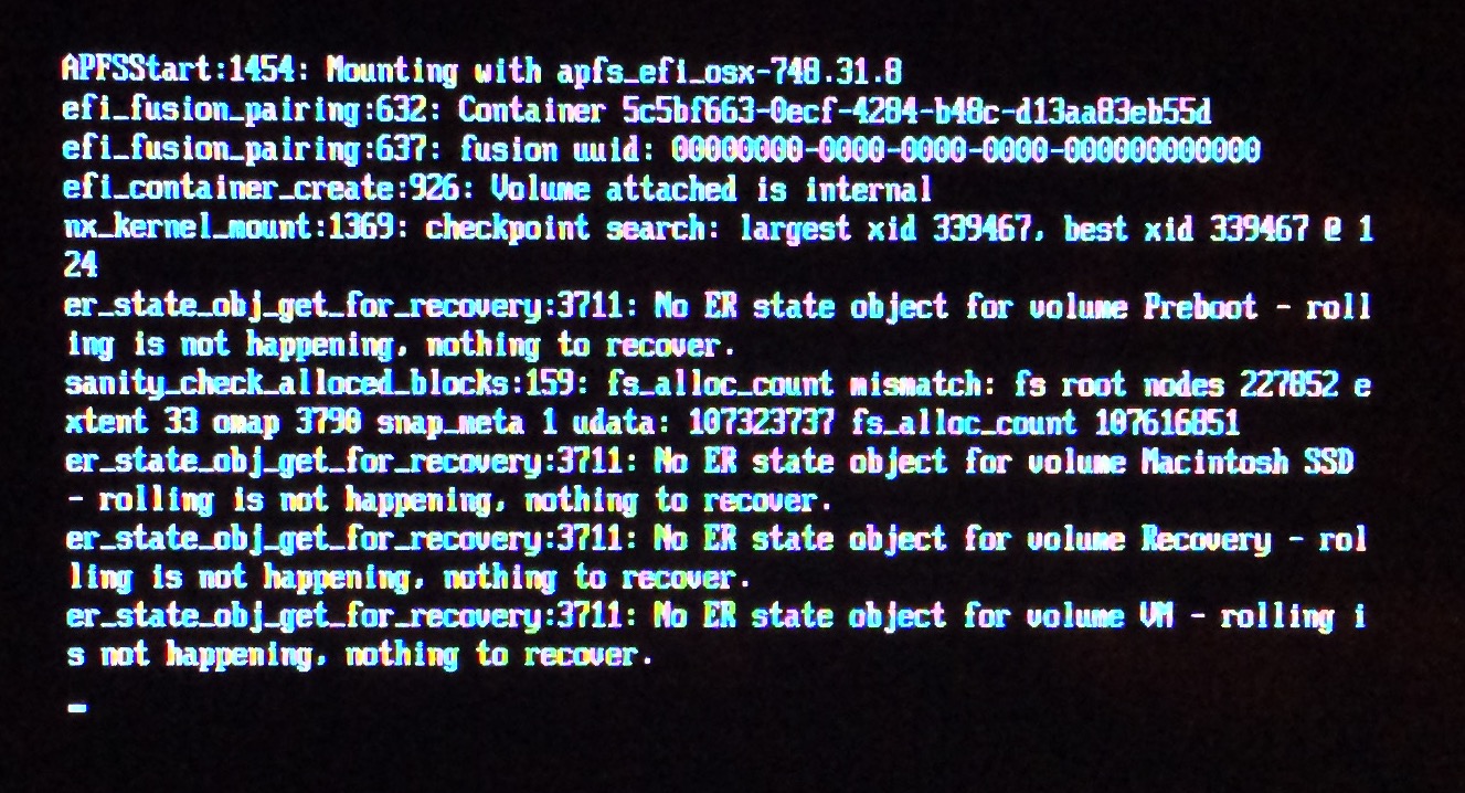

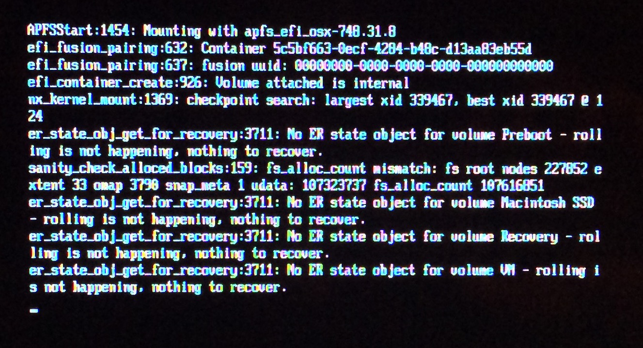

I can perfectly boot... but if I boot in verbose more this is the first thing I get:
I don't know if it's related though.

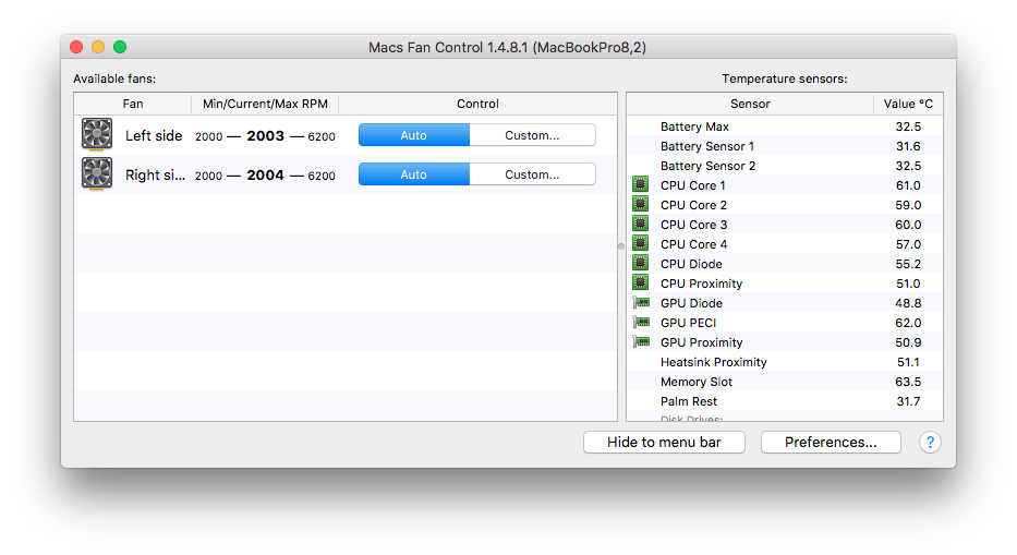

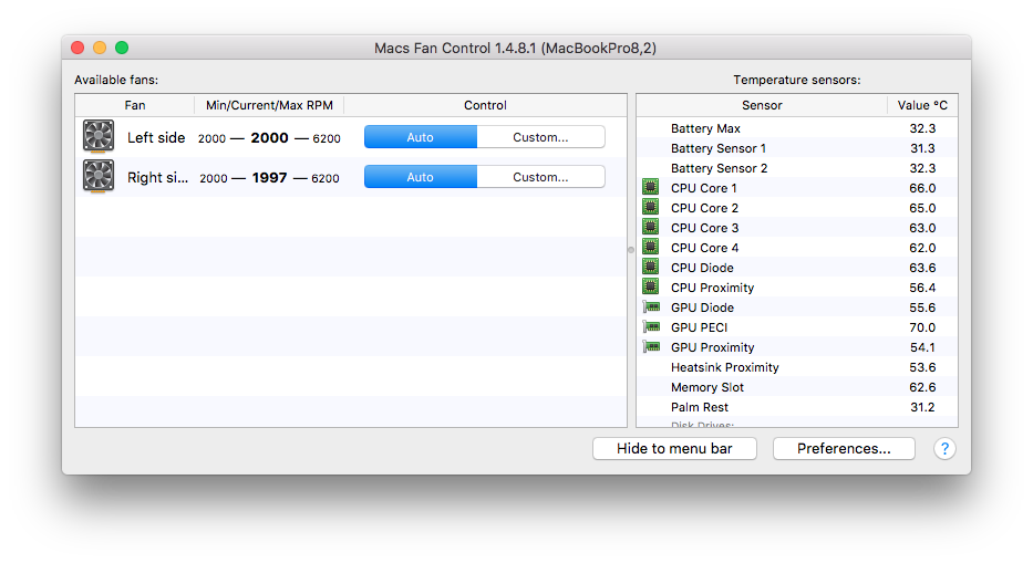

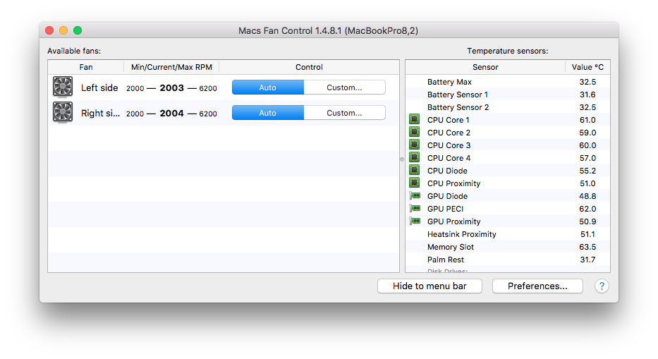

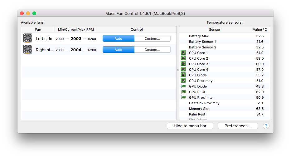

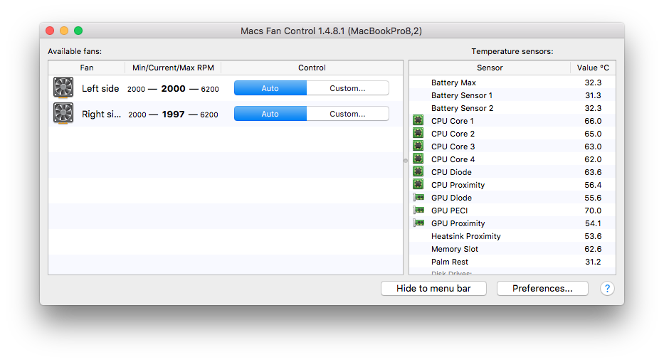

Regarding temps... I have smcFanControl for long...
I don't think those temps are low. I've had 50 or less before when I wasn't using the dGPU, and I don't know why the dGPU temp is so high. Any idea of how to fix it? Perhaps it isn't totally disconnected?
Another shot with a lower temp, but this is the lowest I've seen it lately.
It's rather interesting that the dGPU is hotter than the CPUs. HOW and WHY?

1 - The first picture is normal in boot verbose - line codes APFS.
2 - Your AMD GPU temperature is high because you do not kextload AMDRadeonX3000.kext after login - normal boot.
AMD6000Controller.kext - full power AMD GPU - increase temperature
AMDRadeonX3000.kext - decrease AMD GPU temperature - Intel GPU is primary GPU
Normal boot - without GRUB - only nvram fa4ce...:gnu-power-prefs=%01%00%00%00
/System/Library/Extensions - load on boot - necessary to decrease temperature
AMDLegacyFramebuffer.kext
AMDLegacySupport.kext
/DisableExtensions - kextload after login - necessary to power minimum AMD GPU temperature
AMDRadeonX3000.kext

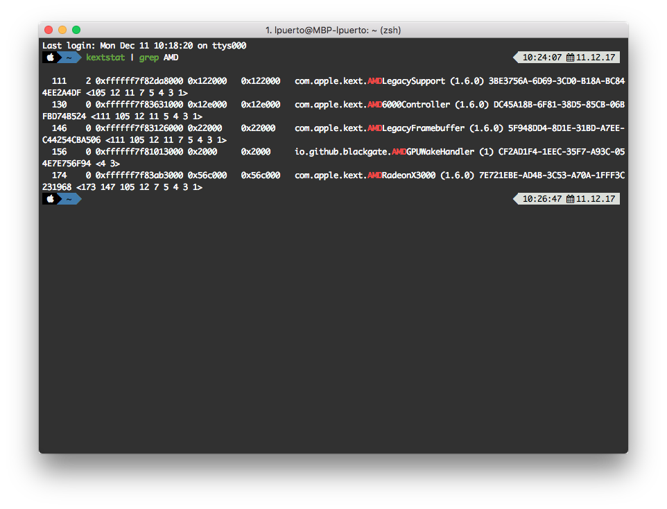

If I also load the AMDGPUWakeHandler I can even sleep and wake up normally.

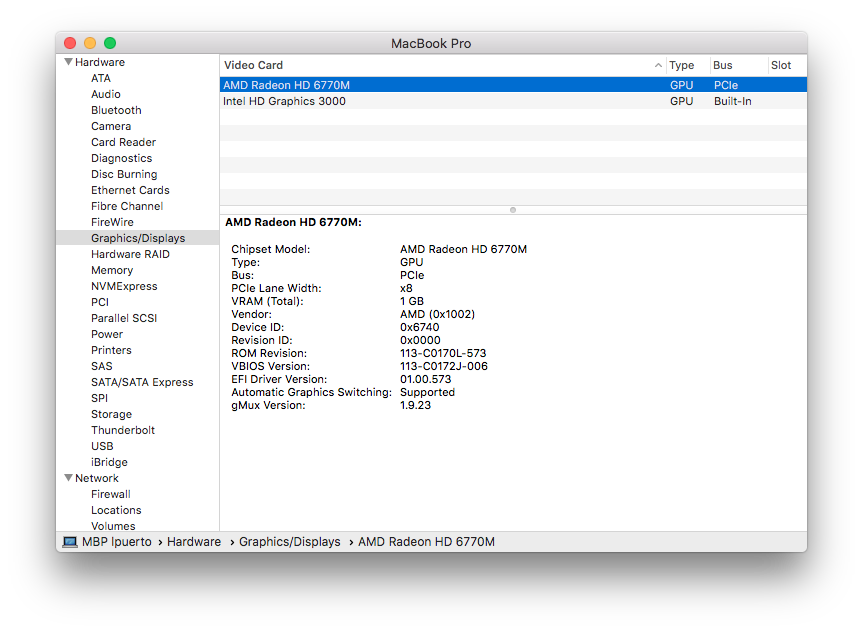

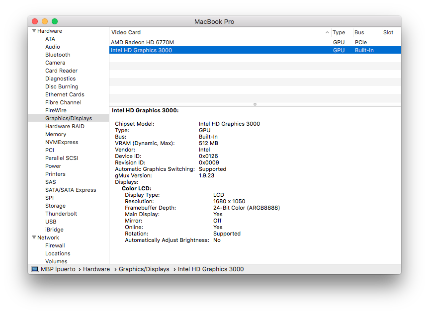

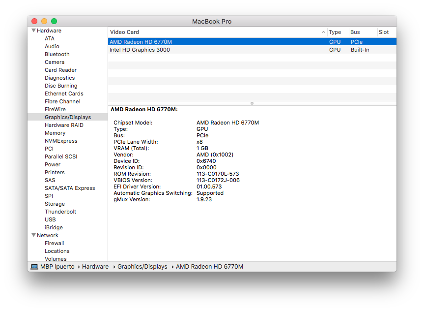

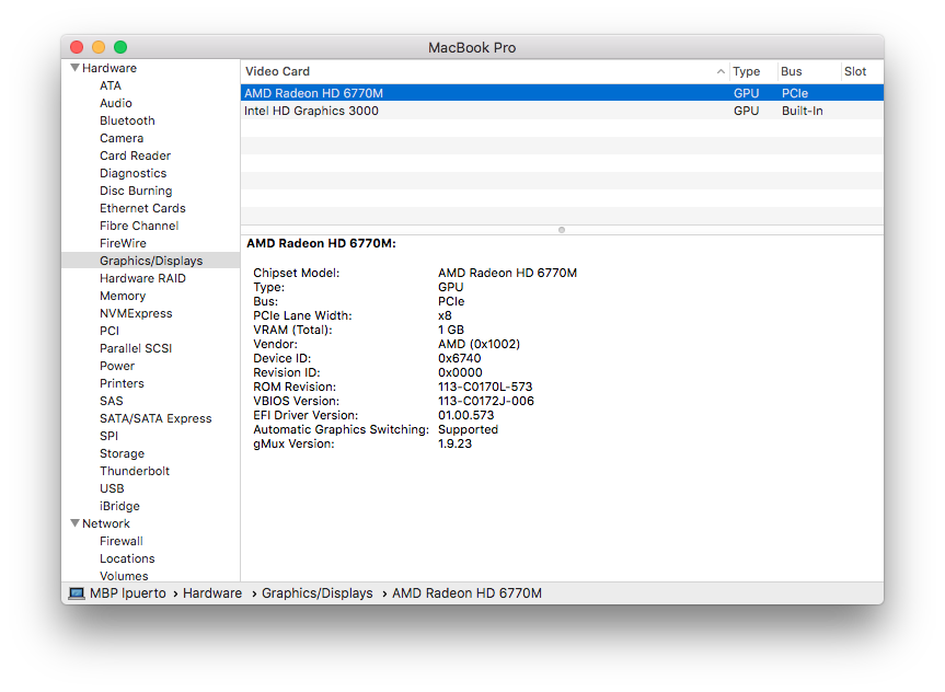

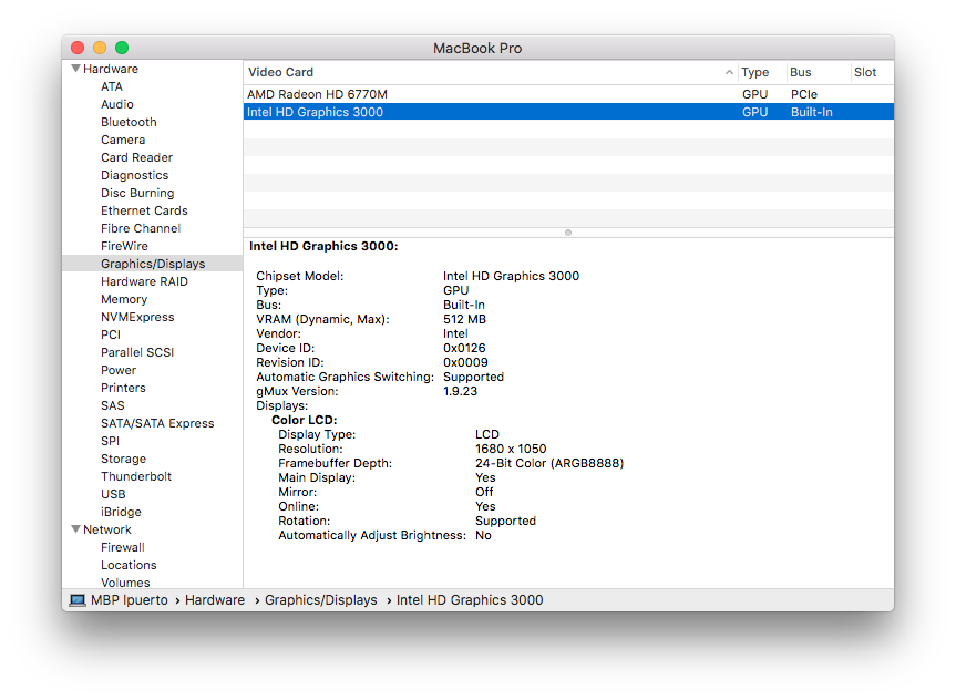

Another question... the AMD Radeon appears in the system report... is this correct? or there is something wrong?

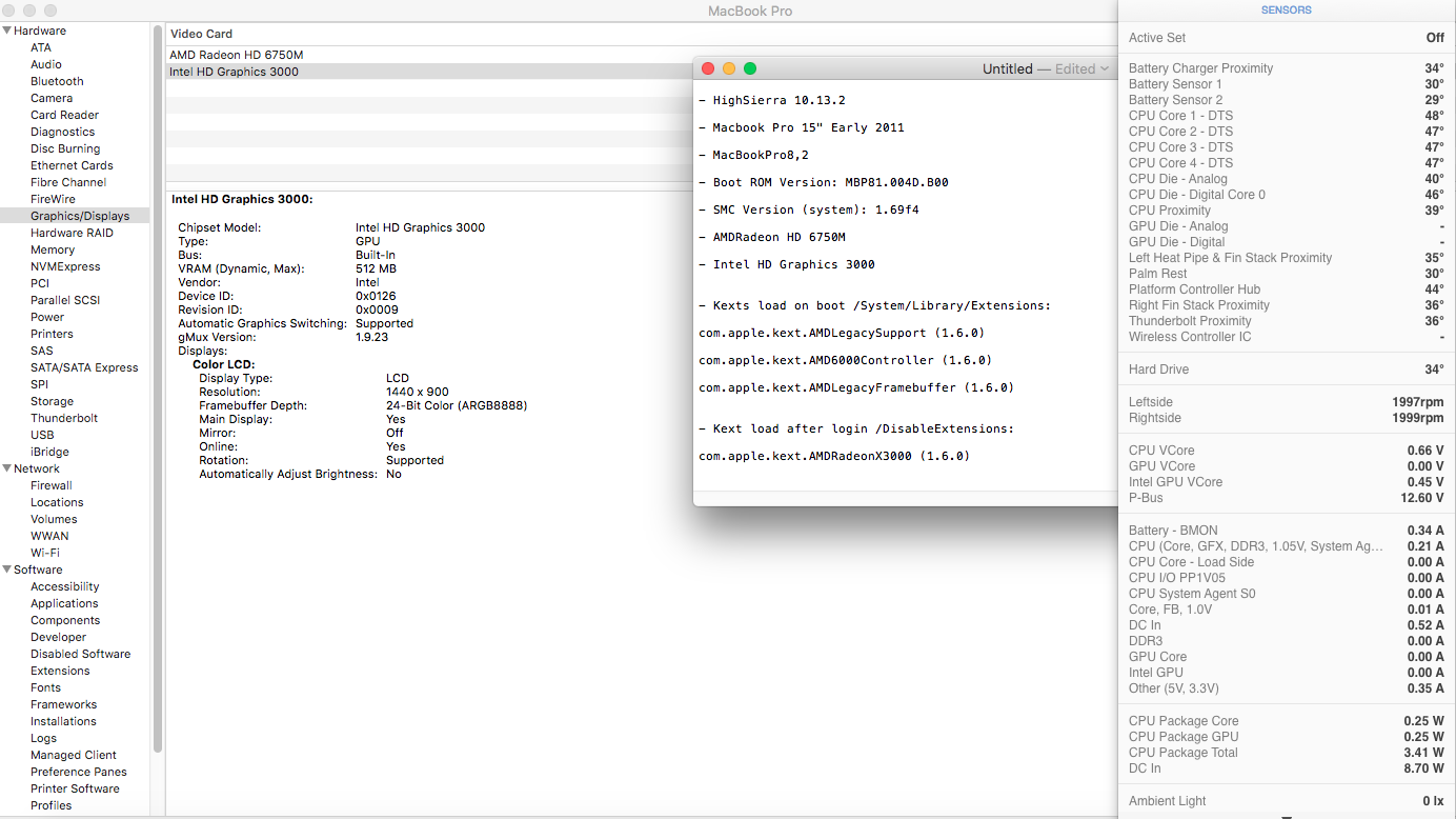

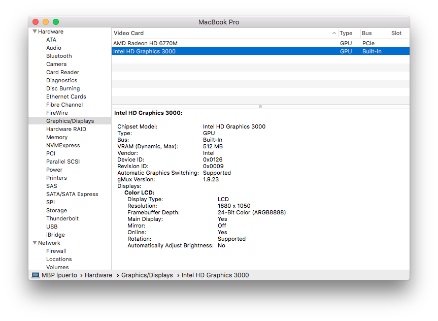

View attachment 741436 View attachment 741437

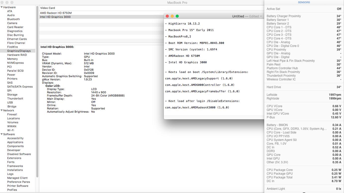

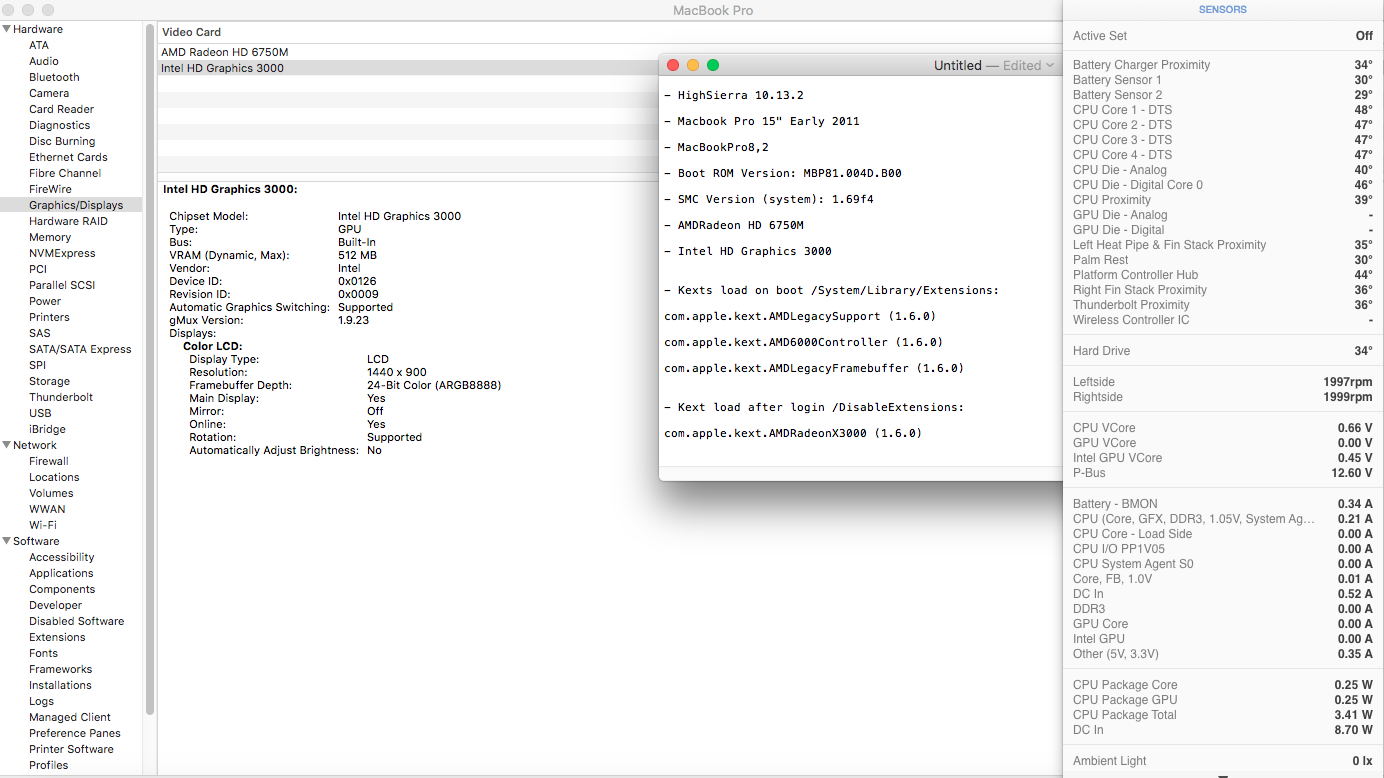

Boot with GRUB -> AMD GPU disappears from System Information.
Boot without GRUB -> AMD GPU appears in System Information.
The temperature of the Macbook Pro 15" Early 2011 during the boot (without GRUB) is about 65 to 70 degrees Celsius (CPU Die Analog) and 50 to 60 degrees Celsius (GPU Die Analog).
After login -> kextload AMDRadeonX3000.kext -> Only Active Monitor and Terminal open -> Leave in idle for 5 minutes without ScreenSaver -> the temperature drops to 38 to 40 degrees Celsius (CPU Die Analog) and zero (GPU Die Analog).

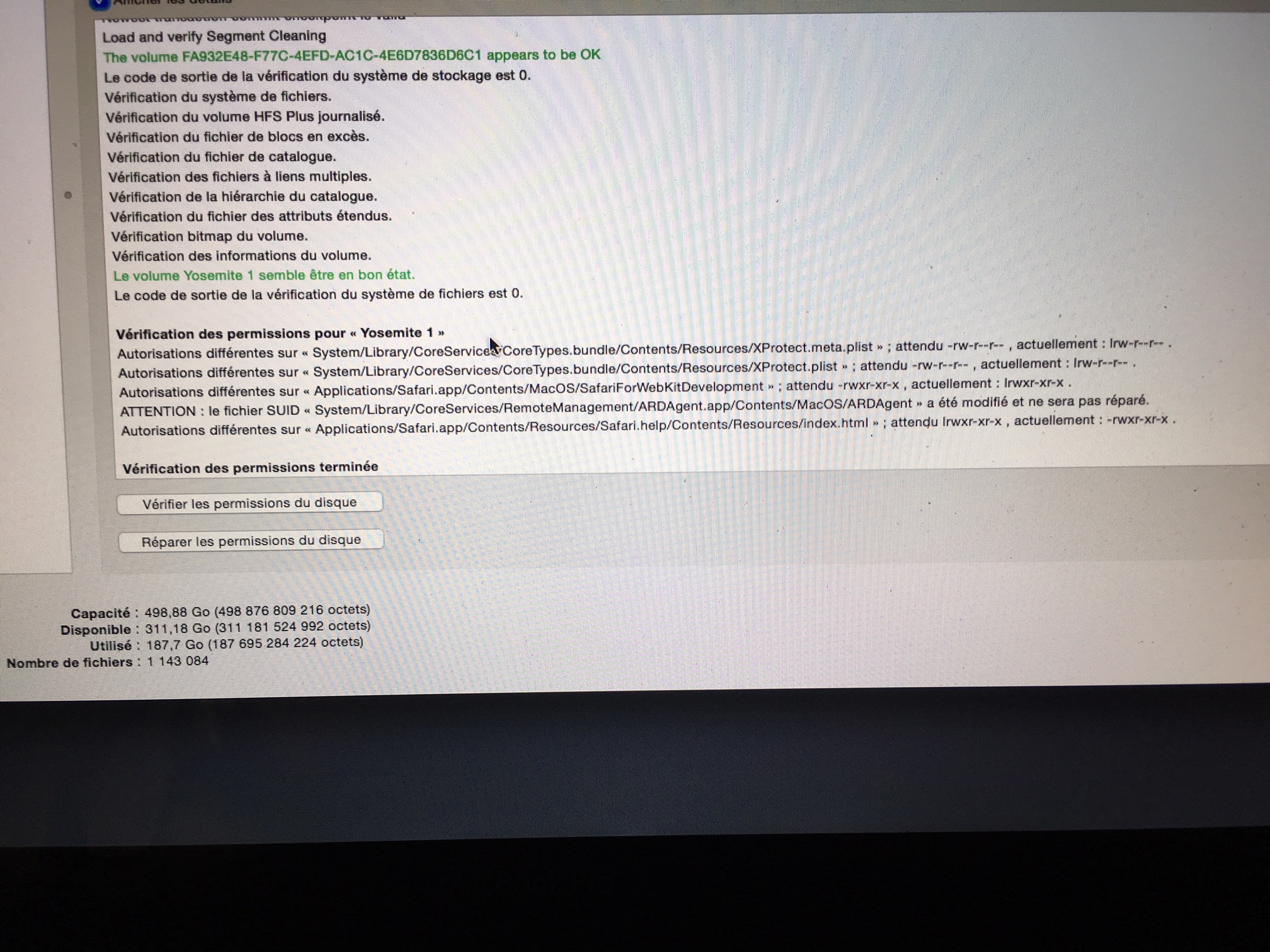

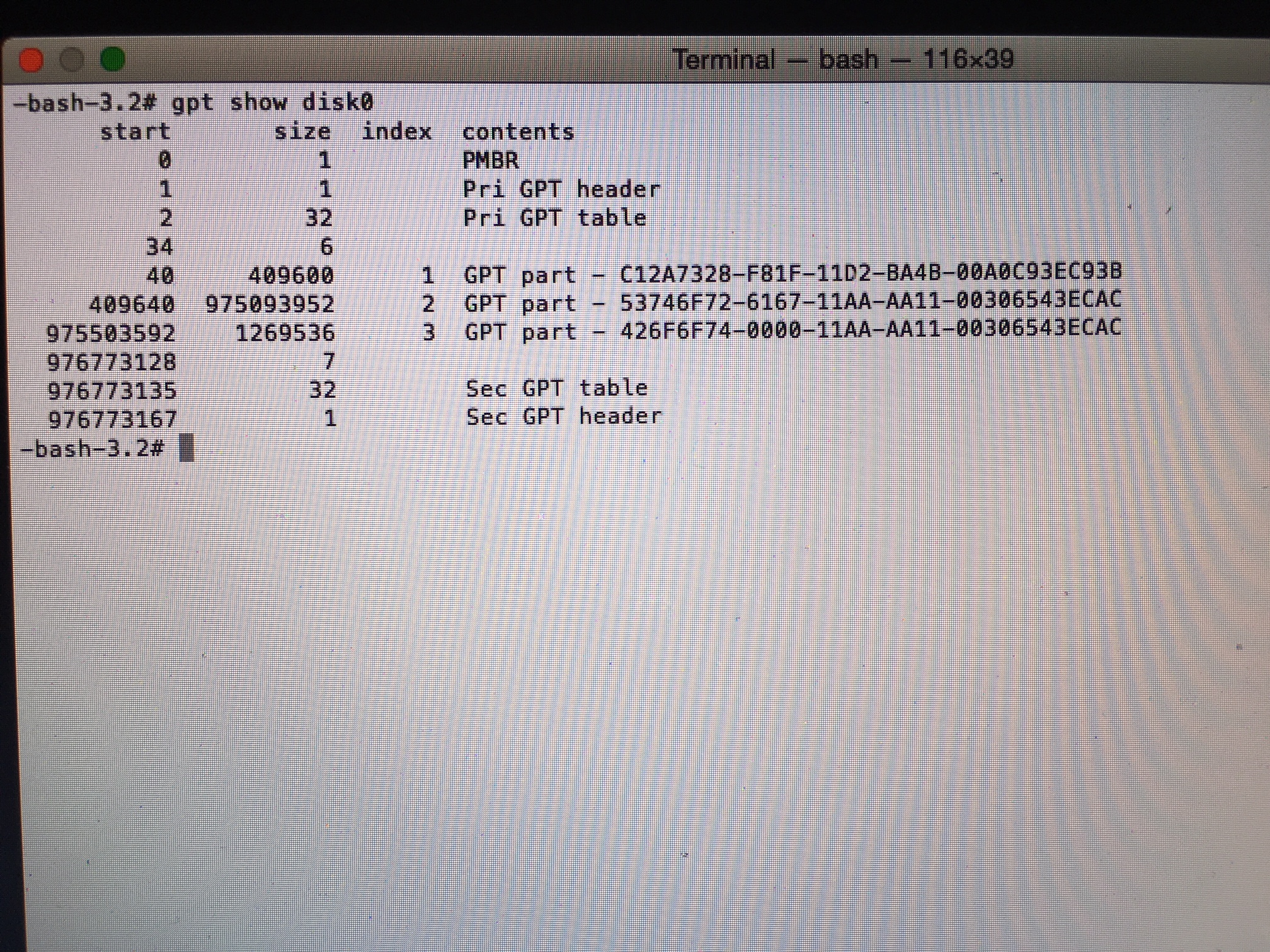

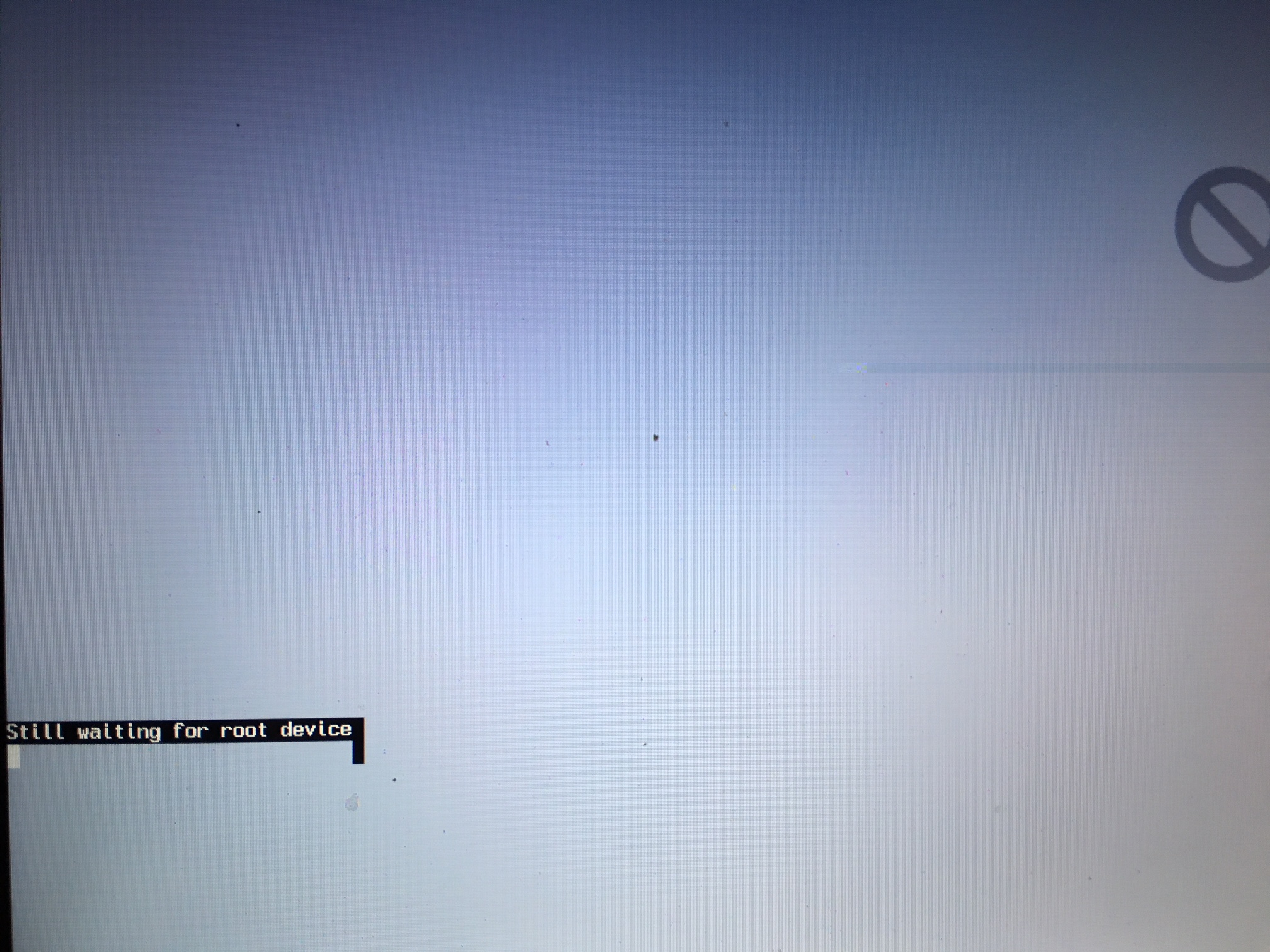

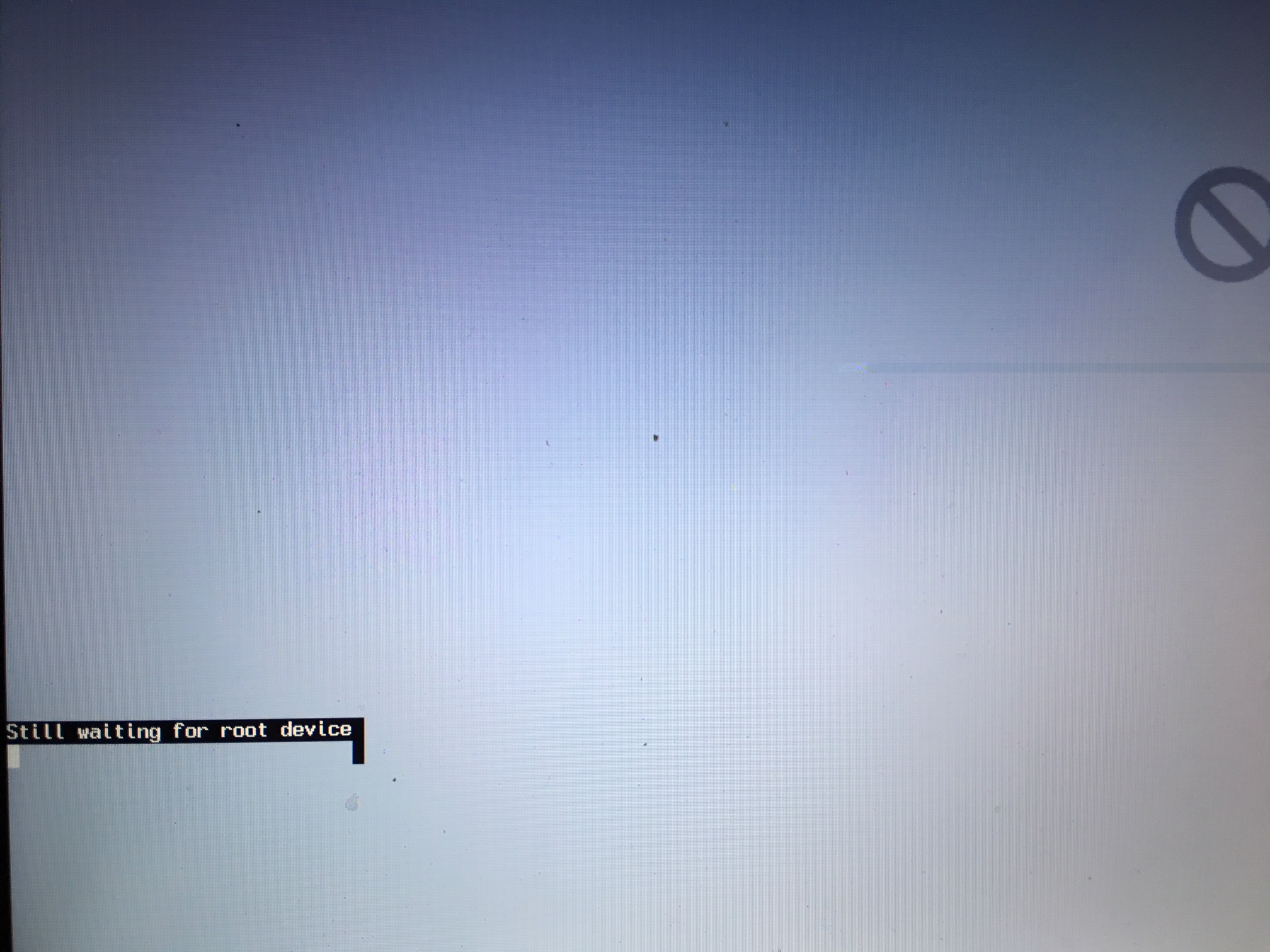

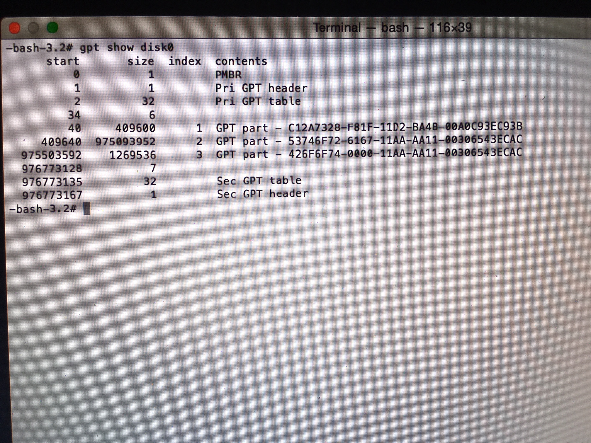

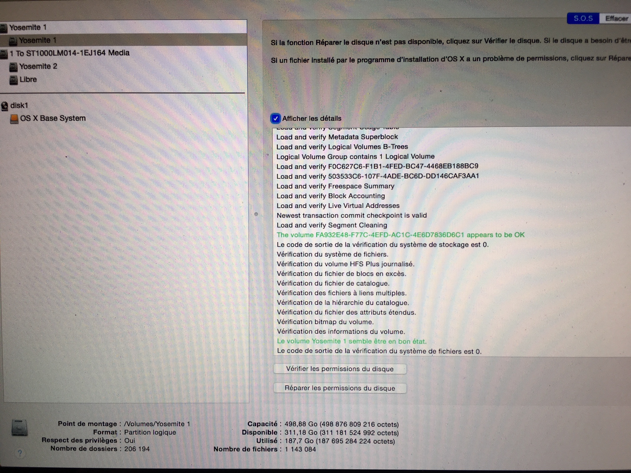

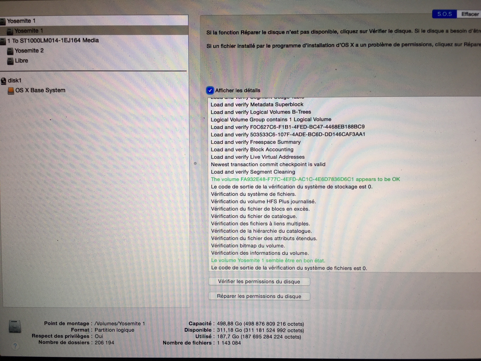

1 - Press Option key at boot -> show boot volumes -> select your HD / SSD with your Mac OS System.
If you can boot correctly -> System Preferences -> Start up Disk.
2 - If step 1 does not work, then boot the installation disk of your Mac OS (USB stick) -> after loading the graphical environment -> choose Disk Utility -> select the disk you want to repair - > First Aid.
3 - If you do not have the Mac OS installation disc, then try Recovery Mode (Command + R) -> Disk Utility -> select the disk you want to repair -> First Aid.
Remember:
You have the AMD GPU problem, so the Intel GPU has to be properly configured for gpu-power-prefs.
Otherwise, the Macbook Pro will freeze on the gray screen because of the AMD6000Controller.kext (installation disk or Recovery Mode).

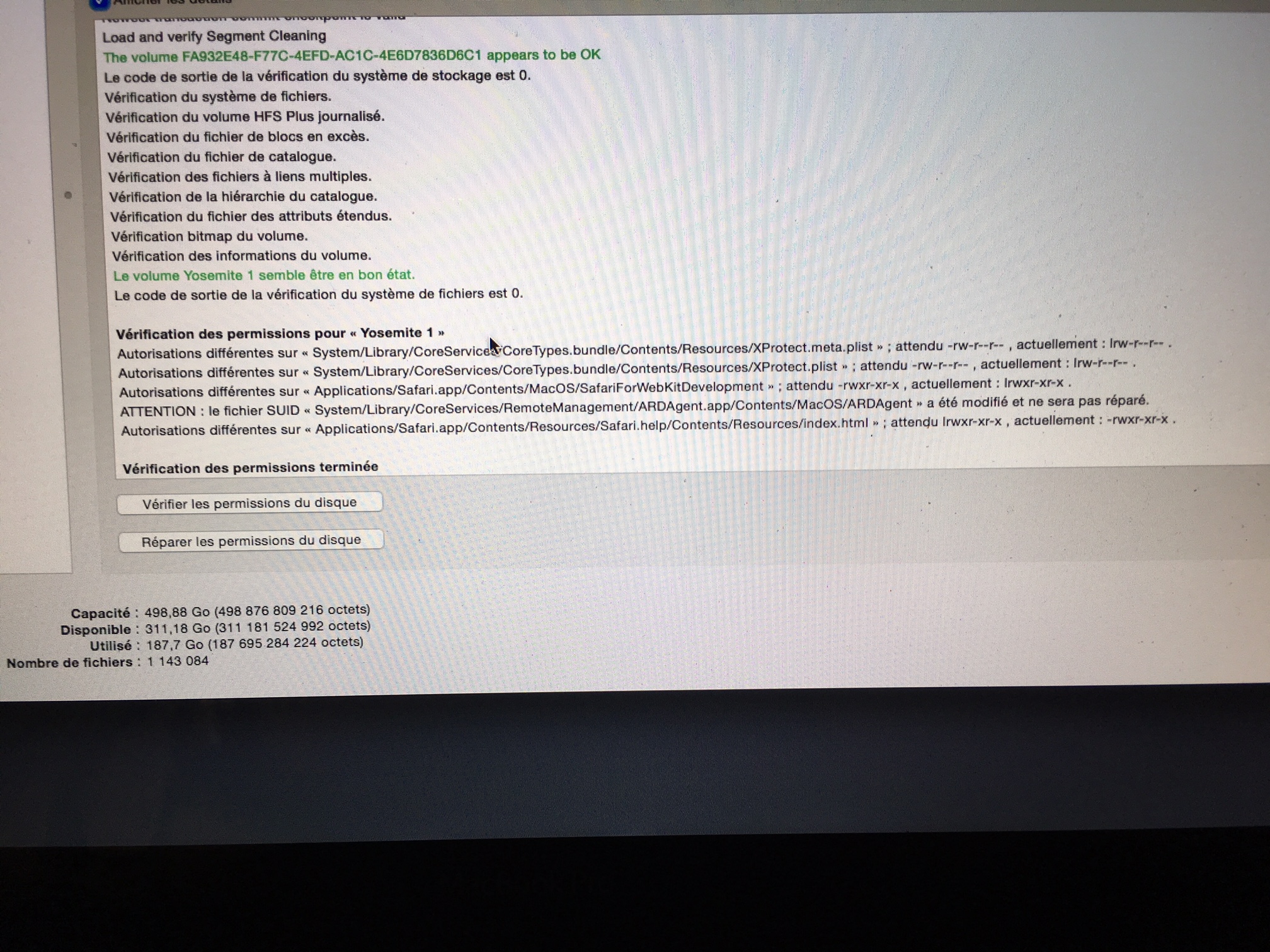

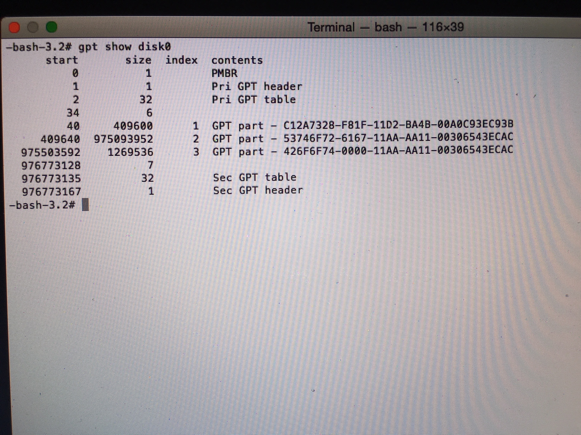

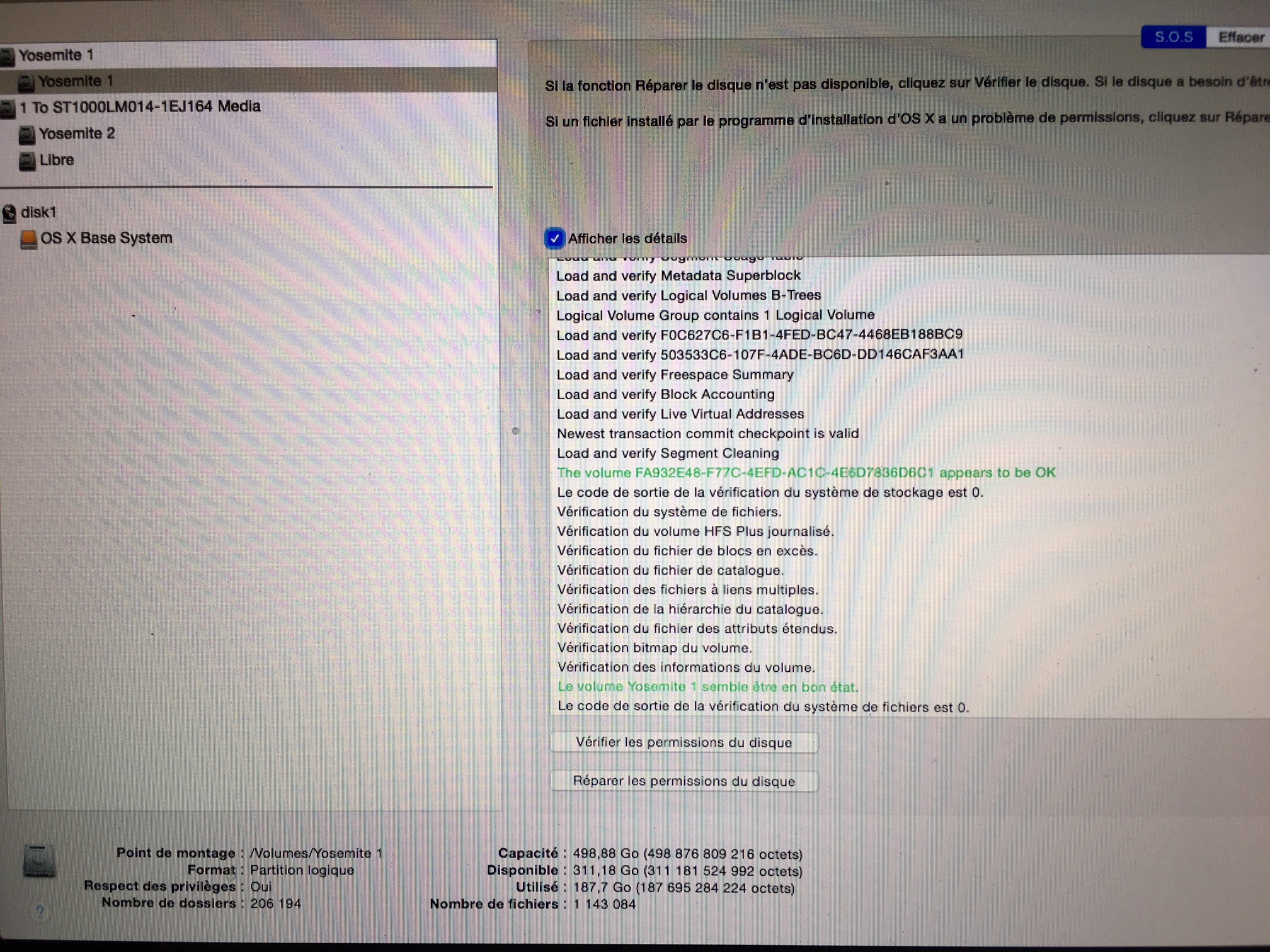

Thanks for your quick answer ...
Number 1 fails with the prohibited sign ... See pic.

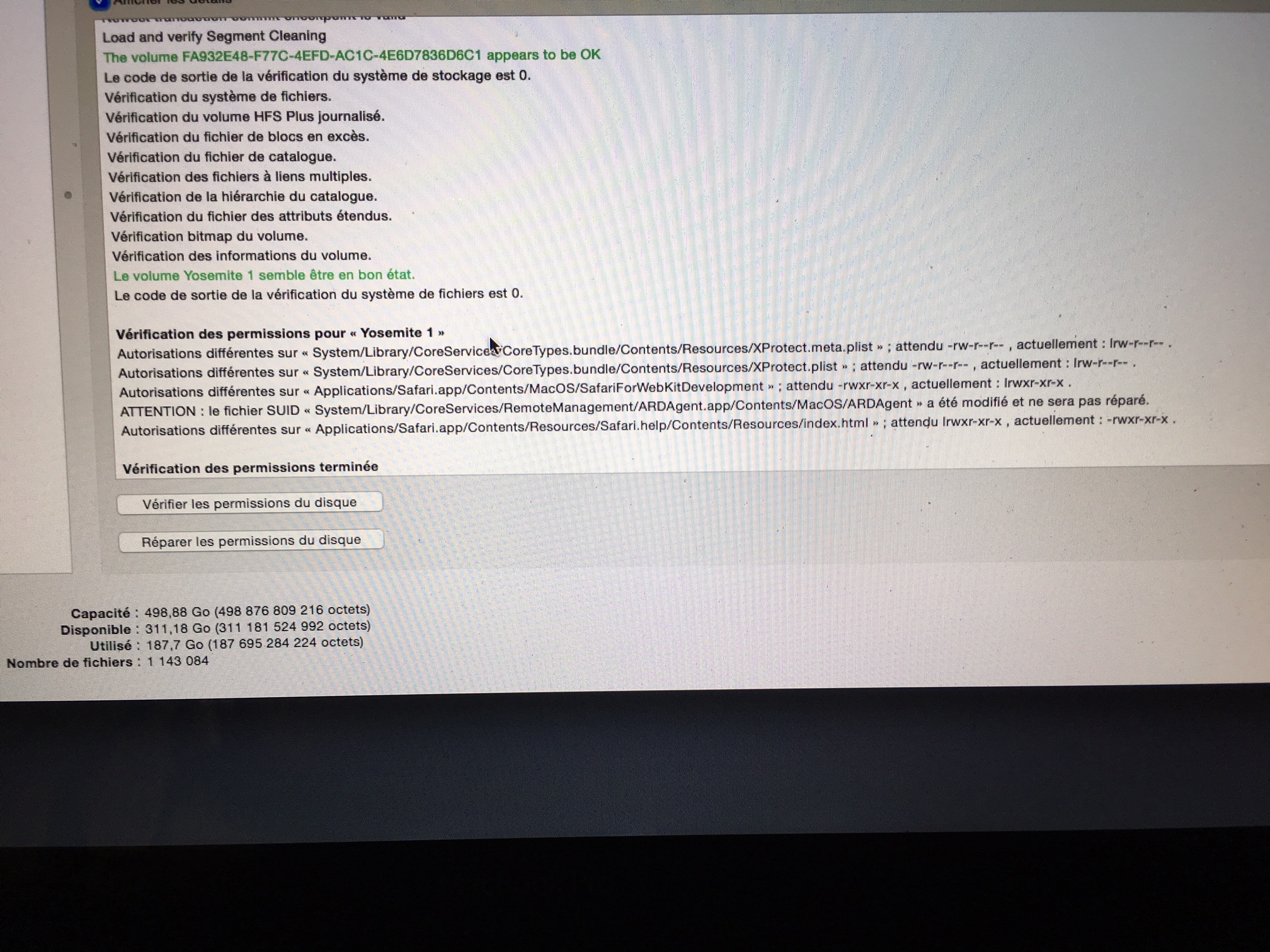

I went to number 3 and try the check and repair / disk and permissions .. Everything seem right there ... See pic.
I tried to check the GPT Table with the link you've provided. Does't look corrupted, ... but you may check. ... See pic.
I also tried ro reset SMC and PRAM with the startup keys ... As soon as I do that, at startup time the screen becomes blurry again and the mac won't boot (which I think is normal because if I understand correctly the gpu-power-prefs file is then removed).
I've then re-applied the procedure you've proposed (creating the gpu-power-prefs file) ... As soon as I reboot, I get the prohibited sign again... :-( ...
Any other idea ?
Any other idea ?
In your photo with the prohibited sign appears a progress bar below the signal. I think you did not put the boot verbose (mandatory to know what the error).
sudo nvram boot-args="-v"
It showed a "still waiting for root device" message.
If you were able to load Recovery Mode and make First Aid, then it probably would not be a problem on Flat Cable or the whole disk with a problem.
This may be a kext storage that is corrupted.
0 - Use Apple Hardware Test first (see if exist hardware problem):
Turn on your Mac, then immediately press and hold the D key on your keyboard. Keep holding the D key until you see the Apple Hardware Test icon.
https://support.apple.com/en-us/HT201257
Thanks a lot. My temps now are really normal and cold. Which I'm really pleased.
If this hack continue working I think the computer behaves much much better without the dGPU. The only thing I miss is be able to connect to a external monitor, which I've been doing extensively lately. But it's great this way too.

are you able to sleep normally in High Sierra? I have the wakeuphandle in place but it doesn't work and when I wake up I get the grey screen of death.
Hi again
I really need your help guys, new problems now..
My MBP was working well under 10.11 for a while with the EFI removal (more than 6 months). Yesterday I did some security updates (pretty sure it wasn't os x updates) then installed them and at reboot, the mac was stuck on a black screen. After another reboot, screen was completely distorted, had all the colors in stripes possible, couldn't see anything on the screen but i'm pretty sure nothing loaded. Same thing with several reboots, tried smc and nvram, nothing, sometimes the mac rebooted constantly with millions of chimes...
I managed to see cmd+s once, didn't have the time to try fsck and stuf, but now can't even access it. Same thing with option held, nothing, and recovery mode isn't working either... I don't know what happened, if the amd gpu came back or something. But I can't do anything right now. I'm trying to overheat the mac so that i can try to reboot with the intel gpu but it doesn't look like it will change anything.
If you guys have an idea for my issue, I'd be super grateful. Thanks!

one question... I've fixed the problem of hibernation... It was too many com.apple.PowerManagement.plist on /Library/Preferences, so I delete all and reconfigure.
However, I get the similar result when I sleep or then I hibernate. And it's quite funny.
If I sleep, I just get the grey screen of death on wake up.
If I hibernate, I see on screen how it reads the sleepimage as it should, but when the desktop comes, I just get a black screen.
I tried with and without the AMDGPUWakeHandler.kext in place and more or less it's the same.

AMDGPUWakeHandler.kext must be used with GRUB as kext developer's guidance.
"WARNING: This kext should only be used with the GRUB solution in place, otherwise it will kernel panic."
https://forums.macrumors.com/thread...-on-a-2011-macbook-pro-grub-solution.2087527/
I use Macbook Pro only as Desktop. I do not use Sleep or Hibernate.
You will have to do the tests with pmset and gpuswitch. Pages 37 and 43 of this thread.
#919 and #1066
You can see the settings in System Information -> Power -> System Power Settings.
