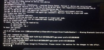

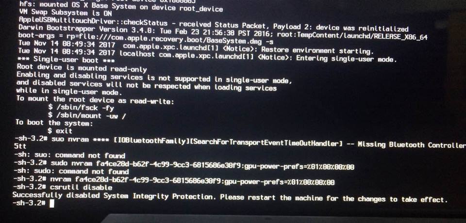

I already tried the Single User Recovery Mode (Cmd+S+R) and entered csrutil disable with the following result:
csrutil: command not found
EDIT:
Seems like nsgr spotted the issue: You're still in Yosemite which does not have SIP.

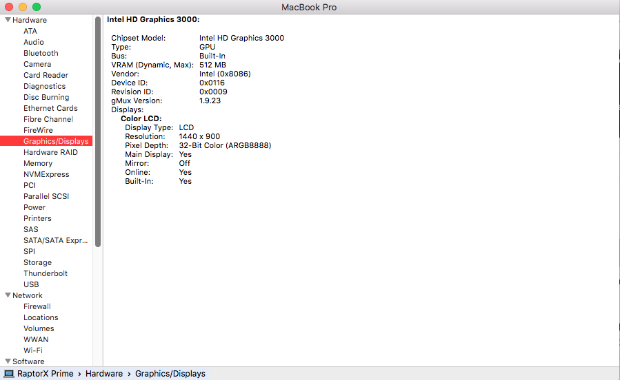

Thanks tutorial, I fix my macbook pro 8,2 2011. I like how to use external monitor using intel integrated?
here is this post: https://forums.macrumors.com/thread...fi-variable-fix.2037591/page-10#post-24733694

So, I might seem new here but I've been following this thread for a while now, I first used the "original fix" and I later updated to the grub method, but I have a huge problem since I want to actually have a windows partition. I tried with the "old" efi method but installing windows was impossible and using another computer to install windows with on a drive and booting off of it works one or two times and then never works again, with grub its the same. I can't even see the drive using the command "ls -l" on grub. Is there a fix or has someone got windows to boot (btw 10 and 8 do this and 7 doesn't even get this far).
As with the above person, I'm new on here, but I have attempted to fix my 15" early 2011 MBP using a YouTube video using these instructions:
1 - Enter Recovery Mode (text mode)
Command + R + S
2 - Disable SIP (SIP lock System folder -> no move kexts to another folder). SIP (csrutil) only enable / disable on Recovery Mode.
csrutil disable
3 - Restart the system
reboot

14 - Before enabling SIP again, try the normal boot without pressing any key. The Mac OS will rebuild the kernel cache and restart. See if the system starts normally.
15 - Enable SIP again (restart the system)
16 - Enter Recovery Mode (text mode)
Command + R + S
17 - Enable SIP again
csrutil enable
18 - Restart the system
reboot
19 - Enter Recovery Mode
Command + R + S
18 - type this in to clear GPU
nvram fa4ce28d-b62f-4c99-9cc3-6815686e30f9:gpu-power-prefs=%01%00%00%00
20 - Restart the system
shutdown -r now

sudo nano /force-iGPU-boot.sh
– Enter the following content to this file:
#/bin/sh
sudo nvram boot-args="-v"
sudo nvram fa4ce28d-b62f-4c99-9cc3-6815686e30f9:gpu-power-prefs=%01%00%00%00
exit 0
– Now make that executable:
sudo chmod a+x /force-iGPU-boot.sh
In the future, when the SMC/PRAM/NVRAM gets reset to default values it is now possible to boot into SingleUser with:
<Cmd>+<s>
– And after mounting your boot-volume read-write to execute just:
sh /force-iGPU-boot.sh
