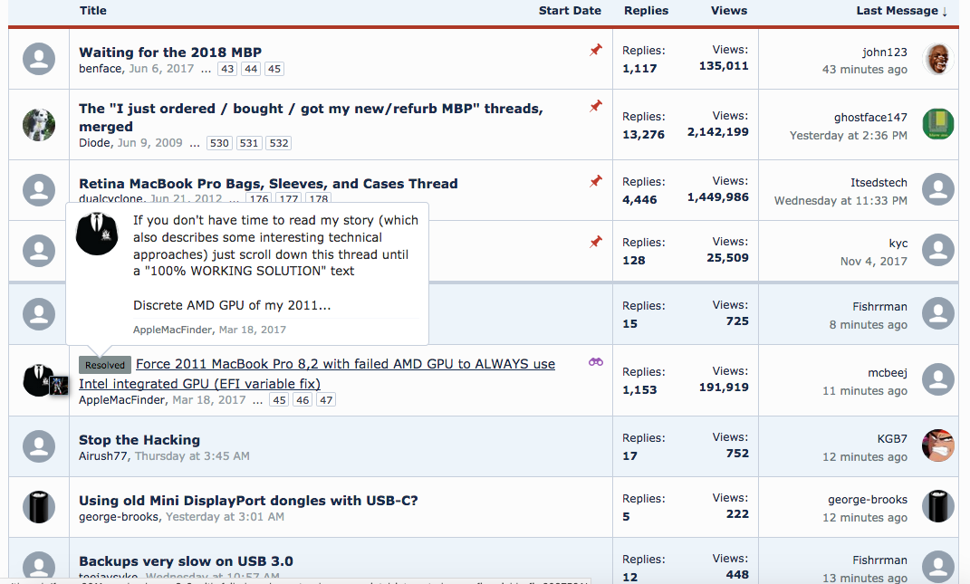

They can be pinned on the Forum section/list and can be highlighted. We have at least two working solutions. It's becoming a bit difficult to follow which is which on the same thread, like I mentioned earlier, with now more than 46 pages and 50 replies per page.
Again this is just a suggestion, just so that brainshutdown's solution can easily be found by others (I've already found it, and my only concern right now is weeding through between his solution and AMF's.

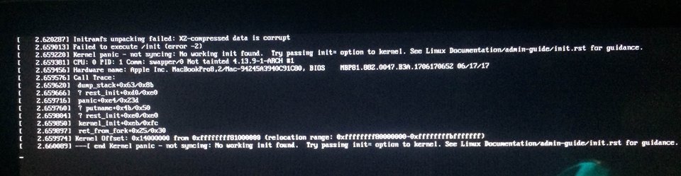

when I tried booting from it, I got this error message:
Now, with the little coding I know, I'm guessing that the ArchLinux version I've downloaded is corrupt and thus could be unpacked. I'm currently downloading an older version, to see if that works, but, maybe you guys can help me figure out what went wrong here, in case I'm wrong with my assumption
Maybe a file got corrupt while downloading, but in any case its probably a good idea to use the same version of Arch Linux that I have used - for guaranteed results (some newer Arch Linux version had a UEFI vars related bug, and I am unsure if they have fixed it before releasing the latest available version)
