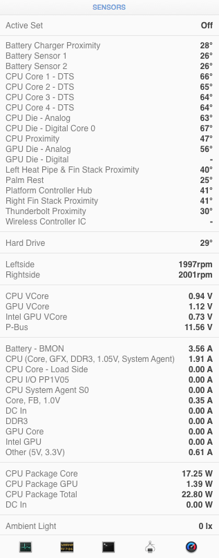

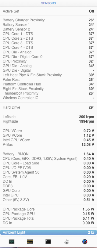

That's odd. The temperatures in mine are ok. Here are my temps after waking up from sleep:
Idle for 5 minutes:
Watching a 1080p 60fps video on youtube for 5 minutes:
idle...
after waking from sleep,
It looks like the dGPU has warmed up again.

Not a problem if the EFI partition is on the SSD.
idle...
That happens with mine too, but the temperatures are ok, nothing to worry about.
