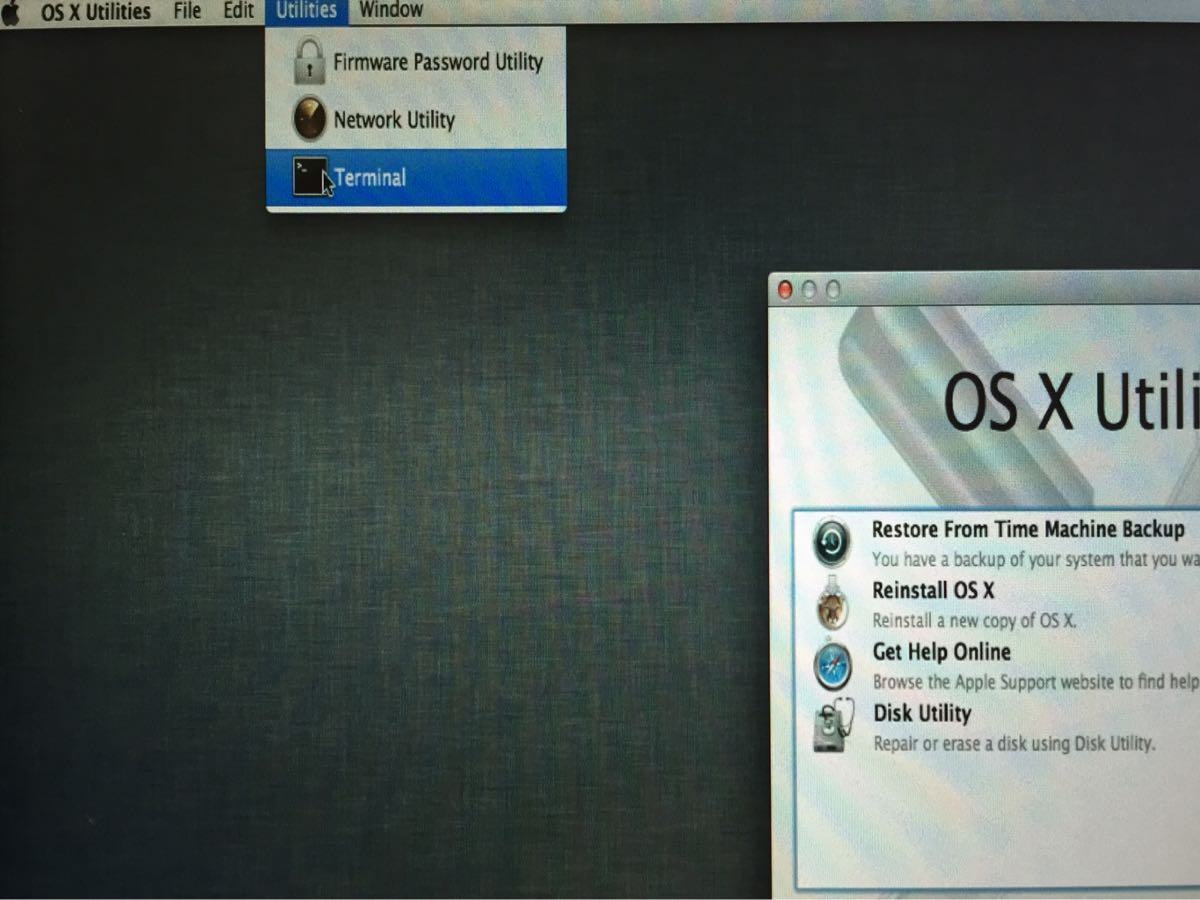

... You have to move the AMDRadeonX3000.kext that is inside the /System/Library/Extensions directory. ...
I've tried that after multiple readings of the above. I know I also read somewhere the solution to the 'Operation not permitted' error.
I tried working with the crsutils file on the recovery partition - but it isn't there.
Can you stand another go at finding my way through this ?
My next trick is to try the actions via the now sluggingly working but totally readable desktop rather than via terminal. I have tried that in the past also, but, I have reset, reuploaded and rechecked so much that there is a chance it will get me yet another small step forward. I am a patient man.
You did not say which version of Mac OS you are using. Before you said that you had the High Sierra Beta and then you said that you would install Mountain Lion.
System Integrity Protection (SIP) is only available on El Capitan, Sierra and High Sierra - csrutil command.
If you are using Mountain Lion, then there is no SIP - csrutil command.
But guess what? Some people upgraded (no fresh/clean install) from an older version (Mountain Lion) to a newer version (High Sierra), and the system was updated but the Recovery Mode partition continued with the old system (Mountain Lion).
Consequence: When you boot from Recovery Mode, you then load a Mountain Lion system that does not have the csrutil command.
https://forums.macrumors.com/threads/disable-sip-command-not-found.1961216/
When you boot through Recovery Mode, then which icon appears in the Reinstall OS X option?
If it is the icon of Mountain Lion, then you need to do a fresh / clean installation through a USB stick to update all partitions (system and Recovery).
Or try an installation on the Internet and see if the High Sierra icon appears in the Reinstall OS X option.
Option-Command-R or Shift-Option-Command-R at startup.
https://support.apple.com/en-us/HT201314
Mountain Lion icon:
https://forums.macrumors.com/attachments/image-jpeg.621183/
High Sierra icon:
https://support.apple.com/library/c...macos-high-sierra-recovery-mode-reinstall.jpg
Move AMDRadeonX3000.kext with boot Recovery Mode - You do not need to disable SIP - csrutil disable:
You can move AMDRadeonX3000.kext through Recovery Mode. If you are using the APFS file system, then Mountain Lion Recovery Mode may not work.
If the system partition is Mac OS Extended, then the driver for this file system automatically loads itself.
1 - Boot Recovery Mode (Command + R at boot).
2 - After show graphical screen, choose Disk Utility.
3 - See if your System Partition is mounted (mount point). And see the name of System Partition.
Example: label Macintosh HD or MacOS.
If the system partition is not mounted, then click on the partition name and then click Mount.
If your system partition is encrypted (FileVault), then this partition is not mounted automatically because you need to enter the partition password.
4 - Close Disk Utility, click menu Utilities Terminal.
