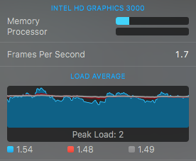

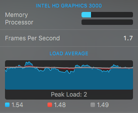

I have 2 resurrected 2011 15" mbp.
One with El capitan (left, 8gb RAM) and other with Yosemite (right, 4 gb ram)
No one have ssd (both have the dark-boot mode)
Take a look:

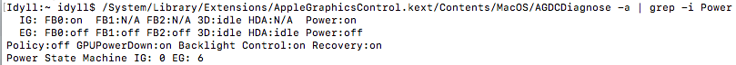

– disable dGPU on boot
nvram fa4ce28d-b62f-4c99-9cc3-6815686e30f9:gpu-power-prefs=%01%00%00%00

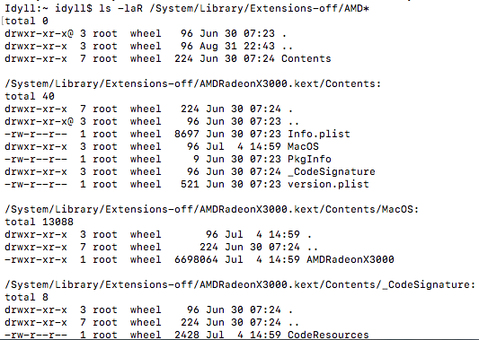

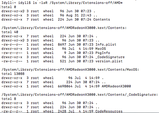

– make a kext-backup directory
mkdir -p /System/Library/Extensions-off
– only move ONE offending kext out of the way:
mv /System/Library/Extensions/AMDRadeonX3000.kext /System/Library/Extensions-off/
– let the system update its kextcache:
touch /System/Library/Extensions/
– wait for the kextcache process to finish
then
reboot
Reboot normally:
you will have an accelerated iGPU display.
But the system doesn't know how to power-management the failed AMD-chip.

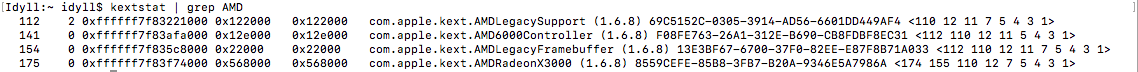

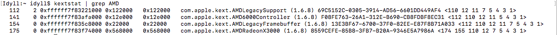

For that you have to either manaully load the kext after boot by:
sudo kextload /System/Library/Extensions-off/AMDRadeonX3000.kext

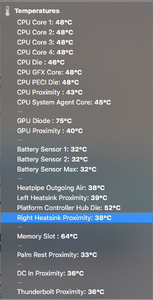

Further: this laptop is overheating, no matter what you do. The cooling system is inadequate and the huge number of failing AMD chips are just proof of that.
To prolong the life of this now hacked machine it is advisable to abstain from really heavy lifting over prolonged stretches of time. Strictly follow the usual recommendations for laptops: use on hard surfaces, keep the fans and fins inside it clean. Using any fancontrol software with relatively aggressive settings should also help: like smcFanControl, MacsFanControl, or TGPro (the latter both commercial).

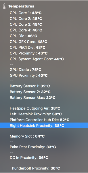

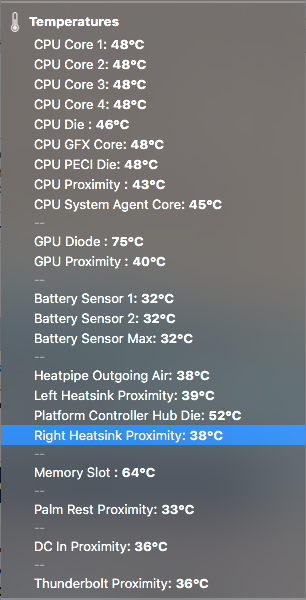

My GPU failed 2 days earlier, and I am Lucky even to have the working guide. I now have successfully disabled AMD, by nvram setting>moving AMD*3000 to extensions-off(following MikeyN guide). I have one problem, the GPU Diode temperature hovers around 72-85 degree Celsius. My machine boots fine(now after disabling AMD), but I am little conscious about the GPU diode temperature.
I also have done the loginhook part and AMD*3000.kext is loaded after booting. Here are the screen shots:
1. My GPU diode temperature at near idle 72 degree Celsius.
2. Verification of loaded kexts
Is that temperature normal?, or Should I worry, and do something to Reduce that Temp??
What is weird to me is that GPU diode is in about 75 degrees but GPU proximity is in about 43 degrees. Isn't it weird? Also, The sensor freaked out at one time and was showing N/A for GPU diode and after a while it came back with reading of 75 again. What is happening, is the sensor thing bad or something?
One thing to note, is that, though GPU diode shows high temps, the machine is running a lot cooler than before. That is why I think there is the problem in system sensor itself. OR is it? I am confused.
Also Is Peak Load and Memory/Processor usage for Intel HD 3000 normal??(screenshot attached)
I am on latest High Sierra Version 13.6, And My Machine is Late 2011 15" MacBook Pro.
nsgr
macrumors 6502
May 22, 2017
317
117
View attachment 779176 View attachment 779178 View attachment 779184

EG : FB0: off FB1: off FB2: off 3D: idle HDA: idle Power: off

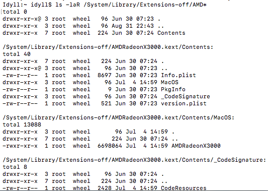

Make sure your AMDRadeonX3000.kext of your LoginHook has a complete AMDRadeonX3000.kext.
Apple has put some updates with incomplete AMDRadeonX3000.kext without the Info.plist file.
This file is essential for the proper functioning of AMDRadeonX3000.kext.
It is good to have a backup of the complete AMDRadeonX3000.kext.
In this example the AMDRadeonX3000.kext is inside the /DisableExtensions directory.
Code:
ls -laR /DisableExtensions/AMDRadeonX3000.kext/
total 0
drwxr-xr-x@  3 root  wheel    96 Jun 29 22:38 .
drwxr-xr-x  33 root  wheel  1056 Aug 24 22:07 ..
drwxr-xr-x   7 root  wheel   224 Jun 29 22:39 Contents
/DisableExtensions/AMDRadeonX3000.kext//Contents:
total 40
drwxr-xr-x  7 root  wheel   224 Jun 29 22:39 .
drwxr-xr-x@ 3 root  wheel    96 Jun 29 22:38 ..
-rw-r--r--  1 root  wheel  8697 Jun 29 22:38 Info.plist
drwxr-xr-x  3 root  wheel    96 Jul  4 06:14 MacOS
-rw-r--r--  1 root  wheel     9 Jun 29 22:38 PkgInfo
drwxr-xr-x  3 root  wheel    96 Jun 29 22:39 _CodeSignature
-rw-r--r--  1 root  wheel   521 Jun 29 22:38 version.plist
/DisableExtensions/AMDRadeonX3000.kext//Contents/MacOS:
total 13088
drwxr-xr-x  3 root  wheel       96 Jul  4 06:14 .
drwxr-xr-x  7 root  wheel      224 Jun 29 22:39 ..
-rwxr-xr-x  1 root  wheel  6698064 Jul  4 06:14 AMDRadeonX3000
/DisableExtensions/AMDRadeonX3000.kext//Contents/_CodeSignature:
total 8
drwxr-xr-x  3 root  wheel    96 Jun 29 22:39 .
-rw-r--r--  1 root  wheel  2428 Jul  4 06:14 CodeResources

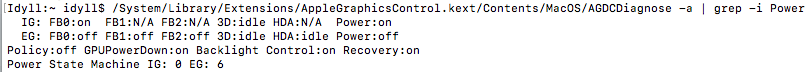

Hello, thanks for your reply,
When I checked using the command, the only difference between your result and mine was in the third line:
Yours is Policy: on and Mine is Policy: off, Is this the Issue?
Besides that, my version of loaded AMD*3000.kext has Info.plist, in fact I verified all the contents. If you find any difference, here is the result of second command:

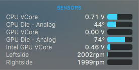

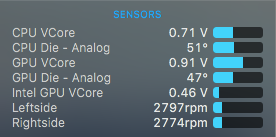

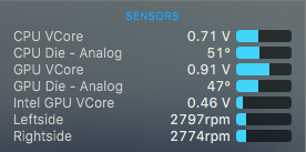

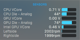

Also, when I keep the Machine Idle, the GPU diode temperature hovers in 68-79 degree Celsius with Kext Loaded.
One Important Fact: When I keep The AMDRadeonX3000.kext Unloaded, the GPU Diode Automatically drops to 30-50 degree Celsius, of course the AMD Vcore is taking up power/Voltage. But When I load AMDRadeonX3000.kext, the AMD GPU Vcore is not taking power/Voltage but temperature goes high around 70-90 degree Celsius. Here is my screen shot: (see Vcore to confirm)
AMD*3000.kext not loaded: AMD*3000.kext Loaded:
Why is this so? When kext is loaded, temps go up, but when kext is unloaded, temps go down? Why?
So, Isn't it better to leave AMDRadeonX3000.kext unloaded if I want my GPU Die temps to remain under 50s degree Celsius? What do you suggest?
View attachment 779358 View attachment 779359
And I always use Safari. Infact, I have clean installed the OS, so not much messing around.
1 - What software are you using to measure the temperature?
2 - What is the result of the Terminal?
Code:
nvram -p
I'm testing the agdc=2 option on boot-args. Only in Recovery Mode - SIP is enable.
I think that's why Policy=on was enabled.
Code:
nvram boot-args="-v agdc=2"
In this post I only had the boot-args="-v" and the result was Policy=off. #1790

Thank you for your reply.
I did what you said:
>reset smc (orange changed to green) >reset nvram(pressed keys until booted second time) > set nvram .......... gpu-power-prefs=%01%00%00%00 > reboot in verbose > load AMDRadeonX3000.kext
I did not set 'agc' or 'agdc' values this time.
Before loading the kext: GPU Die Temperature= 45 degree celsius.
After Loading the kext: GPU Die Temperature=68 degree celsius.
After Waiting 20 mins with Full Fan Speed: GPU Die Temperature= 52 degree celsius.
->I did not find significant temperature difference between the left side(above esc, f1, f2, f3) and right side(above f10,f11,f12), slightly warm but I would call it cold still. It certainly did not feel like it was above 50s.
As of writing this now with normal fan speed: GPU Die temperature= 59 degree celsius.
After nvram -p in the terminal, the result was very less than before:
Code:
bluetoothInternalControllerInfo    %1a%82%ac%05%000%11%fa%b8%8d%12)-%ff
fmm-computer-name    Idyll
SystemAudioVolumeDB    >
backlight-level    %f4%00
SystemAudioVolume    %db
LocationServicesEnabled    %01
boot-args    -v
Any other suggestions? because this temp I think is way above since you mentioned it should be '0'. Isn't it?
I am confused still: the temperature is very low when I did not load the kext, but after loading the kext, it goes up suddenly. Isn't that opposite of what should happen?
And lastly, should I set agdc=2 or agc=0 or 9? Will it help/work in High Sierra?
Code:
boot-args    -v
I am confused still: the temperature is very low when I did not load the kext but after loading the kext, it goes up suddenly. Isn't that opposite of what should happen?
What remained was to test with another AMDRadeonX3000.kext.
0 - Move or rename this AMDRadeonX3000.kext with problems to put the new AMDRadeonX3000.kext into the /DisableExtensions or /System/Library/Extensions-off directory.
1 - Test another AMDRadeonX3000.kext that is complete with Info.plist.
I'm not sure if these two updates have the kexts inside.
https://support.apple.com/kb/DL1974?viewlocale=en_US&locale=en_US
https://support.apple.com/kb/DL1973?viewlocale=en_US&locale=en_US
2 - You have to mount the .DMG file in the Finder and extract the pkg file with the Pacifist software with Adminstrator permissions - #1674
https://www.charlessoft.com
To ensure, change the root and wheel permissions on the AMDRadeonX3000.kext that was extracted.
Code:
sudo chmod -R 755 /DisableExtensions/AMDRadeonX3000.kext
sudo chown -R root:wheel /DisableExtensions/AMDRadeonX3000.kext
3 - Disable LoginHook -> reboot -> boot normal -> and test by manually loading AMDRadeonX3000.kext with kextutil:
Code:
sudo defaults delete com.apple.loginwindow LoginHook
reboot
4 - Load new extract AMDRadeonX3000.kext with kextutil - example /DisableExtensions directory
Code:
kextutil /DisableExtensions/AMDRadeonX3000.kext
5 - Wait 4 minutes and check temperature.
Update:
agc=0 or agc=9, then the AMDRadeonX3000.kext power off AMD GPU.
agc=1, 2, 3, 4, 5, 6, 7, 8, so AMDRadeonX3000.kext does not power off AMD GPU.
agdc is still in the testing phase.
Update 2:
Or test with the AMDRadeonX3000.kext that comes in the installer (usb stick / pendrive) or an older update like 10.13.3 or 10.13.4.
Reactions: stormxeron
