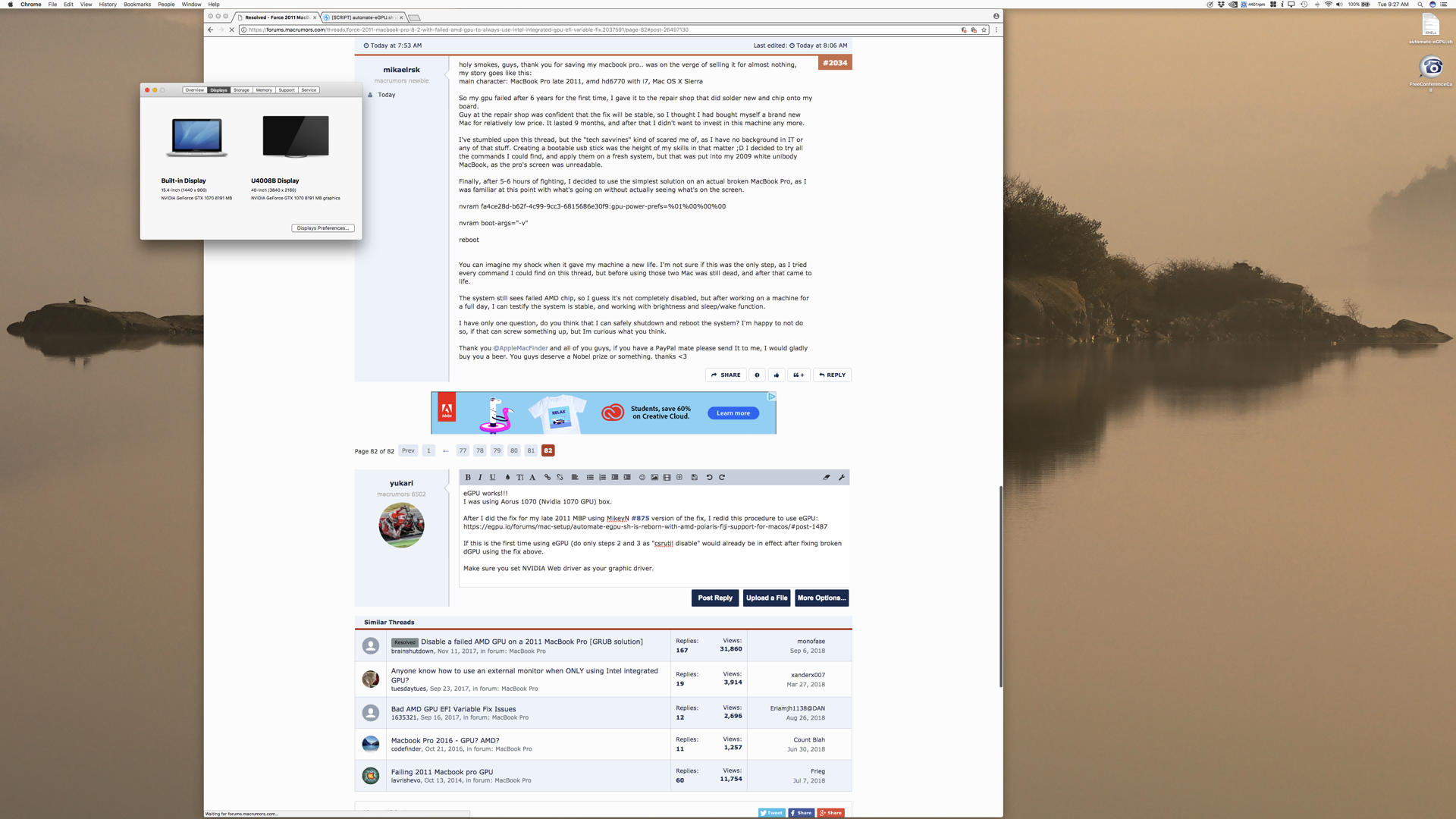

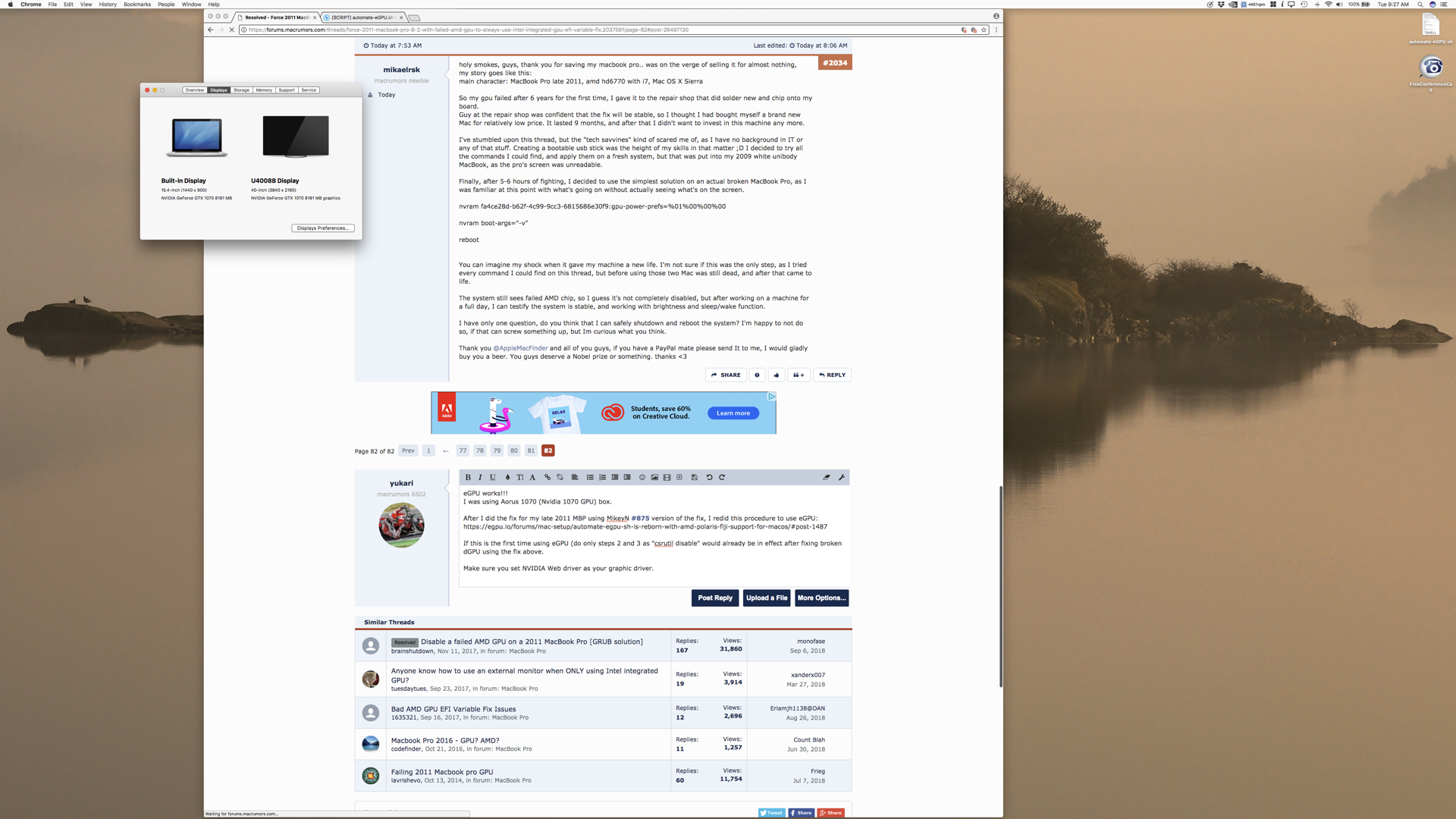

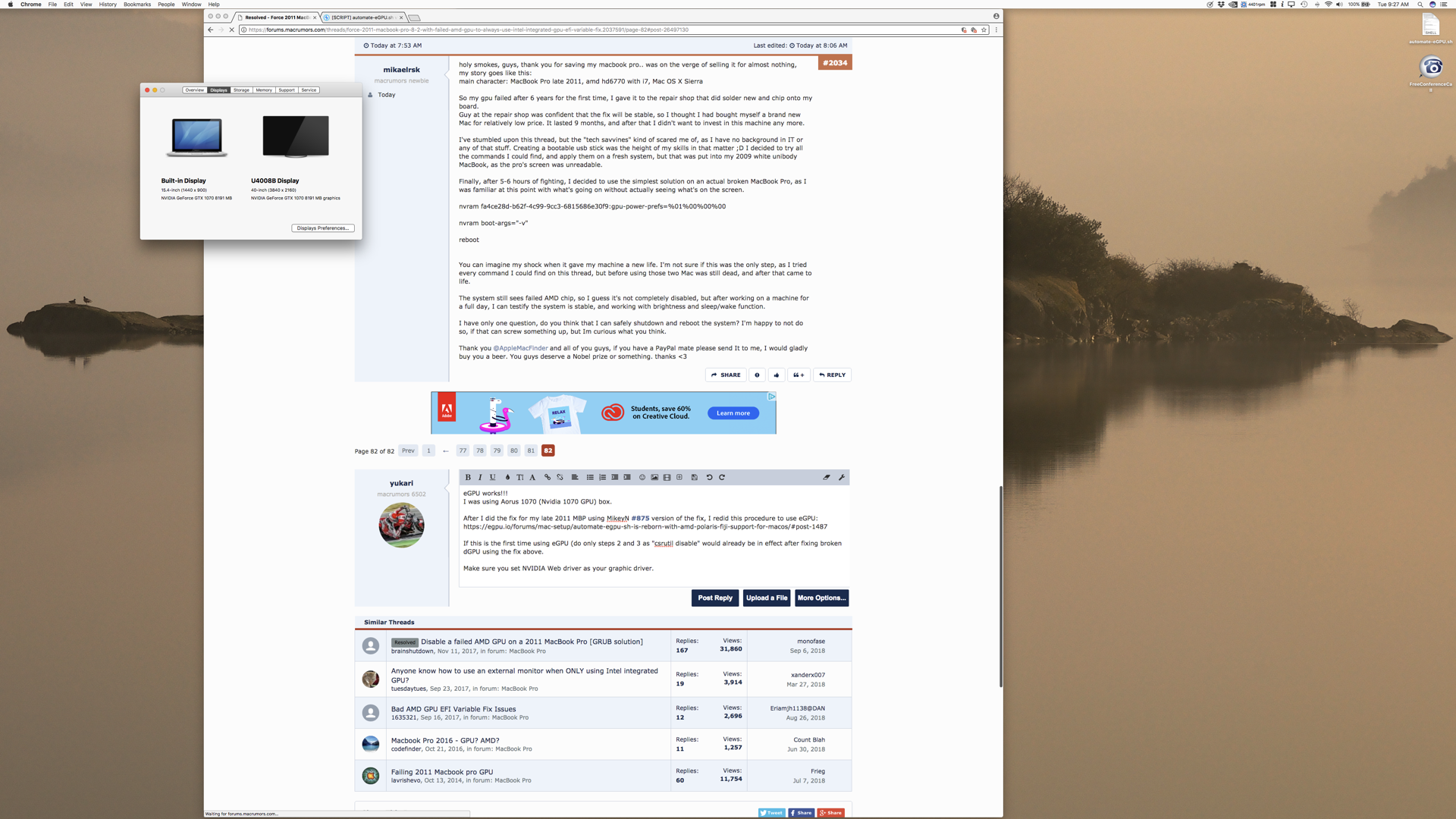

eGPU works!!!
I was using Aorus 1070 (Nvidia 1070 GPU) box.
After I did the fix for my late 2011 MBP using MikeyN #875 version of the fix, I redid this procedure to use eGPU:
https://egpu.io/forums/mac-setup/au...amd-polaris-fiji-support-for-macos/#post-1487
If this is the first time using eGPU (do only steps 2 and 3 as "csrutil disable" would already be in effect after fixing broken dGPU using the fix above.
Make sure you set NVIDIA Web driver as your graphic driver.
Below is screen shot of my 4K external monitor hooked up to dGPU failed late 2011 MBP.
