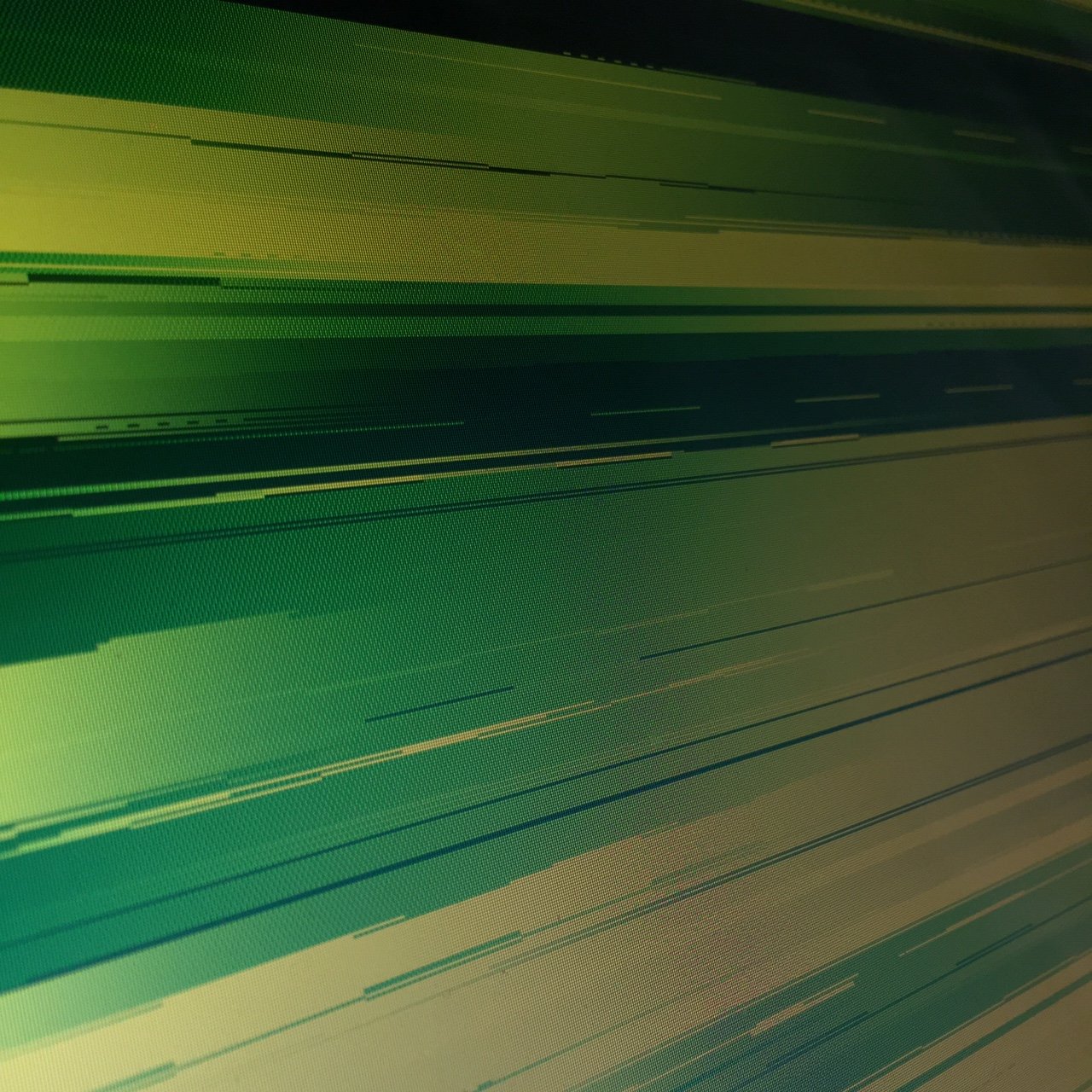

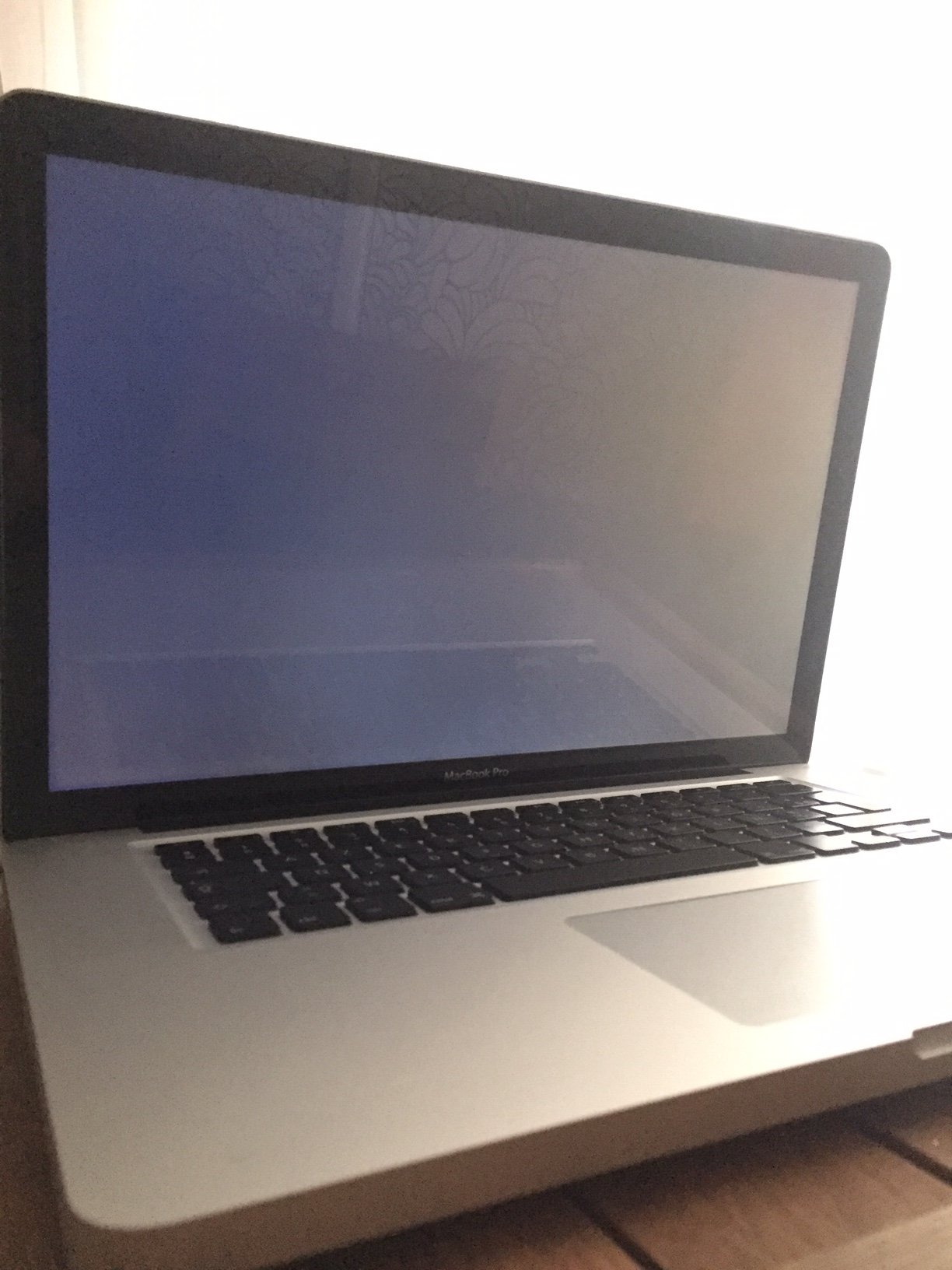

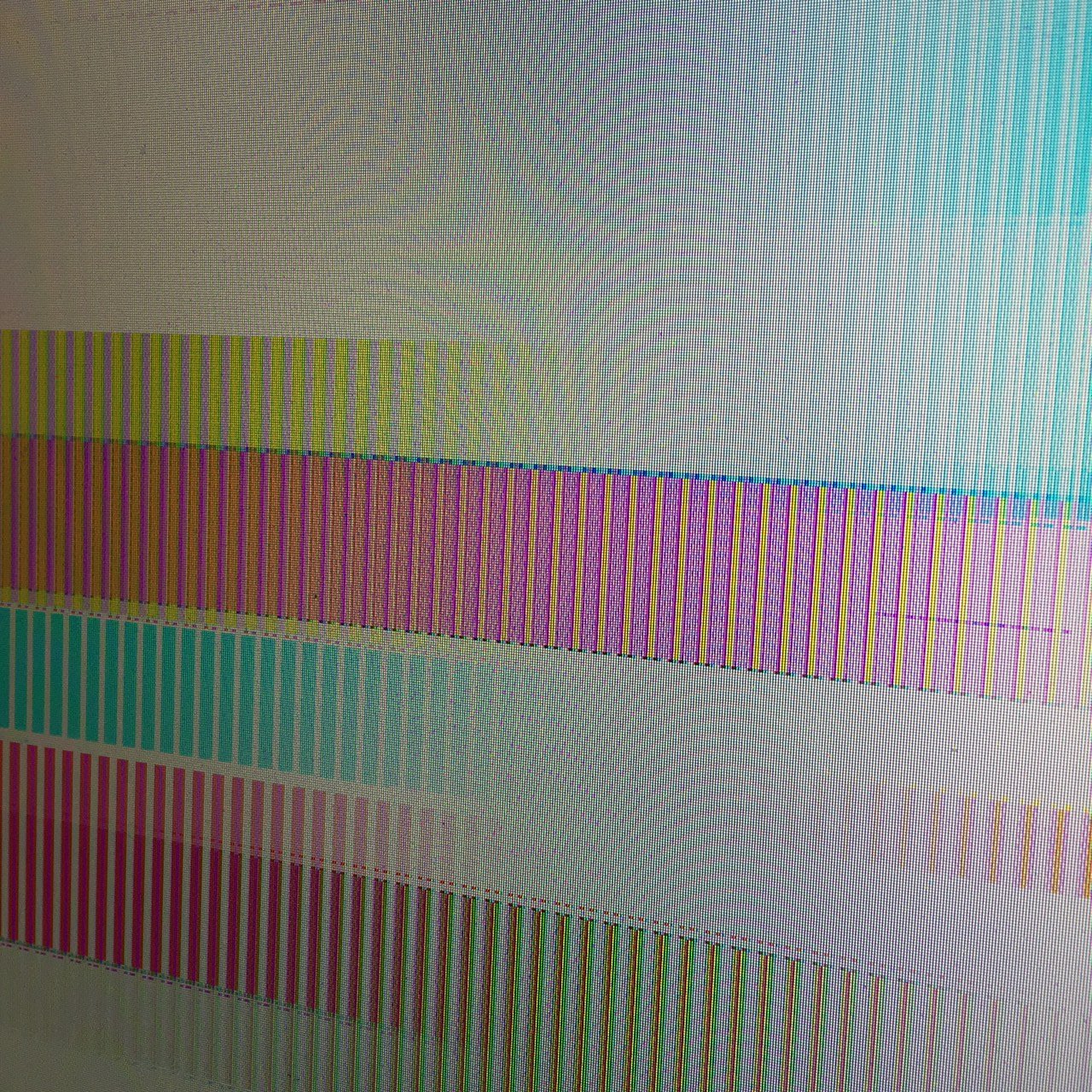

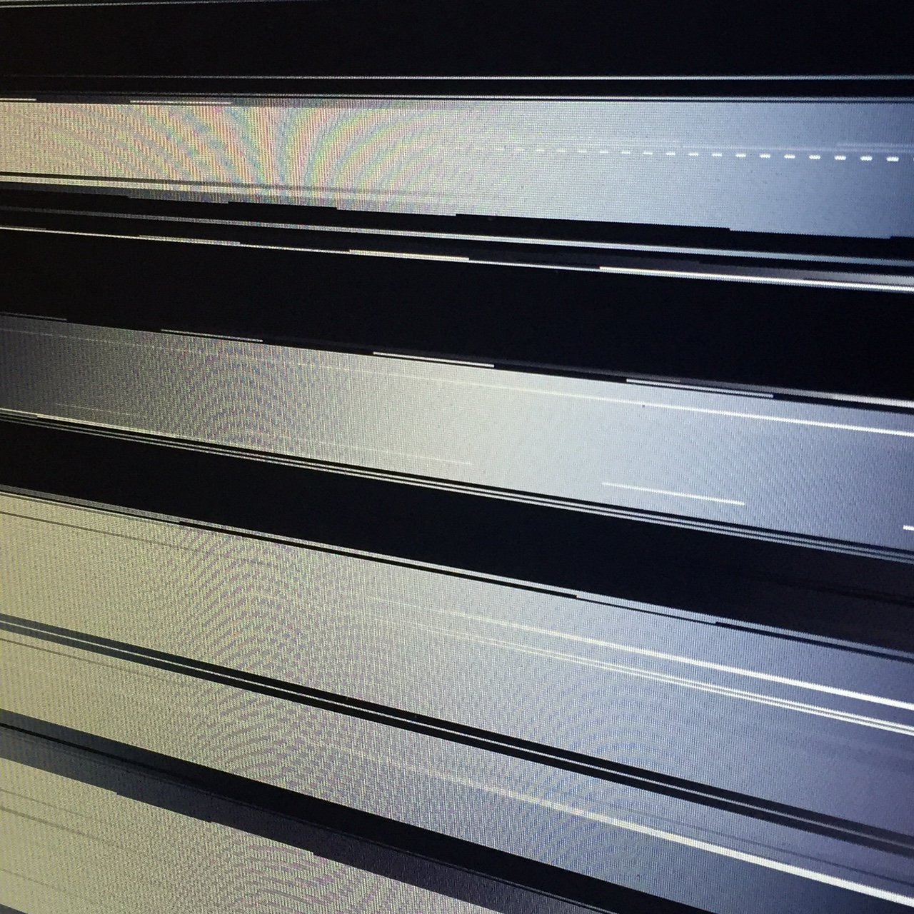

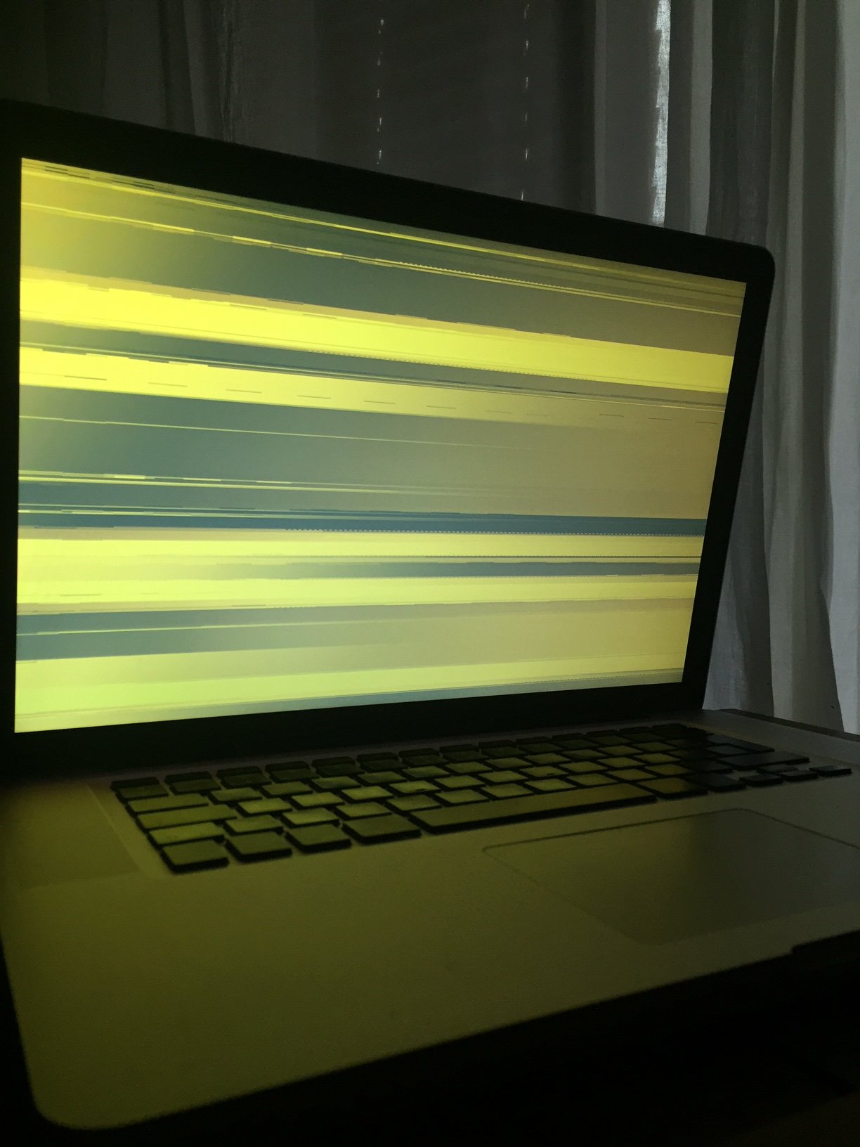

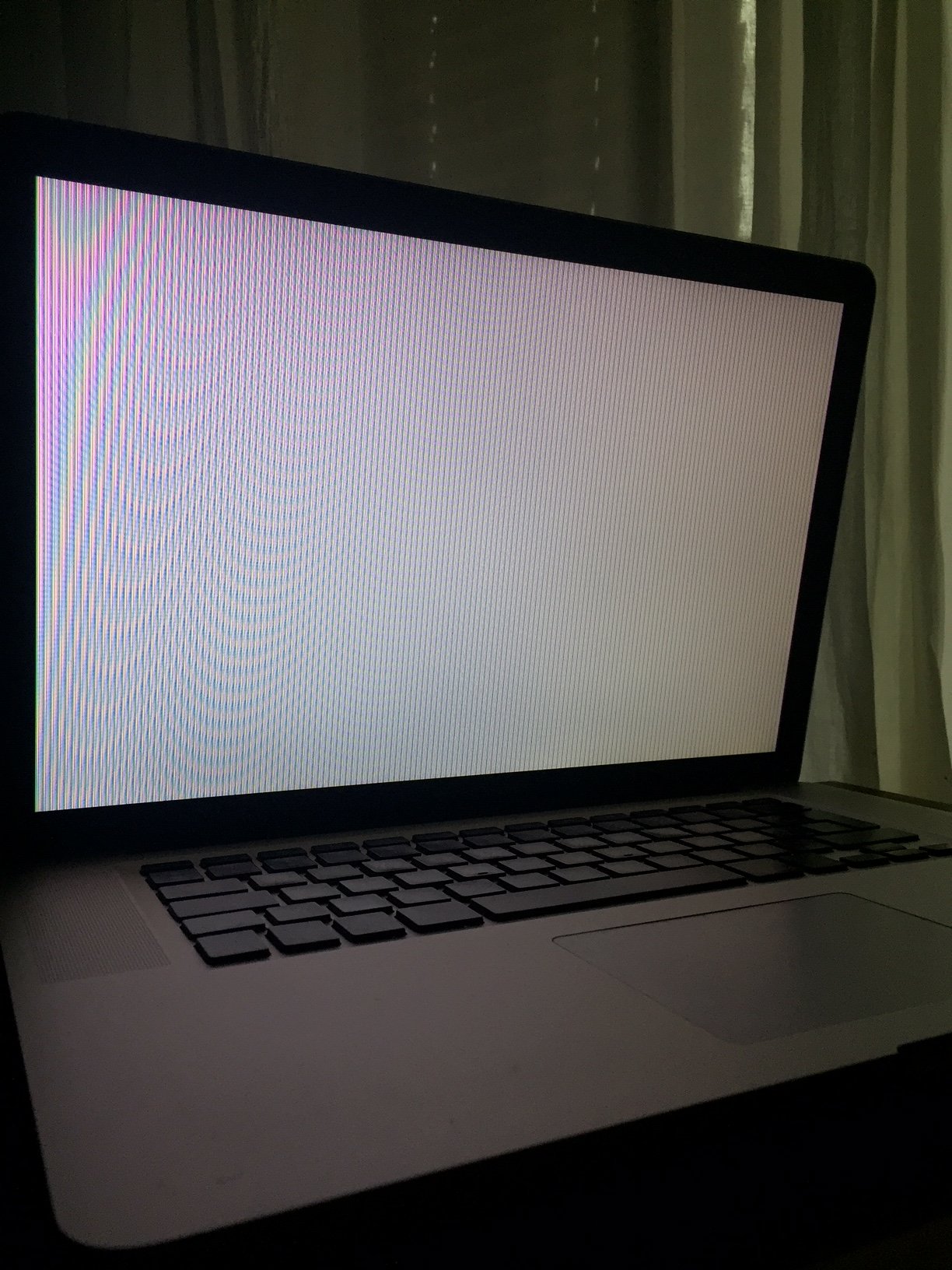

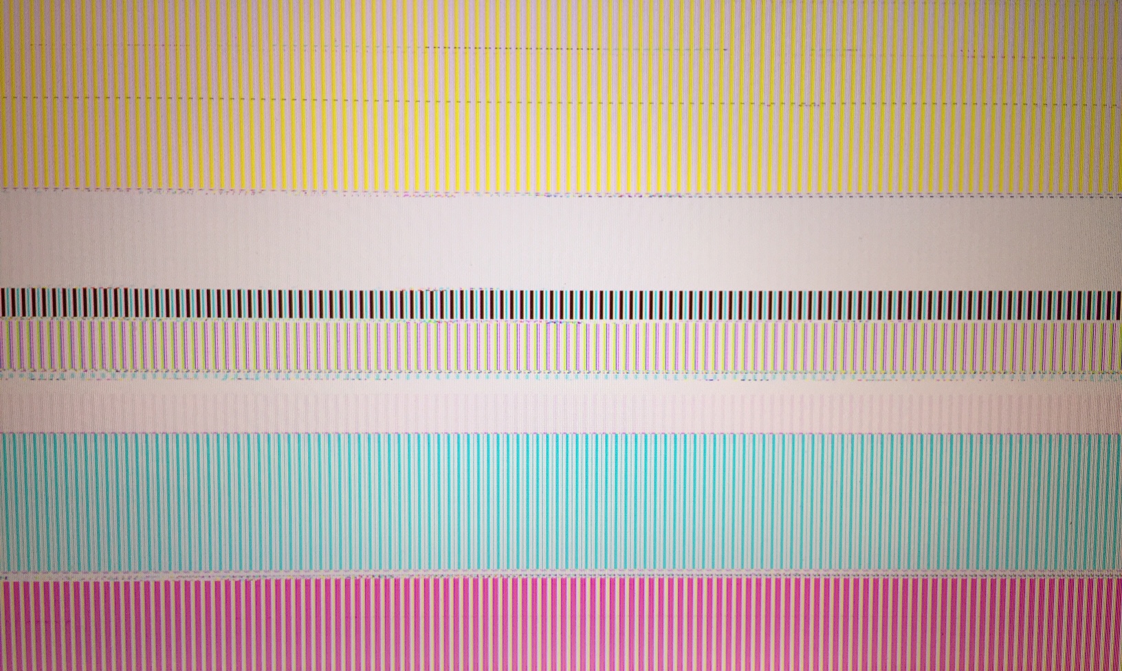

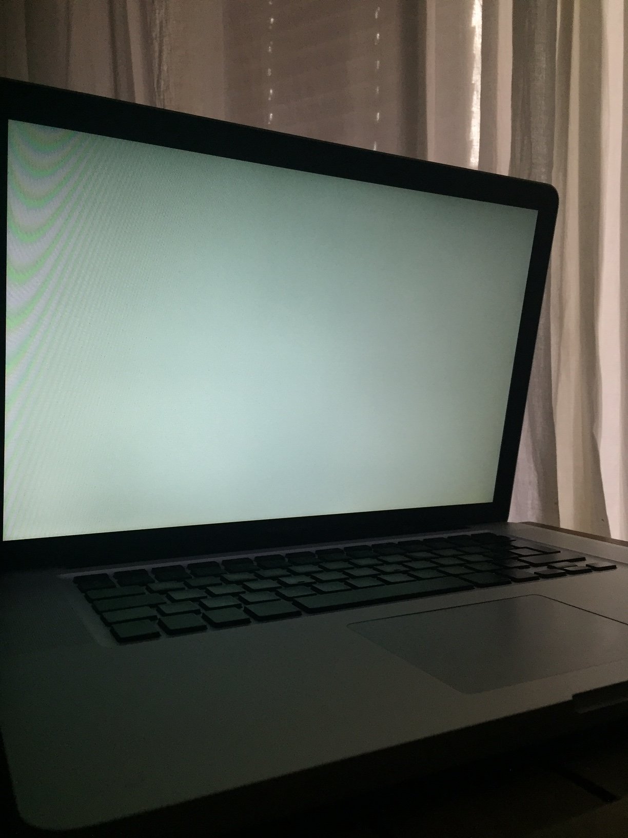

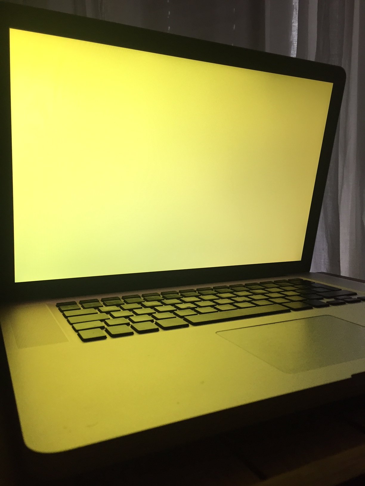

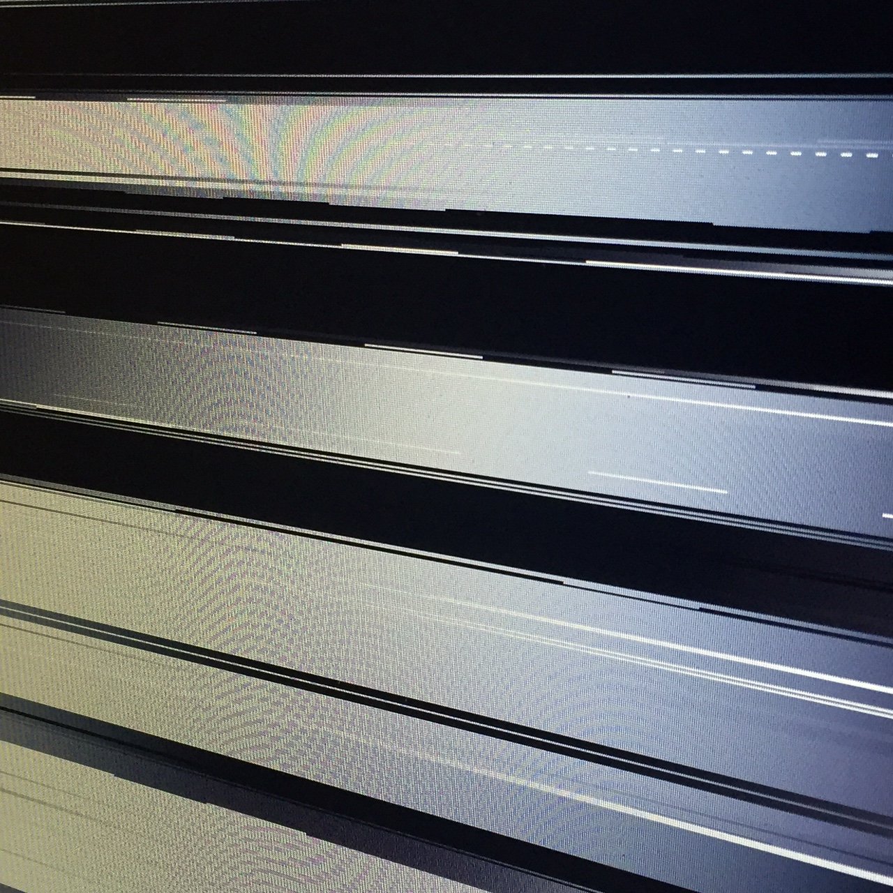

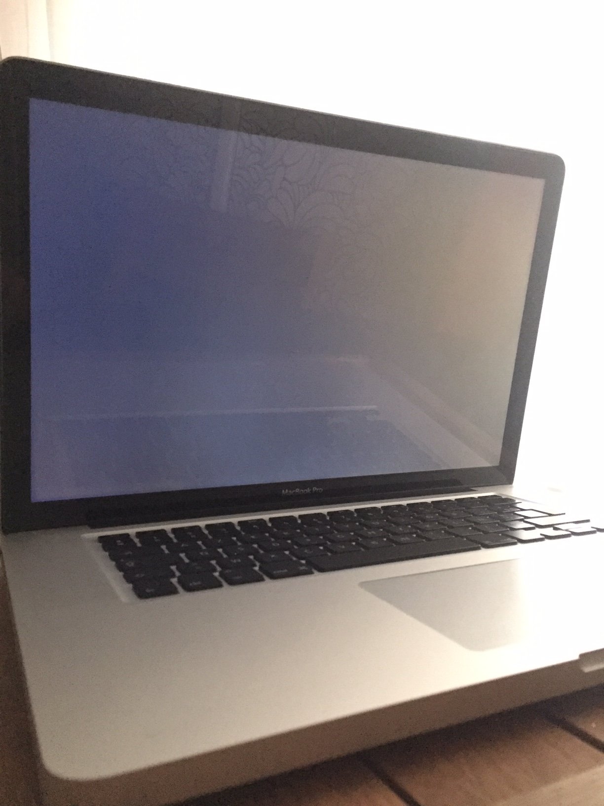

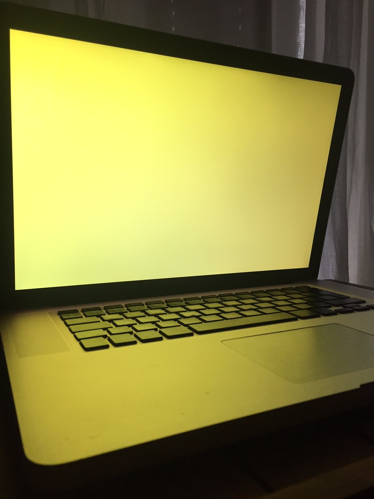

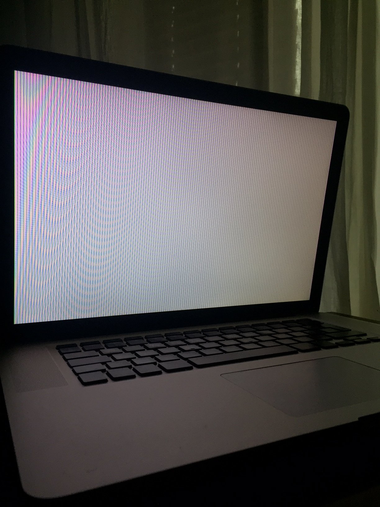

I used the MikeyN solution and my laptop worked well, only a few black screens at startup (intermittently), but now my mbpro doesn't start anymore, I reset the SMC, PRAM, I disconnected and reconnected the battery, removed and replaced the RAM, the screen shows artifacts, colors, vertical bands etc, I keep the CMD+R+S keys at startup but the single user mode remains inaccessible. I really don't know what to do anymore.
Christopfhe
macrumors newbie
Mar 10, 2018
19
14
Paris

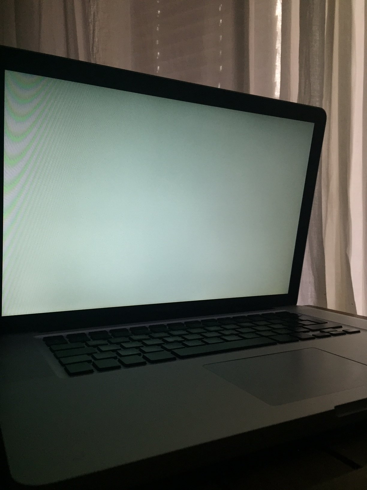

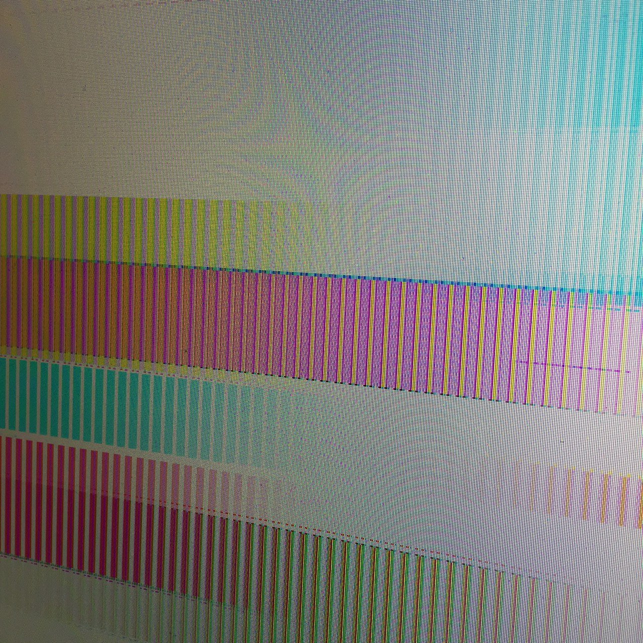

View attachment 798213 View attachment 798214 View attachment 798215 View attachment 798216 View attachment 798217 View attachment 798218 View attachment 798219 View attachment 798220 View attachment 798221 View attachment 798222
I tried to connect this macbook to a second macbook in target mode, I was able to access the hard disk of the first macbook, can I repair the first macbook with the terminal on the second macbook?

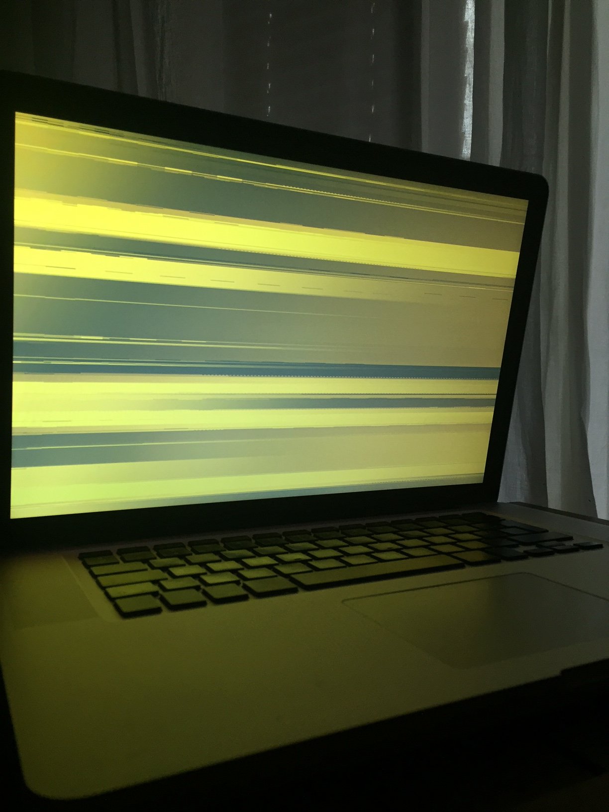

Basically when these stripes appear on the screen, then it may be GPU or memory problem.
I had a problem in one of the memory slots and the screen was all striped.
Now I only use an 8 GB memory module in only one slot (bank memory). I had to buy an 8 GB memory module.
Example Macbook Pro 2011 with 2 memory modules (4 GB + 4 GB)
0 - gpu-power-prefs to Intel GPU.
1 - Power off Macbook Pro 2011.
2 - Remove the Hard Disk from your Macbook Pro 2011 with stripes problem.
3 - Test the Macbook Pro 2011 using only one of the Memory Slots. One of the 4 GB memory modules has to be removed from Macbook Pro 2011.
4 - See if the Macbook Pro 2011 normally power on without problems on the screen.
Yes, you have removed the Hard Disk and there is no system. See if the screen works OK with the symbol that appears on the screen saying there is no system.
If you prefer, you can then try to use a Mac OS installer (pendrive / USB Stick) and enter the Single User Mode.
Press Option key at boot -> Position the mouse over the Mac OS Installer icon -> press Command + S and hold-> click the Mac OS Installer icon (hold Command + S keys) -> will now load the Mac OS Installer (USB Stick) Single User Mode.
Or try Mac OS Installer Graphical Mode -> press Option key at boot -> click icon installer.
5 - Power off the Macbook Pro 2011 and test the other memory slot.
6 - Repeat the process with the second memory module.

Thank you for that answer but I can't set the gpu-power-prefs to Intel GPU (step 0 on your tutorial), I can't startup the mac in single user mode, each time I start up, I have this screen artifacts, or black screen, colored screen etc. I removed my ssd, powered on with only one memory, alternately, one slot, and the other one etc, I still have the same screen artifacts.
It's just like trying to starting up a car with the hood locked.

Do you have two memory modules to test or only one memory module?
If you have two memory modules did you test both?
Does the Macbook Pro give you a beep when you Power On? Problem in Sllot or memory module makes 3 beeps.
Apple Macbook Pro 5.5 Video Cable / LCD Screen Problem ?
"This is definitely display cable or lcd issue Here is the good link that you can use to fix/solve/replace the LCD. http://www.youtube.com/watch?v=H4LLOh.... Apple Macbook Pro 5.5 (late 2009) 2.26 Ghz Intel Core 2 Duo Chipset Model Nvidia 9400M ROM Version 3427".
Unfortunately, the user on the Youtube channel has placed the video solving the problem as private.
How to repair the display connector on logic board
https://www.ifixit.com/Answers/View/97399/How+to+repair+the+display+connector+on+logic+board
Christopfhe
macrumors newbie
Mar 10, 2018
19
14
Paris
Just tried with one module, I will try tonight with the module of the other macbook
no beep sound, just the chime sound, sometimes a looping chime on booting (with black screen)
thank you for your assistance
edit : I can't try the other module, this ram isn't compatible with this mbpro (2011 and 2012 models)
in my opinion, it's a gpu problem, I've always had these screen artifacts but until now I could start in single user mode, it's now impossible
