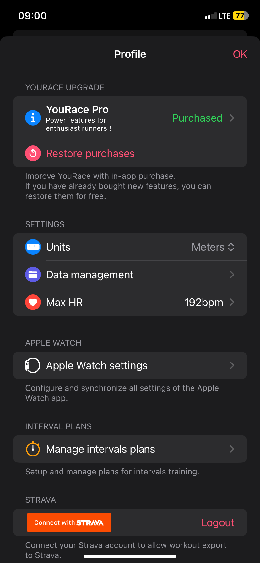

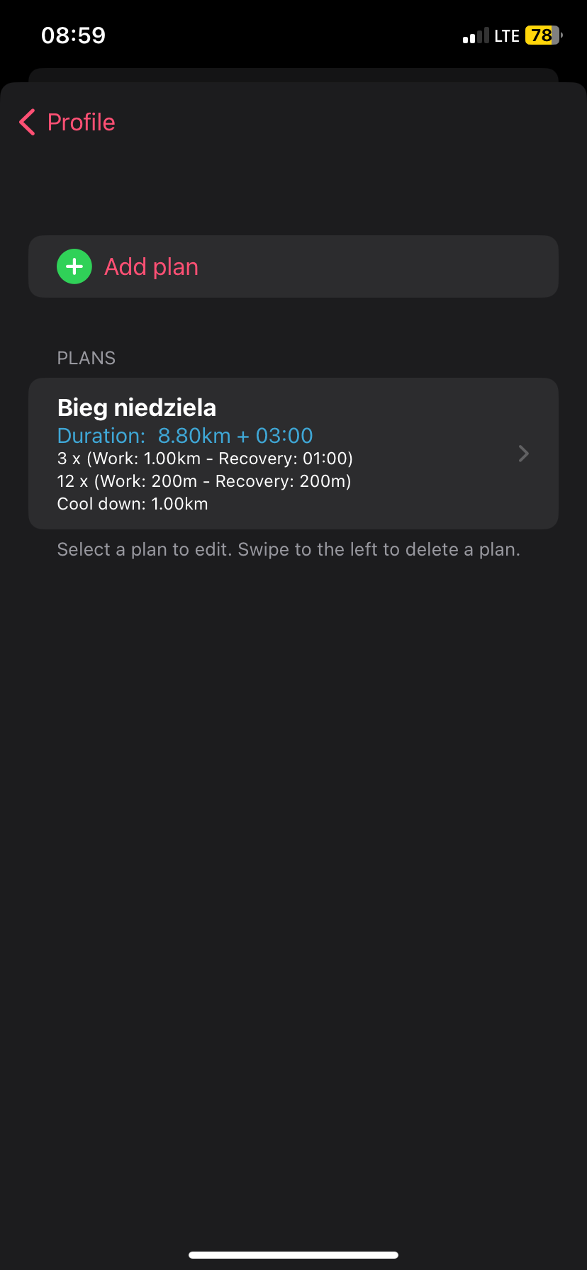

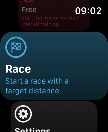

I activated the plan - for developers.
I do not have this option in the watch…

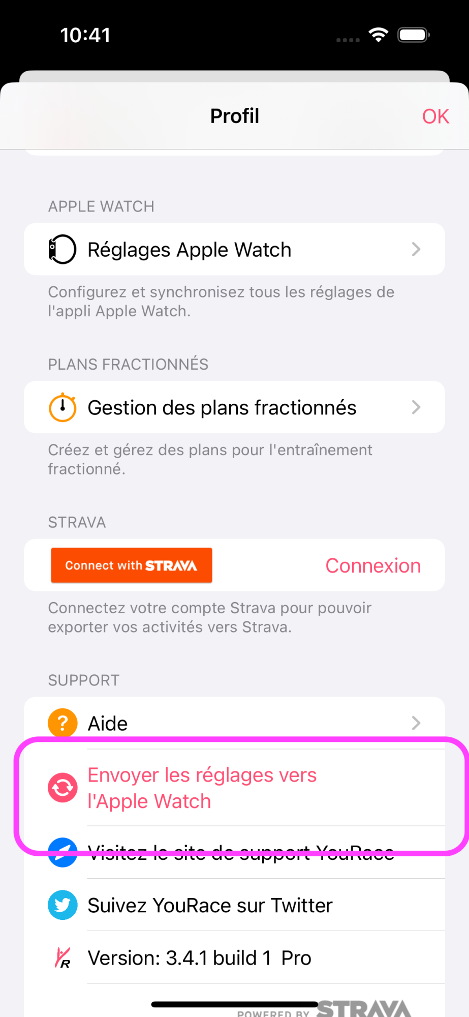

You have probably an issue with data sync between your iPhone and your Watch.
You can try several things to fix that:
- reboot your watch
- when it's up and running again, from YouRace iPhone app, you can try to force sending settings again on the watch (see screenshot)
- then after restarting YouRace on watch, it should show the missing interval plans menu.
Maybe you can also check that iCloud Keychain is also enabled on your iPhone.
If it's not working, you can contact me on the support email, we will find the solution.

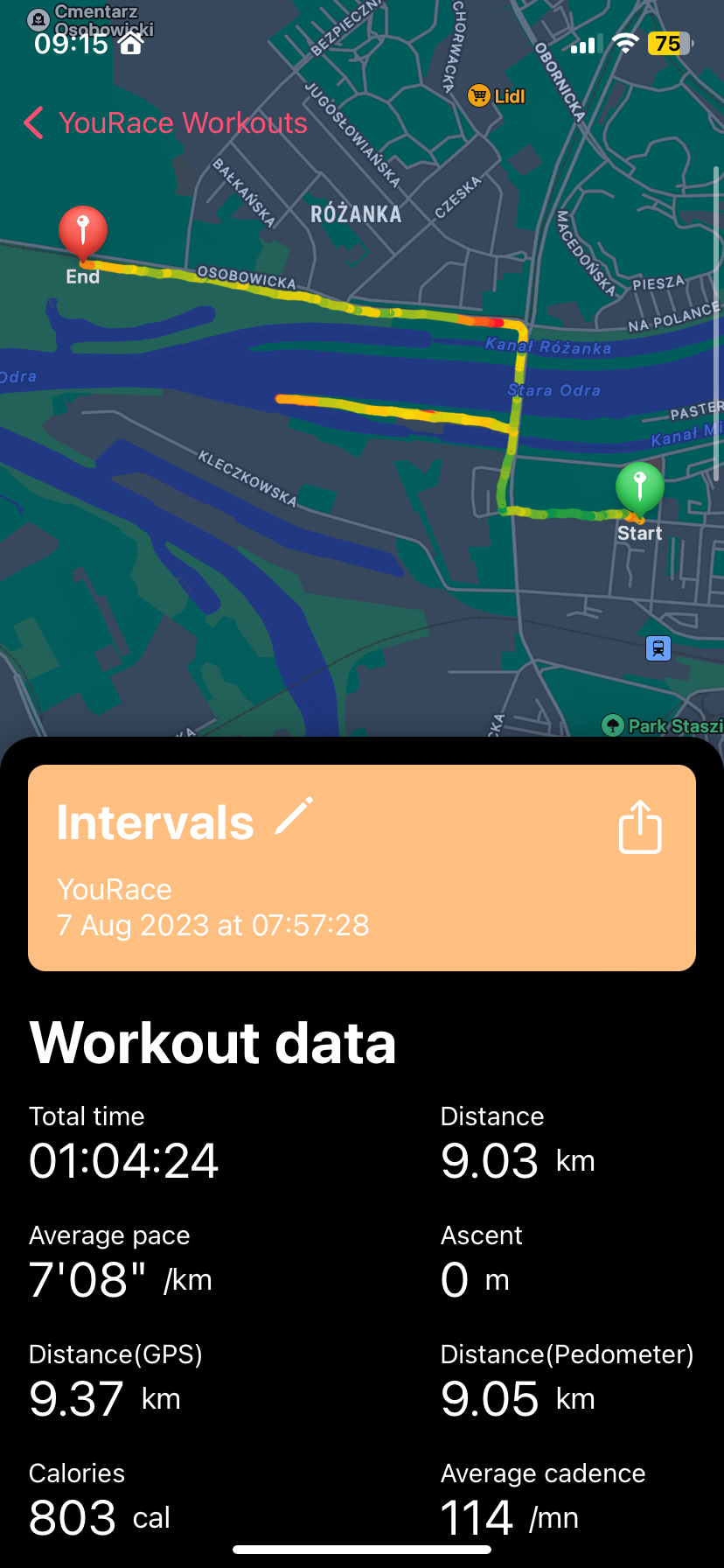

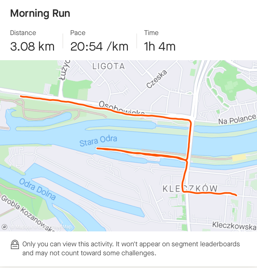

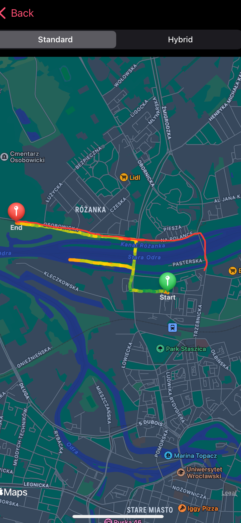

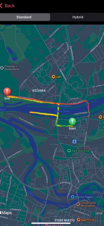

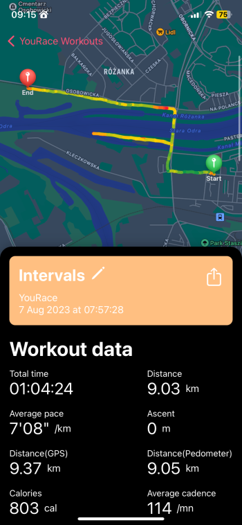

Ok working. But..
Hmm quite a serious error intervals when exporting to strava pretty much cut out the route wiped out overall also pretty much even before importing. The last screenshot shows the actual route.
The conclusion is that it passed the 3km initial run without intervals of 12x200m and rest + 1km finishing run.
Very strange ...
It's the first time I see this !
One question, are you using watchOS 10 beta ?
Yes, in the default application so complex problems did not appear... GPS actually got lost.
If you look in Runners beware WatchOS 10 Beta 4 topic in the same forum, you will notice a lot of complaints of truncated workouts, GPS lost ... It's random, some days it works, somedays it's catastrophic ...
In YouRace, I use Apple APIs for getting GPS track, and if there are bugs in these APIs, I get wrong data in YouRace.
For the moment, I have no watchOS 10 device (I only have one Watch and need it to be reliable), so it's hard to support watchOS 10 ...
