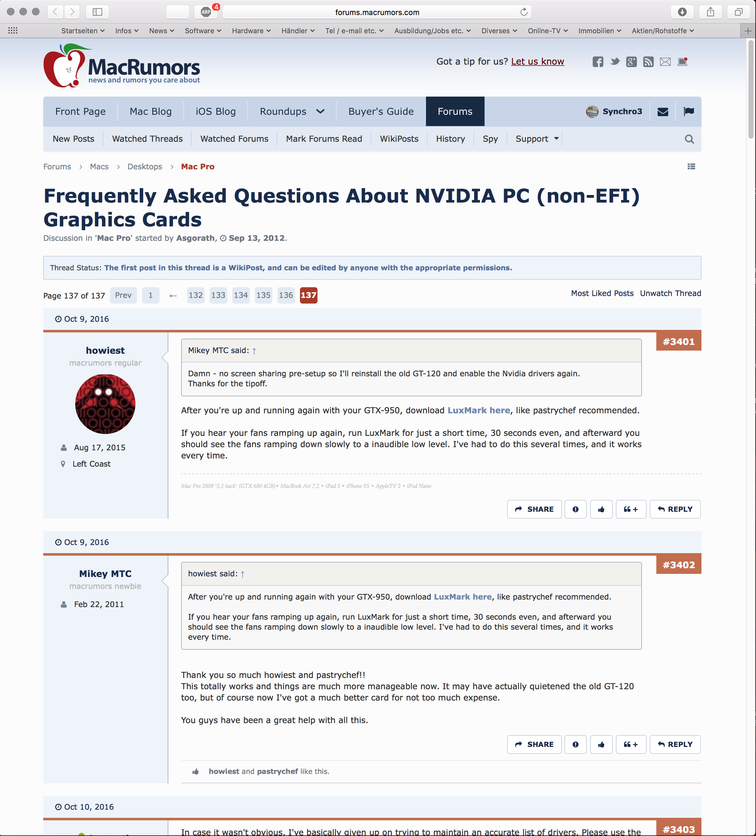

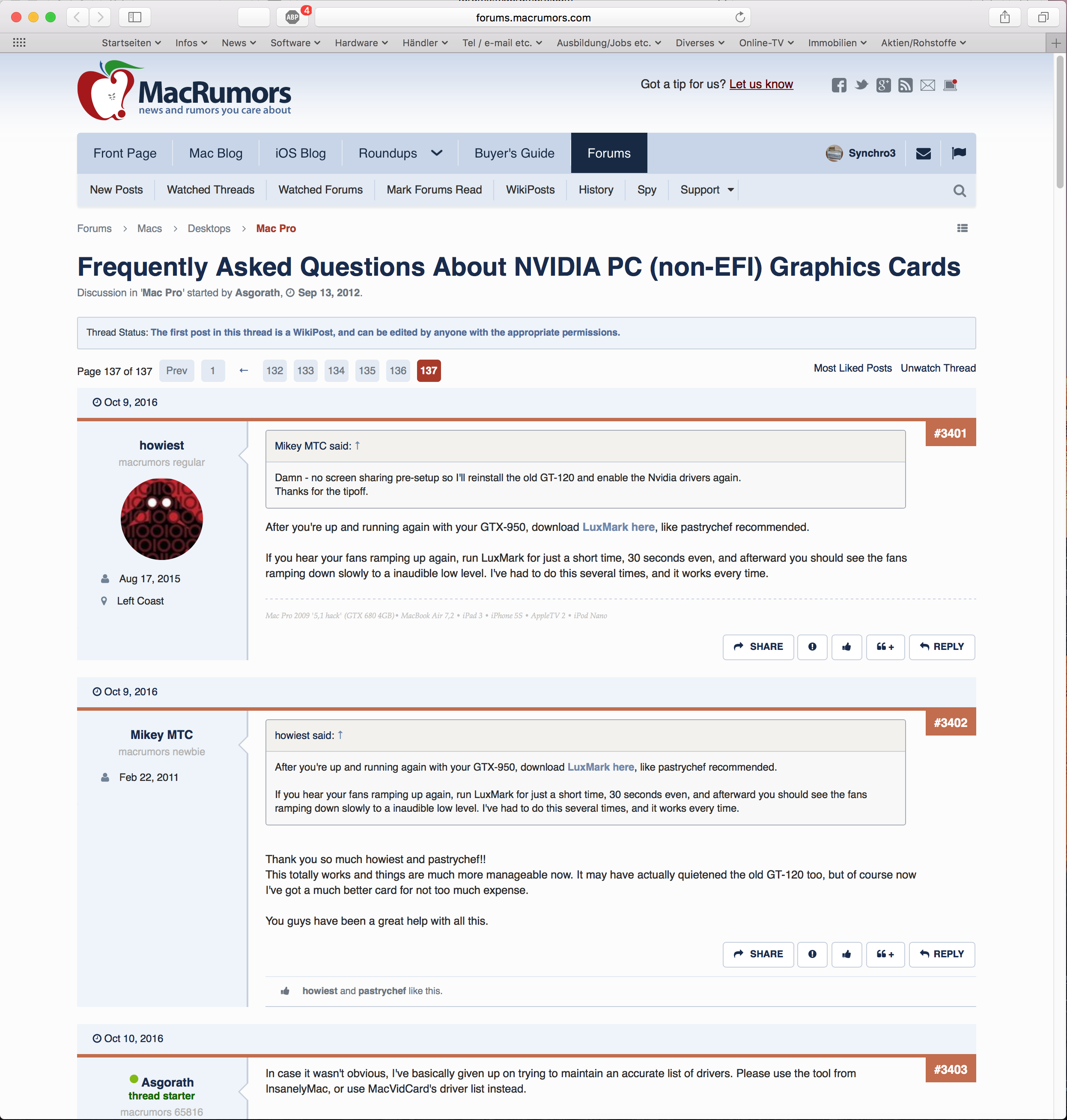

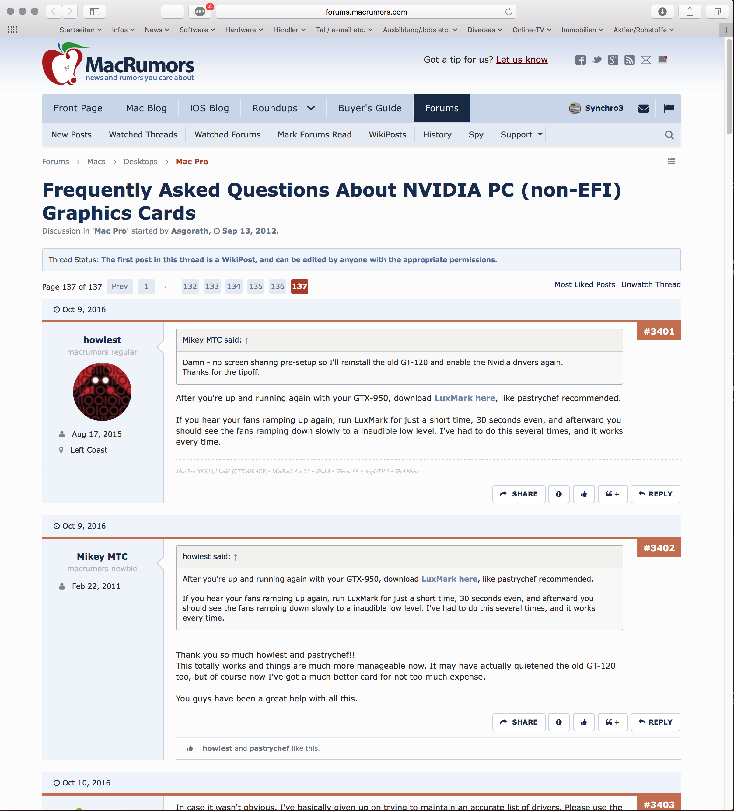

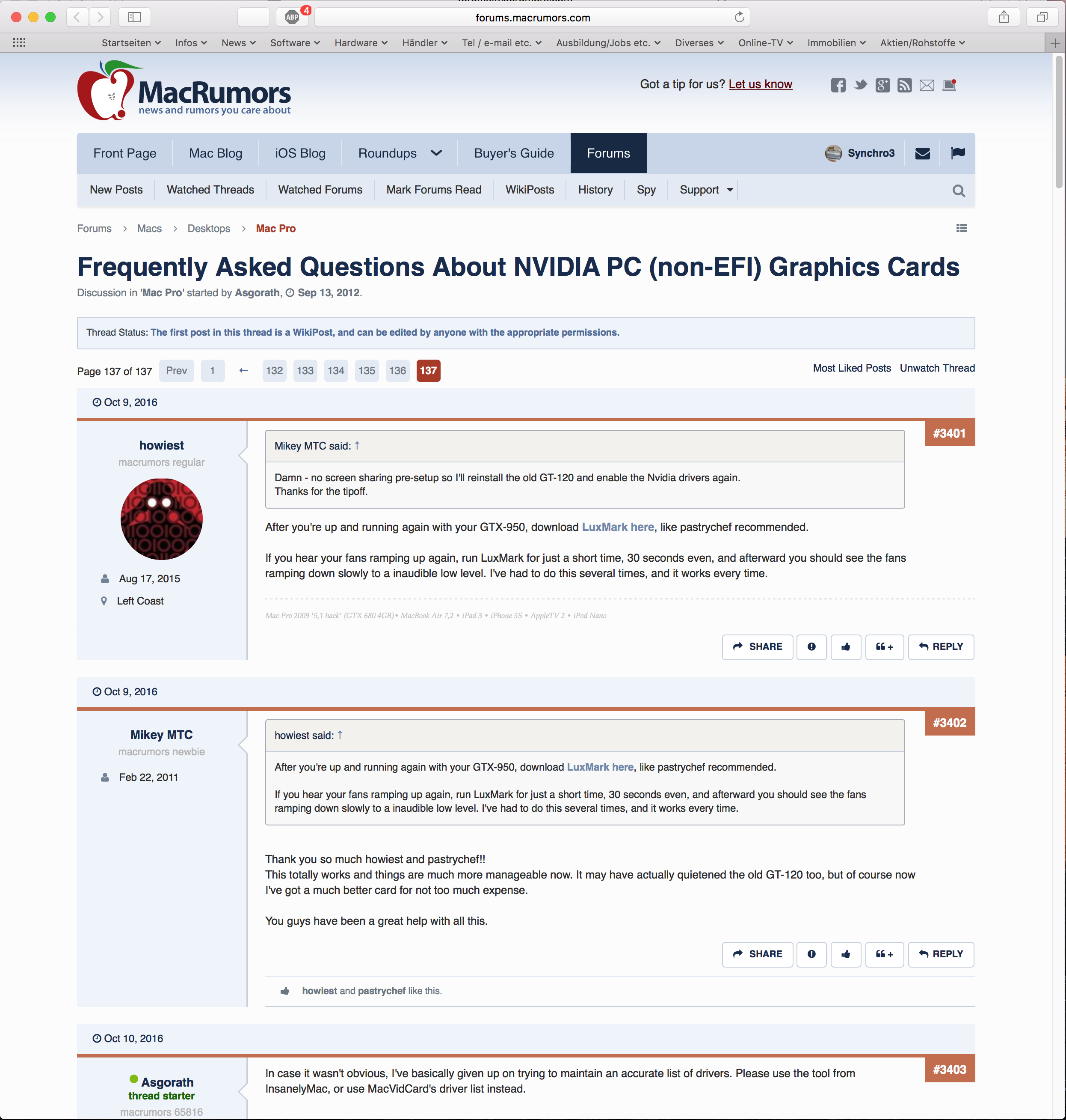

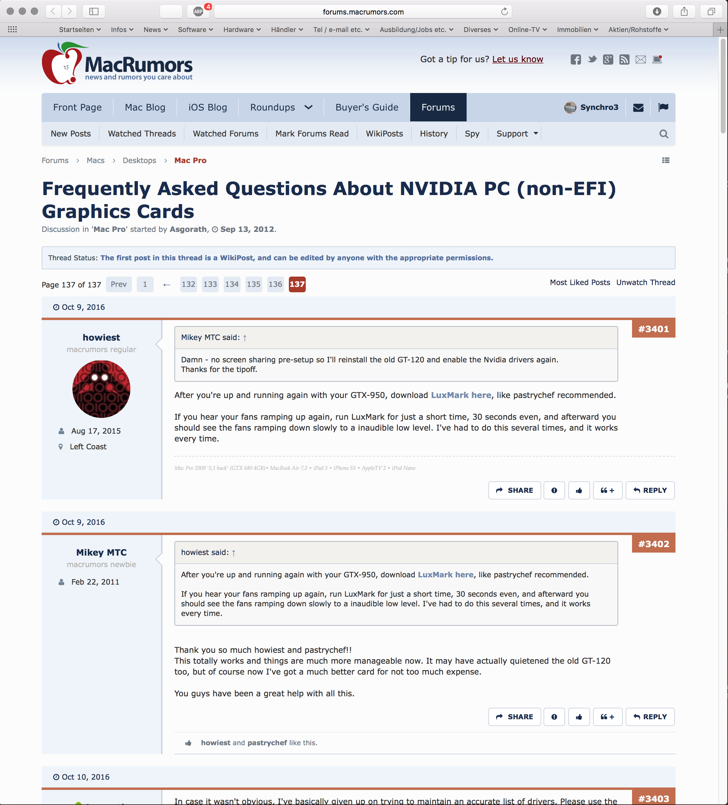

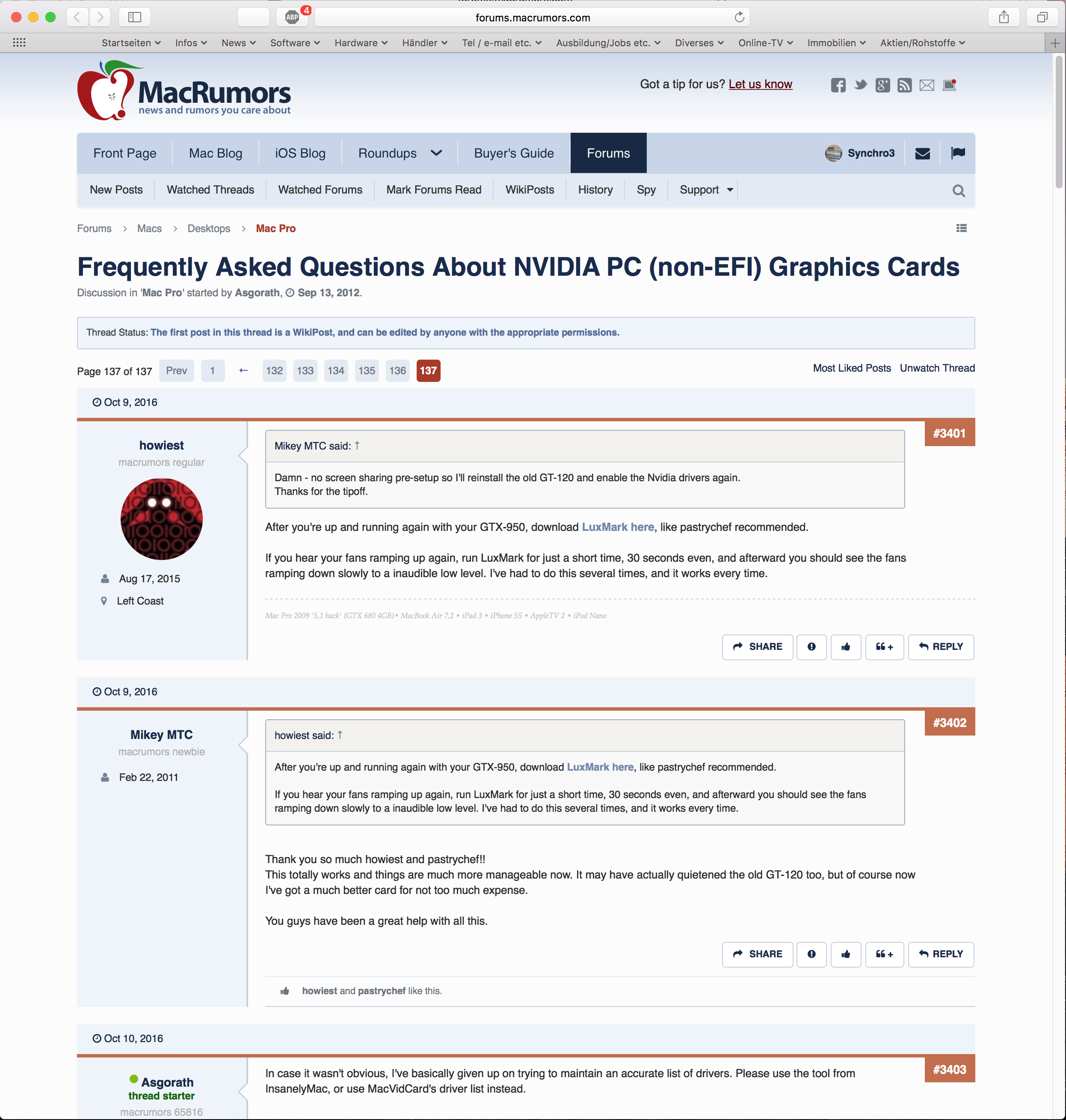

Damn - no screen sharing pre-setup so I'll reinstall the old GT-120 and enable the Nvidia drivers again.
Thanks for the tipoff.
After you're up and running again with your GTX-950, download LuxMark here, like pastrychef recommended.
If you hear your fans ramping up again, run LuxMark for just a short time, 30 seconds even, and afterward you should see the fans ramping down slowly to a inaudible low level. I've had to do this several times, and it works every time.
Thank you so much howiest and pastrychef!!
This totally works and things are much more manageable now. It may have actually quietened the old GT-120 too, but of course now I've got a much better card for not too much expense.
You guys have been a great help with all this.
In case it wasn't obvious, I've basically given up on trying to maintain an accurate list of drivers. Please use the tool from InsanelyMac, or use MacVidCard's driver list instead.
