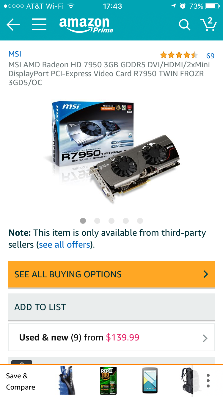

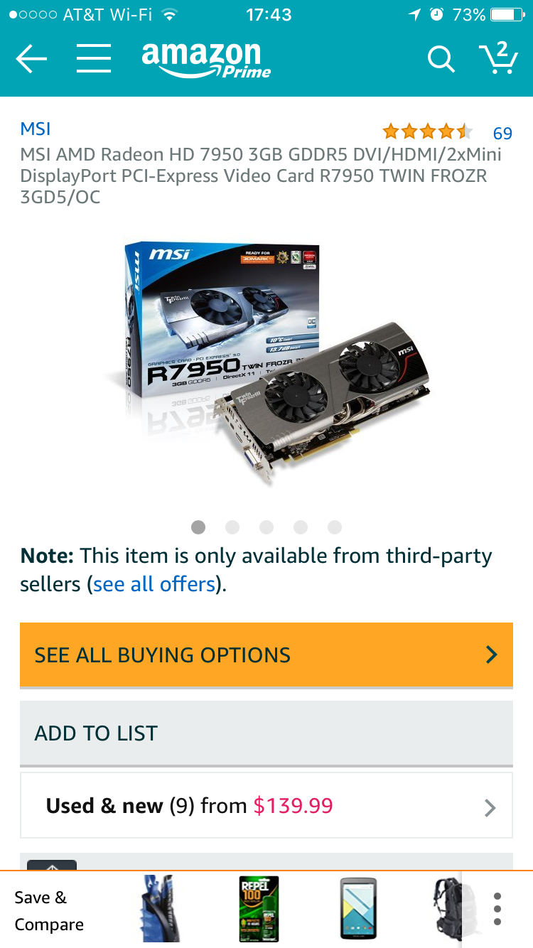

Any specific ones, that you know of, off hand, that have the ability to function like I wish, that are not more than $120 (new/...used)?
Ok, soo... this 7950, flashed, WILL work? lol
