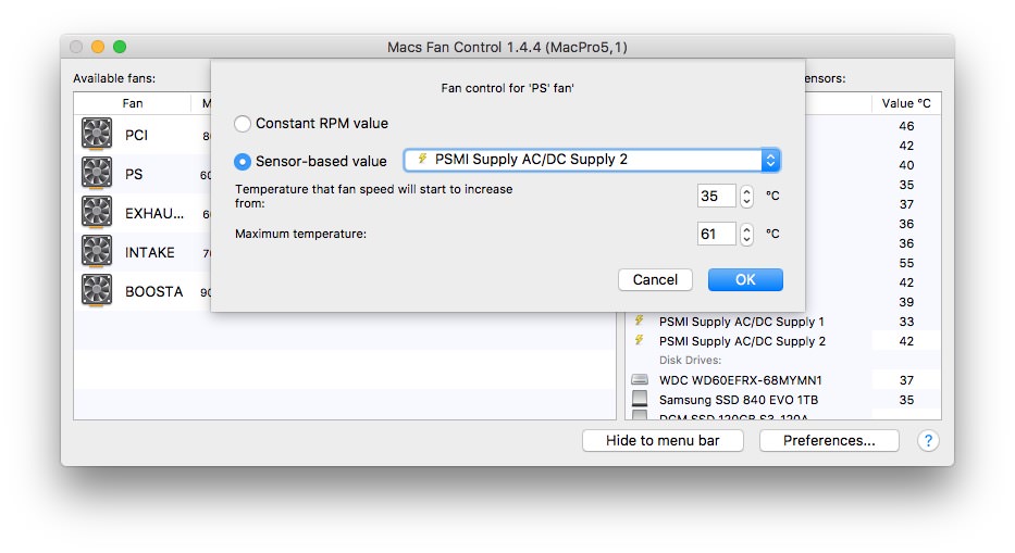

In my 4,1, when the PSU is clean, PSU 2 temperature is always higher than PSU 1 temperature (in MacsFanControl), in the old version, they called the PSU 2 as PSU Components, and PSU 1 as PSU Ambient. Of course, I am not able to verify it these names are correct, but in my case Components' temperature always higher than Ambient, which make sense.
When the PSU is dirty (full of dust), these 2 temperatures will very close to each others.
This is the setting I am using now. My PSU 2 temperature usually idle at around 35C. Therefore, I use 35C as reference (idle 600RPM at 35C), and increase 100RPM per 1C (PSU 2 temperature). This will allow the PSU to go up to about 42C (as shown) when under stress.
If you want a cooler PSU (e.g. you don't mind more fan noise, or you have a lower ambient temperature), you may further lower both the min and max temperature.
If you want a quieter PSU, you can make something like min at 40C and max at 66C. In my own test, this can still keep the PSU always below 50C. And the PSU max temperature is way way higher than that. Keep it at low temperature is mainly to extend it's life, not because there is any danger.

hay thanks for the details my psu location 2 peeked at 55c but seems to be around 45-50c most the time (over the last 6 hours of mixed use and some benchmarks).
maybe i need to grab some caned air to give it a blast, not relay shore how to clean the PSU.
any cleaning tips?
the power draw seems ok hardware monitor reported a peek of 79.7w on line 2 and 67w on lane 1 so as long as i dont OC the card i think it's ok
