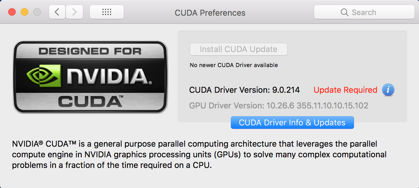

anyone happen to have the updated CUDA link for 10.13.1?
current CUDA driver is 9.0.214, but that needs an update

thanks, wasn't 100% sure. will wait a few days. auto-update hasn't been working for every release and usually need the DMG installer.

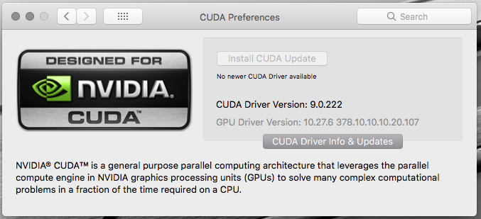

[doublepost=1509557558][/doublepost]was just prompted with an update available, downloaded and installed from the pref pane, now at CUDA Driver Version: 9.0.222... but pref pane still saying "update required"

^^^^But, it's (9.0.22) now:
CUDA 9.0.222

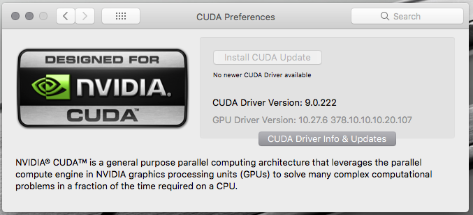

And after my installation, Cuda CP is reporting up to date:
Lou

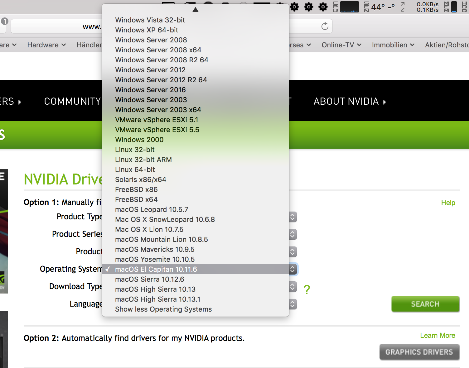

Appears there was a registration issue with the NVIDIA Web Driver installed via the preference pane update. Re-installed from the WebDriver-378.10.10.10.20.107.pkg downloaded at http://www.nvidia.com/download/driverResults.aspx/126538/en-us and everything works fine now. Not sure I've ran into that particular issue before with the updates.
