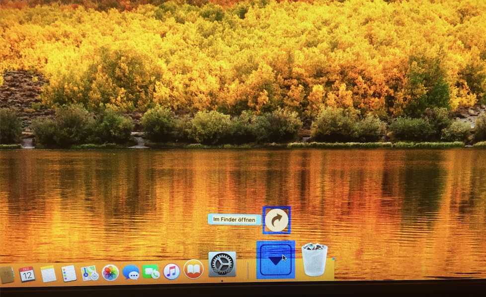

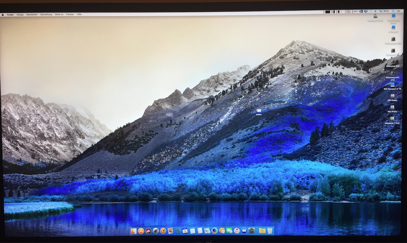

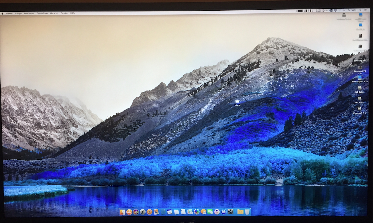

I have found a new bug. Since 10.13.2 I don't get 10 Bit color properly with the newest Nvidia Web drivers (GTX Titan X Maxwell with ASUS PB279Q monitor). I i've activated 10 Bit always with SwitchRes X. This was no problem until 10.13.1.
However, with the Sapphire RX 580 10 Bit with the same monitor is no problem.

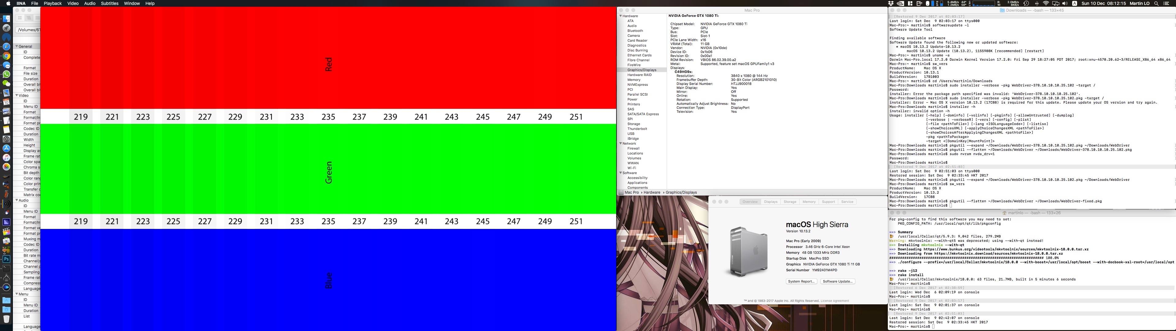

For your info. My 1080Ti able to work in 10bit colour mode in 10.13.2 (17C88) on my Samsung CHG90

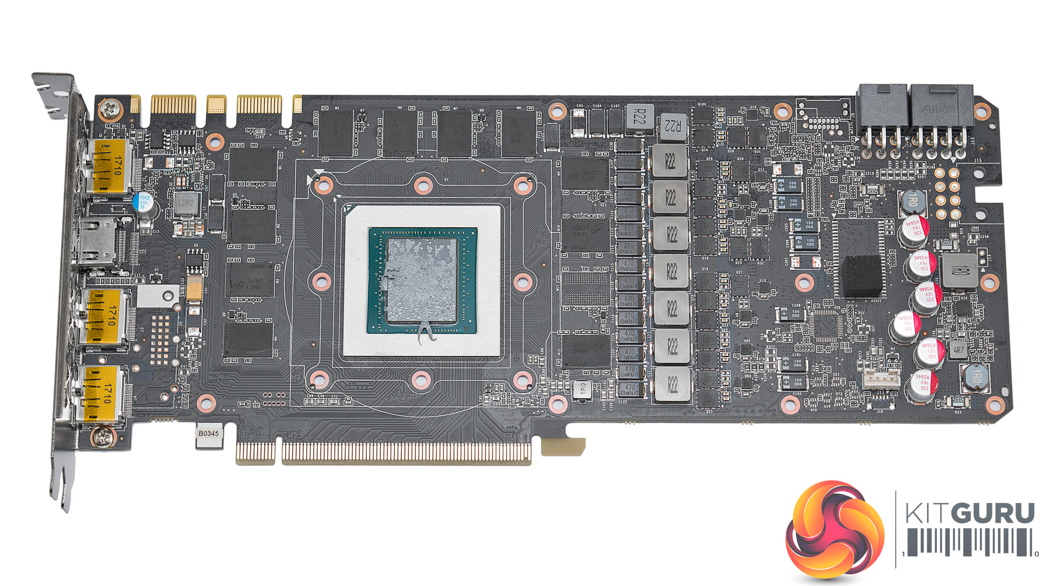

For each GPU, Nvidia will design a PCB for it, and the one that Nvidia sell to public is called the reference design PCB.
Some after market graphic card even use the same GPU, but may put it on their own customised PCB. e.g.
This is the reference PCB of the 1080Ti, as you can see, Nvidia's name and logo on it.

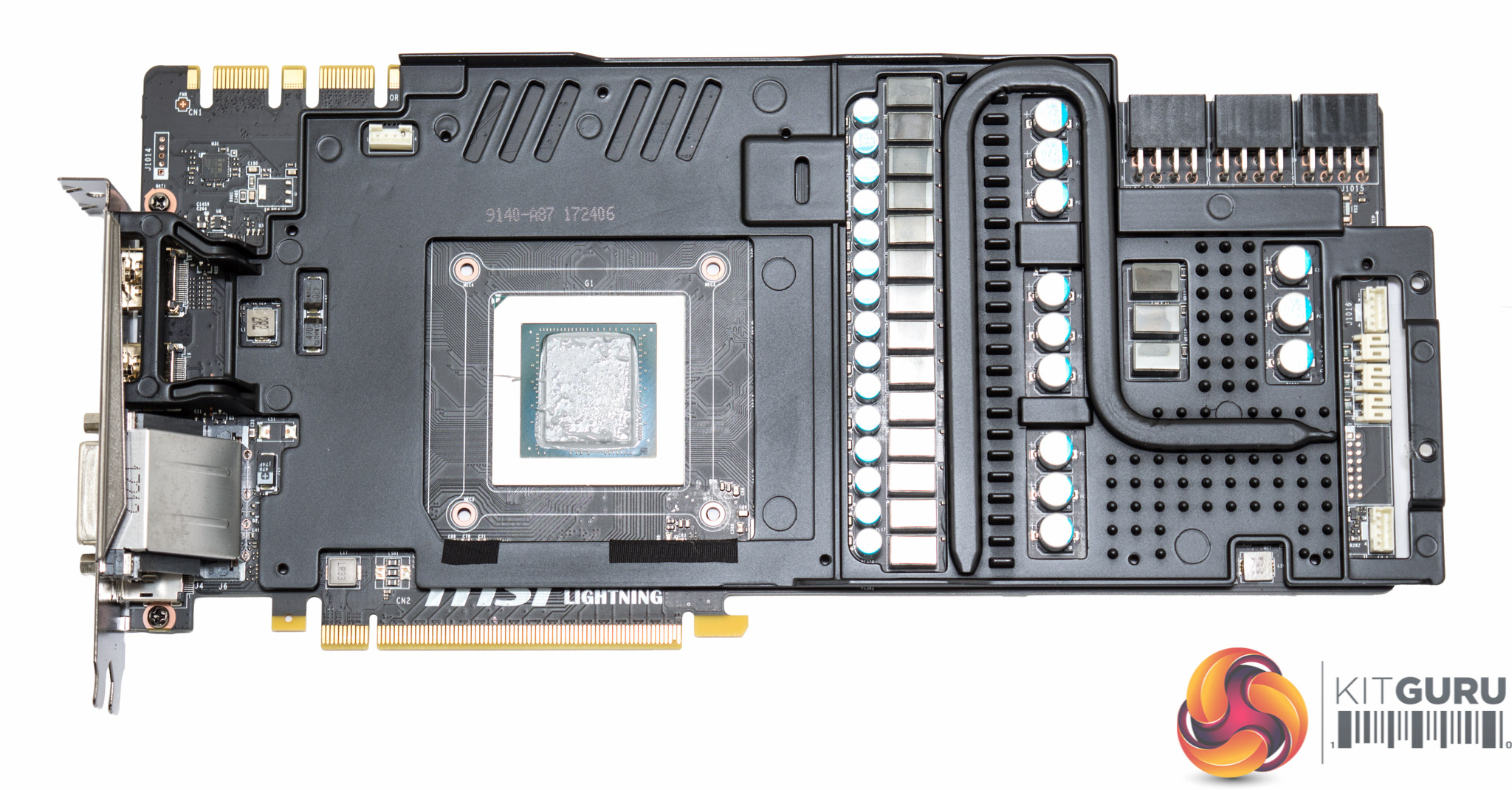

And this is also a 1080Ti's PCB, but it's from the MSI Lightning Z model. As you can see, it looks very different then the reference one, no matter the port layout (an extra DVI port), power supplying ports (3x8 pin vs 6+8), power managements (14 phases vs 7 phases), etc, all different.
They are all 1080Ti. However, I highly suspect the Nvidia web driver never been tested on the non reference on (in this case, the MSI one). Therefore, it's hard to tell if the card can work properly under MacOS.

Thanks for the info. I guess it's an issue with my monitor.
Despite of the description it's not a real 10 Bit monitor: https://www.asus.com/Commercial-Monitors/PB279Q/
I just found where the possible problem is. If I switch to HiDPI, then I get exactly the same colour issue as you do. Since your monitor is a 4K monitor. So I suspect you are running some HiDPI resolution. May you try if you run at native 4K resolution, will the 10bit colour able to display correctly?
Yes, I run 2560 x 1400 HiDPI on 4K resolution.

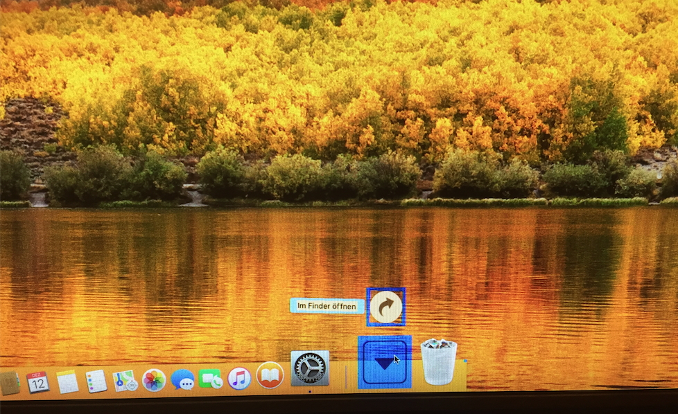

Update: In native resolution the screen has the right color in 10 Bit, but some minor color bug's are still there:
macOS 10.13.2 (17C88) with Nvidia web driver.
8 Bit mode on the other hand has no issues.

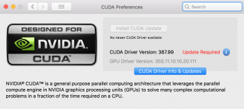

FYI - there’s currently a bug with the CUDA driver and OS X Native driver being unrecognized (when selected via the NVIDIA Web Driver Preference Pane). Some issues I’ve run into lately are because of this. Reported to NVIDIA and they’re working on a fix.
^^^^Hmm, never heard of this. I don't have this issue.
Lou
This CUDA "update required" is what I asked NVIDIA about. Expect a fix in one of the next versions. mac OS 10.13.2 (17C88) with CUDA Driver Version 387.99 and NVIDIA Web Driver 378.10.10.10.25.102. Only happens when booting with the native OS X Default Graphics Driver.
