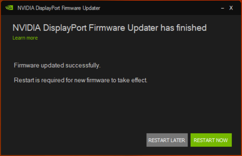

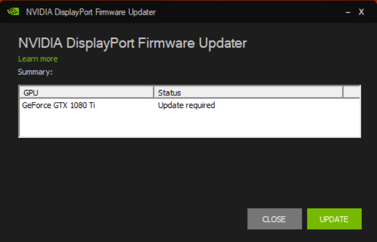

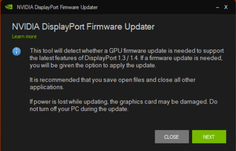

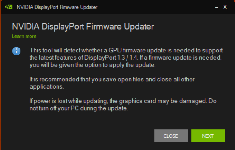

Nvidia released a firmware update tool to enable the latest DisplayPort 1.3 / 1.4 features: https://www.nvidia.com/object/nv-uefi-update-x64.html
I guess this firmware update would delete the EFI of a flashed card?
Supported cards:
NVIDIA TITAN Series:
TITAN X (Maxwell), TITAN X (Pascal), TITAN XP
GeForce 10 Series:
GeForce GT 1030, GeForce GTX 1050, GTX 1050Ti, GTX 1060, GTX 1070, GTX 1070Ti, GTX 1080, GTX 1080Ti
GeForce 900 Series:
GeForce GTX 950, GTX 950Ti, GTX 960, GTX 970, GTX 980, GTX 980Ti
GeForce 700 Series:
GeForce GTX 745, GTX 750, GTX 750Ti
Quadro Series:
Quadro GP100, Quadro P6000, Quadro P5000, Quadro P4000, Quadro P2000, Quadro P1000, Quadro P620, Quadro P600, Quadro P400, Quadro M6000 24GB, Quadro M6000, Quadro M5000, Quadro M4000, Quadro M2000, Quadro K2200, Quadro K1200, Quadro K620, NVS 810

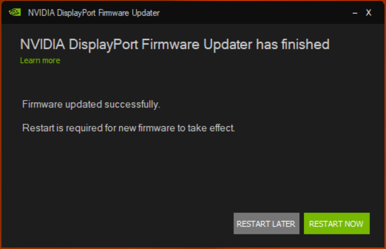

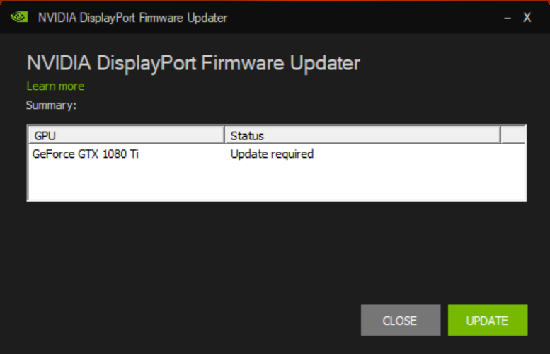

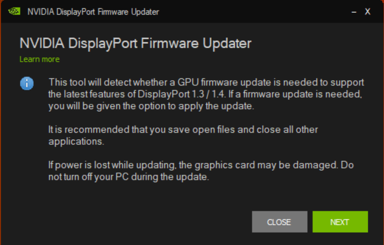

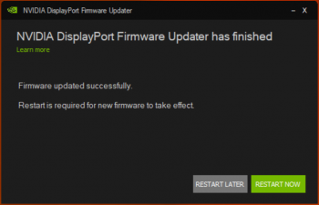

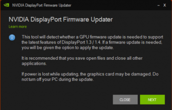

View attachment 765444 View attachment 765445
Thanks for the info. Even though I've been to their web site many times these few days due to Windows 10 installation. I completely miss this one. Thanks!
And my answer is YES, overwriting the graphic card's firmware with the stock ROM image will definitely remove all Mac EFI part.

I updated the firmware successfully on my non-EFI vanilla GTX 1080 Ti.
I did not know that Maxwell cards are capable of DP 1.3/DP 1.4. The Nvidia firmware update suggests that this could be possible.

Update: It's just a compatibility update: https://hexus.net/tech/news/graphics/119090-nvidia-firmware-update-supports-g-sync-hdr-monitors/
Quote: This tool doesn't update the graphics card Vbios or Mbios, just the firmware for the UEFI GOP. It will re-apply your current video bios during the firmware check. In tools such as GPU-Z you will not see evidence of the change.
Can confirm this does not alter the card BIOS having just run it on my GTX 980 Ti.
