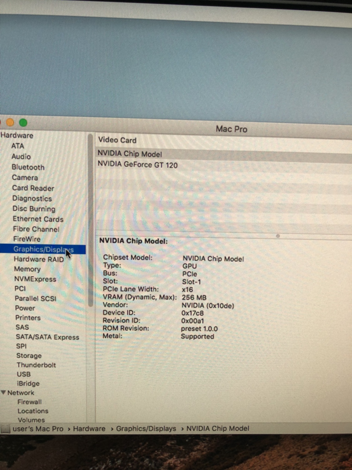

Ok got recovery to work. Enabled SIP and enabled gatekeeper. Nothing is showing in security. GT120 shows fine and gtx980 still shows as nvidia chip . Anything else to try?

[doublepost=1530492987][/doublepost]Ok Did PRAM reset. rebooted. Switched to nvdia driver and ran sudo nvram nvda_drv=1 rebooted again.

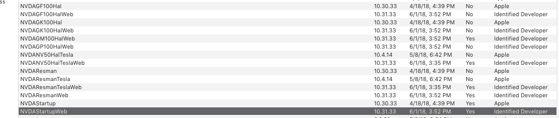

list of loaded nvda extensions
Graphics cards are still not reporting correctly.

do i need to remove 980? or i can just do it with 980 still installed?

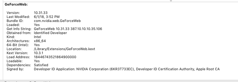

The GeForceWeb also loaded?

I've noticed that the Get Info strings under the Extensions for NVDAStartup and NVDAStartupWeb are different, could this be an issue?
GeForceWeb:
Version: 10.31.33
Last Modified: 2018-06-01, 3:52 PM
Bundle ID: com.nvidia.web.GeForceWeb
Loaded: Yes
Get Info String: GeForceWeb 10.31.33 387.10.10.10.35.106
Obtained from: Identified Developer
NVDAStartup:
Version: 10.30.33
Last Modified: 2018-04-18, 4:39 PM
Bundle ID: com.apple.nvidia.NVDAStartup
Loaded: Yes
Get Info String: NVDAStartup 10.30.33 355.11.10.10.35.101
Obtained from: Apple
NVDAStartupWeb:
Version: 10.31.33
Bundle ID: com.nvidia.NVDAStartupWeb
Loaded: Yes
Get Info String: NVDAStartupWeb 10.31.33 387.10.10.10.35.106
