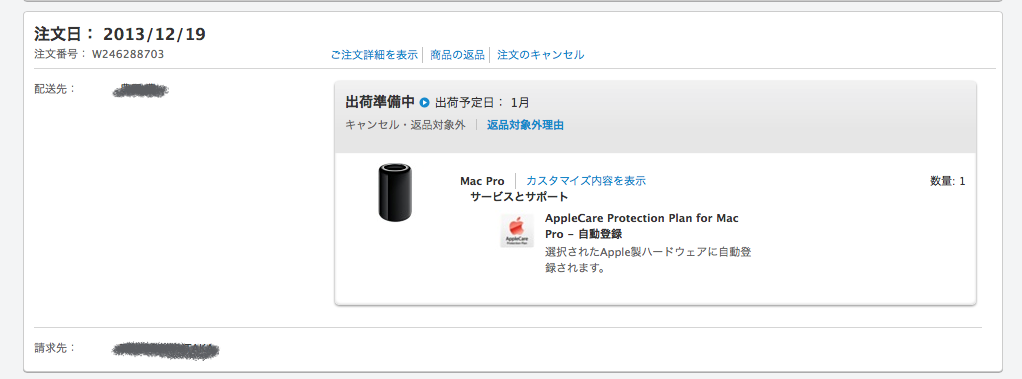

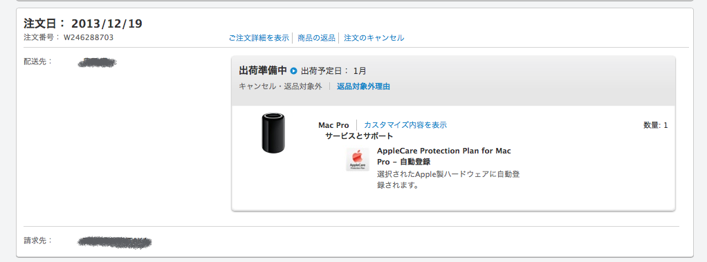

Finally
I posted to the wrong thread. I'm sorry.
