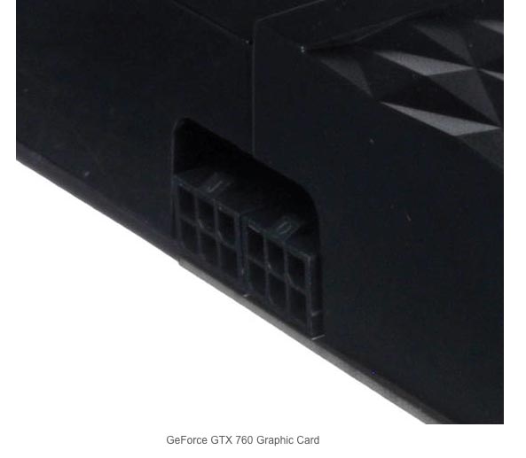

Hi all,
I just ordered the EVGA GTX 760 SC 2GB for my Mac Pro 2008.
The box contains a dual 4 pin molex to 6 pin cable.
I have a mini 6 pin to 6pin cable and a 6 pin to 8 pin adapter.
Here are my thoughts on powering it.
The card asks for 170W, so it will use the 75W from the PCI-e connection and i am planning on connecting a mini 6 pin to 6 pin and then to the 6 pin to 8 pin cable adapter for the 8 pin connection on the card. This should give the additional 75W to the card. Until now I have the 150W. So, I m thinking on using the second drive 4 pin molex to provide these extra 20W. Can I split a single 4 pin drive molex with a Y splitter and then connect the dual 4 pin molex to 6 pin cable to give the additional 20W to my card through the 6 pin socket?
I am thinking of something wrong?
ps. I would like to leave the second mini 6 pin socket of the motherboard free
Thank you!

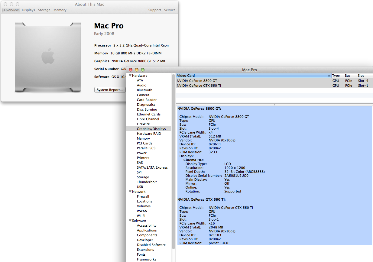

issues with 660 Ti and Mavericks 10.9.2
have been using a 660 Ti for about a year in an early 2008 era Mac Pro. It is in slot one, my stock ATi 8800GT is in slot 2 and this worked fine until... 10.9.2 update it seems.
Since then I've been bogged down with crashes left and right. 15-20 restarts in a row until I remove the card. Left it sit there with no power to the card, out of the slot for 3 days. The machine starts up, but won't see the 660 Ti no matter what I do; zapped PRAM, ran Disk Utility, updated to WebDriver-331.01.01b07, CUDA version 5.5.
As I'm doing a bunch of Davinci Resolve work, I need a working GPU to get anything done.. if anyone can help, it would be greatly appreciated!
Thanks!
I appreciate the help. Problem seemed be stemming from the physical placement of my existing GeForce 8800 GT card. [Apple OEM from 2008, which I've had to bake in the oven a few times over the years] > http://www.youtube.com/watch?v=_NGODs_waoI
I pulled everything out, then started with the 660 TI in slot 1. Got an Apple startup screen with the 331.01.01 webdriver. After that I tried putting the 8800GT in slot 2, which made the machine just reboot over and over. Moved it to Slot 4, got a happy mac, checked to see if both cards were present, then put the BlackMagic Decklink and finally my eSata card.
So far, so good. *fingers crossed*

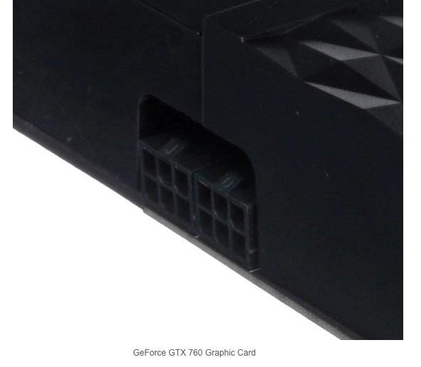

If I want to install windows and run some games via bootcamp, do I insert my original GT 120, install windows, install all drivers (including the GT120) from Apple's driver setup, then uninstall the driver, put in the new card and install Nvidia drivers for my 660 GTX?
^^^^It takes two six pin power cables. No adapters necessary.
