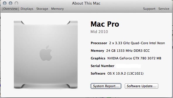

^^^^You did install the Security update correct? And your OS now reads 13C1021?
If so, there should be no issues.
Lou
^^^^Truthfully, I have no clue:confused: My GTX 780 is running flawlessly. Does you card have EFI? What port are you using?
