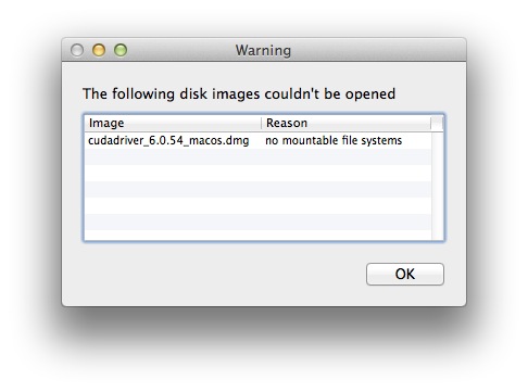

DMG (30.9MB) is still corrupted

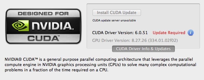

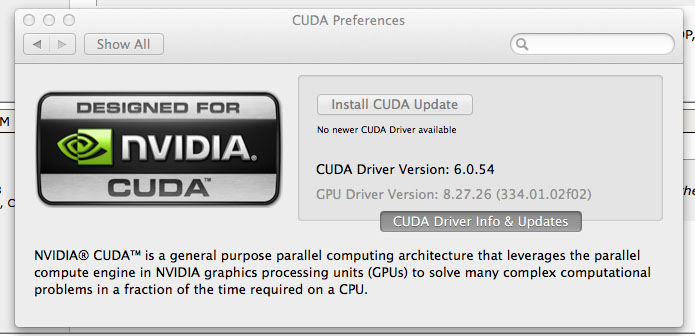

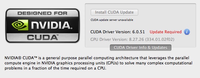

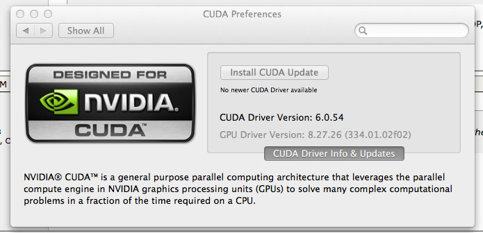

I'm getting an update needed box every time I boot into os X, even though I have the latest CUDA drivers. The latest driver came out on 7/29 and it is the one listed that I have installed. Any way to make it go away? I've told the Nvidia preferences not to check for updates and it didn't help.
^^^^You don't have the latest Cuda Driver. Scroll up this page and look at my Post #1479.
