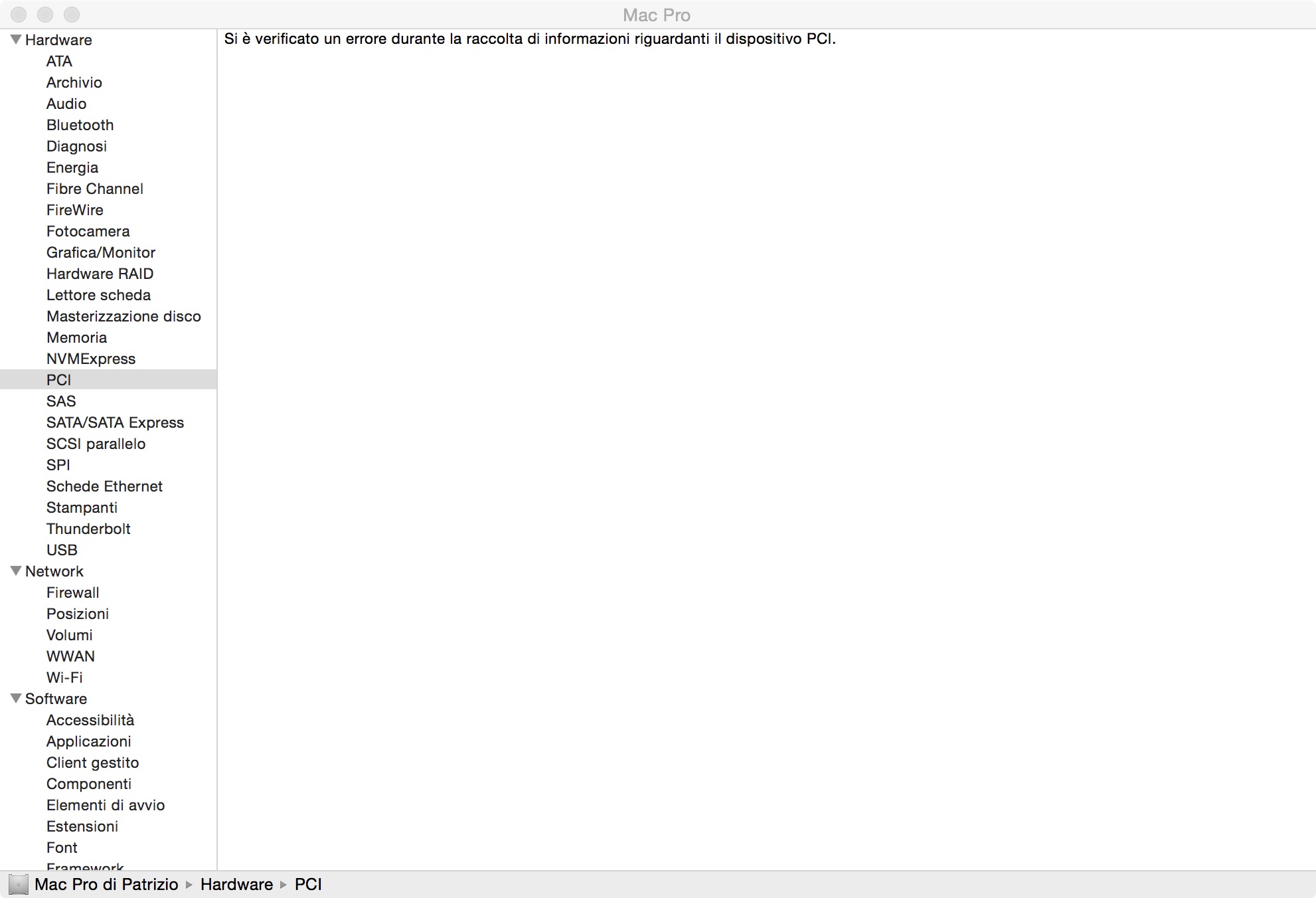

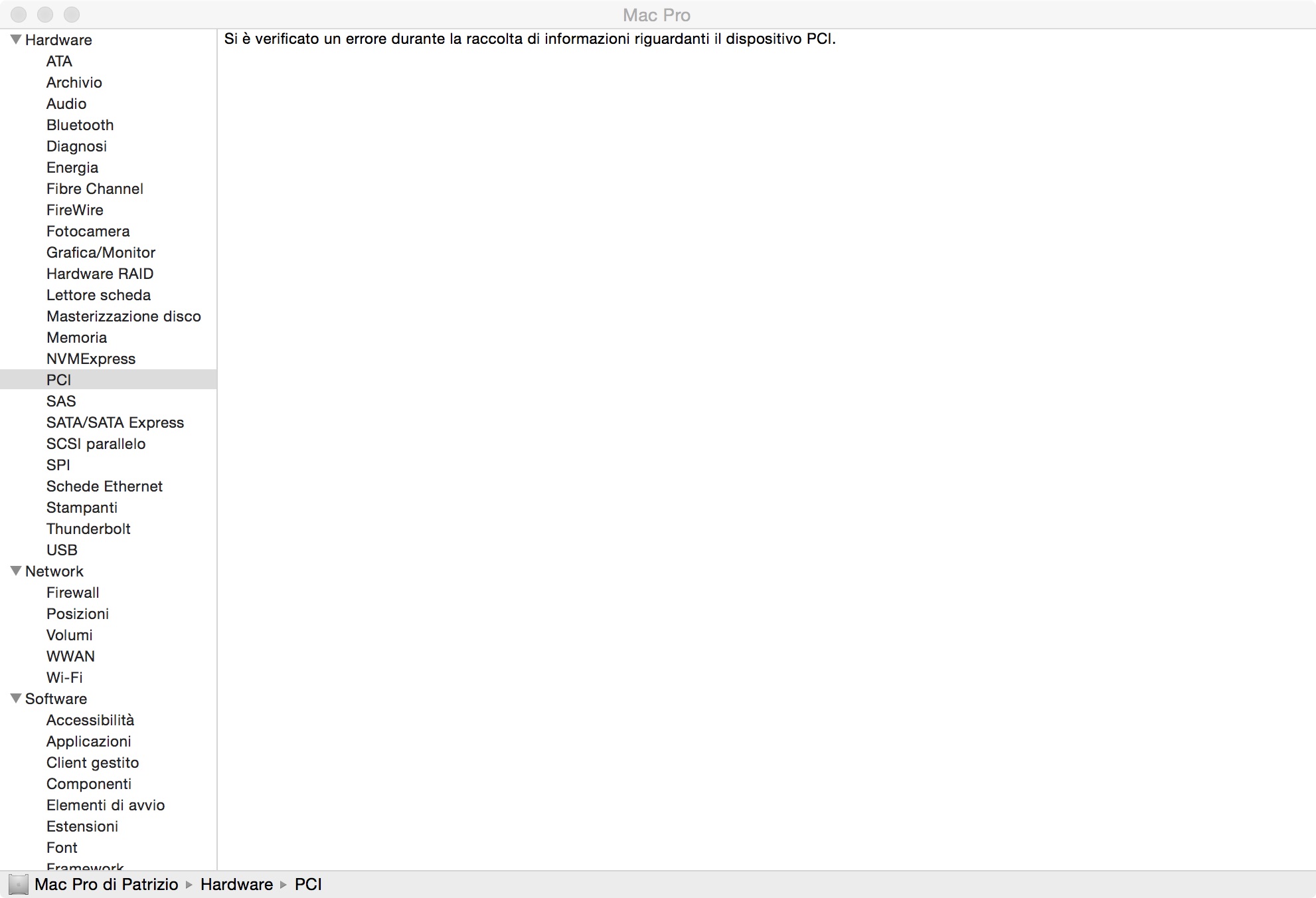

Sorry, a question: in Hardware/PCI I have this error message, is it normal? (I have a GTX960 4 GB) on Yosemite 10.10.5
^^^^I don't understand Spanish, but I'm assuming your running a PC GPU without and Apple EFI. If that's the case, then yes the message is normal.

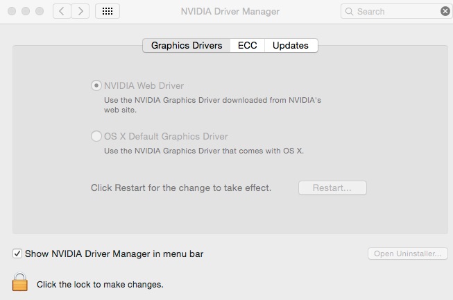

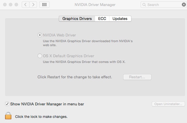

Listers,
I have a MacPro 2,1 running 10.10.4 and an EVGA GTX560. I recently caught a EVGA GTX750Ti FTW ACX model with 2 GB GDDR5. I have the appropriate nVidia Web Drivers and Cuda for 10.10.4 (and know the Maxwell architecture requires the nvidia drivers to boot). I powered down, changed cards and upon restart I get the chimes, black screen and then nothing else...the something else being where it lets me login.
Powering down and popping the 570 back in and powering up...everything works as normal chimes, black screen and finally login screen. The only difference between the setups is the 560 has two 6-pin ports that I power off my motherboard's mini 6-pin ports. The 750Ti has only one 6-pin on the card itself. To me, that means it draws less power and doesn't require any additional than that provided via a single 6-pin. I have tried both motherboard ports to 6-pin with no change.
The fans spin up and after 3 swap-outs I'm confident everything is seated properly...what am I overlooking?
Thanks,
-Saint
The only thing that I can think of is that you have the Nvidia web drivers installed but not enabled. Try entering the following in to Terminal and try again with your GTX750Ti.
BTW, yes, one of the motherboard mini PCI-e power cables should be enough to power your card.
Code:
sudo nvram boot-args="nvda_drv=1"
Code:
In absence of trying that earlier (I will likely resort to it after I go for a run). I went into System Preferences / NVIDIA Driver Manager to verify they were enabled and locked the settings. So, in my mind, it shouldn't be allowed to change and each time I pop in the 560 and start-up the web-drivers are enabled.
Yup. Looks like they are enabled... Don't know why your screen remains black... Have you tried enabling screen sharing to see if you an connect from another computer to see if OS X has indeed completed loading?
