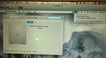

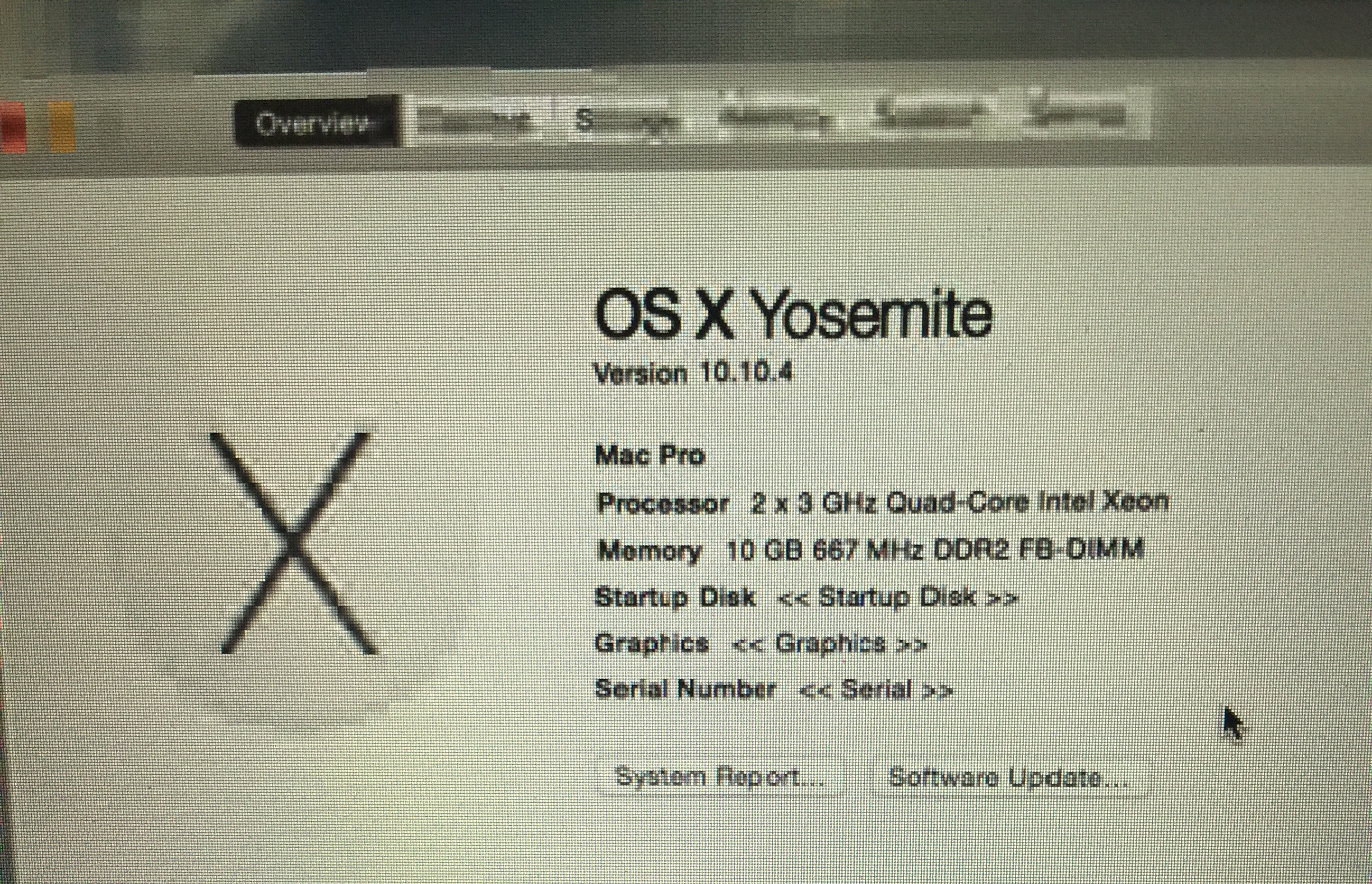

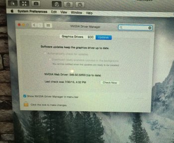

Okay, Screen Sharing Confirms it is up and running. I have also tried a small TV via HDMI and nothing. I'll need some hand-holding from this point forward. The NVIDA Web Drivers are running, everything is current for my OS, it seems disconcerting it isn't returning something more substantial on the System Overview Screen but I am at a loss as to what my next step should be...go team mac gurus!!!
Also, I purchased this card new from NewEgg and can return it (if I do so in a timely fashion) but if I can make it play nice I would like to keep it. I would call their tech-support but fully expect to get rebuffed when I tell them I stuck it in an unsupported mac tower.
Thanks!
-Saint

It appears MacVidCards was correct about some GTX750s not working properly. Based on the screenshots you posted, you've done everything correctly and it should be working.
At this point, it's probably best to return the video card and try to find another model known to be working. I agree, I wouldn't bother trying to contact tech support.
