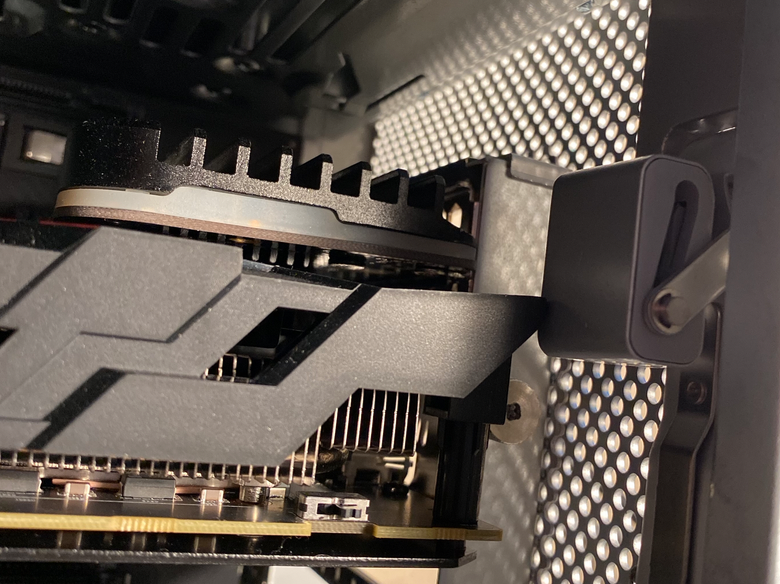

With Powercolor Red Dragon Vega 56 installed in slot 2, you will have dremel or snip out a little bit of plastic out of the Red Dragon shield / cover (see pic). Otherwise you won't be able to flip the cover lock back in place (a.k.a lock the side plate). It's not that much, probably done with some mechanical cutter tools too, no need to dremel.

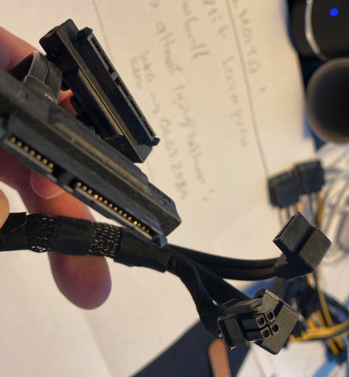

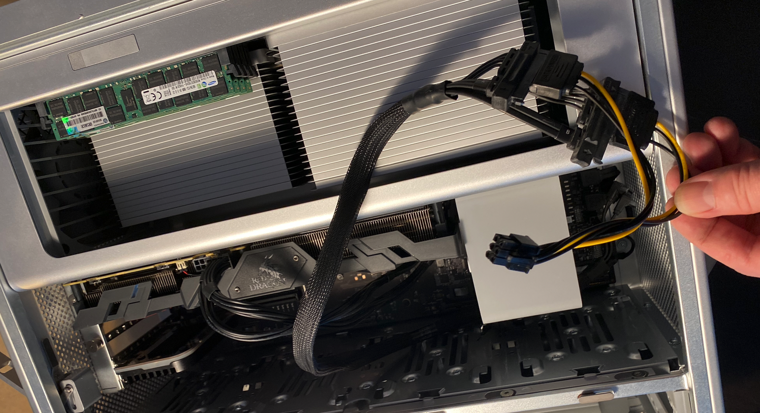

I still haven't received the cables from China I have ordered a month ago or so. I had an optical drive cable at hand from my ongoing project, so I used that for the above mentioned mod. I also ordered another cable from powerbook medic (30€) for spare. This way you can power a Powercolor Vega 56 (low bios) in Mac Pro 2009-2012 and close the side panel, because the cables are not in the way. You could tear Mac Pro down and route the cable this way, but if ypu have a cable you can just leave the original there, no need to take Mac Pro apart first.
So it's just another way of accomplishing external power for a power hungry GPU. I'm waiting EVGA powerlinks to arrive, but needed the card to work today already. And I wanted my side panel closed, that's why I used this trick.
There are some considerations I just realised doing this. These Apple cables are of AWG20 size. Optical drive bay is fed by 5V and 12V voltages. There are only four pins in the cable.
So I am drawing all of the 6-pin power to my card from just one pair of AWG20 wires. I am wondering if there is any benefit of using double SATA power splitter in my case? Maybe there is, maybe the extension cable quality makes a difference too. What do you think? Would single SATA to 6-pin power be just as safe as double SATA to 6-pin in this configuration? Extension cable reads AWG18, and seems a little bit thicker than Apple part cables.
