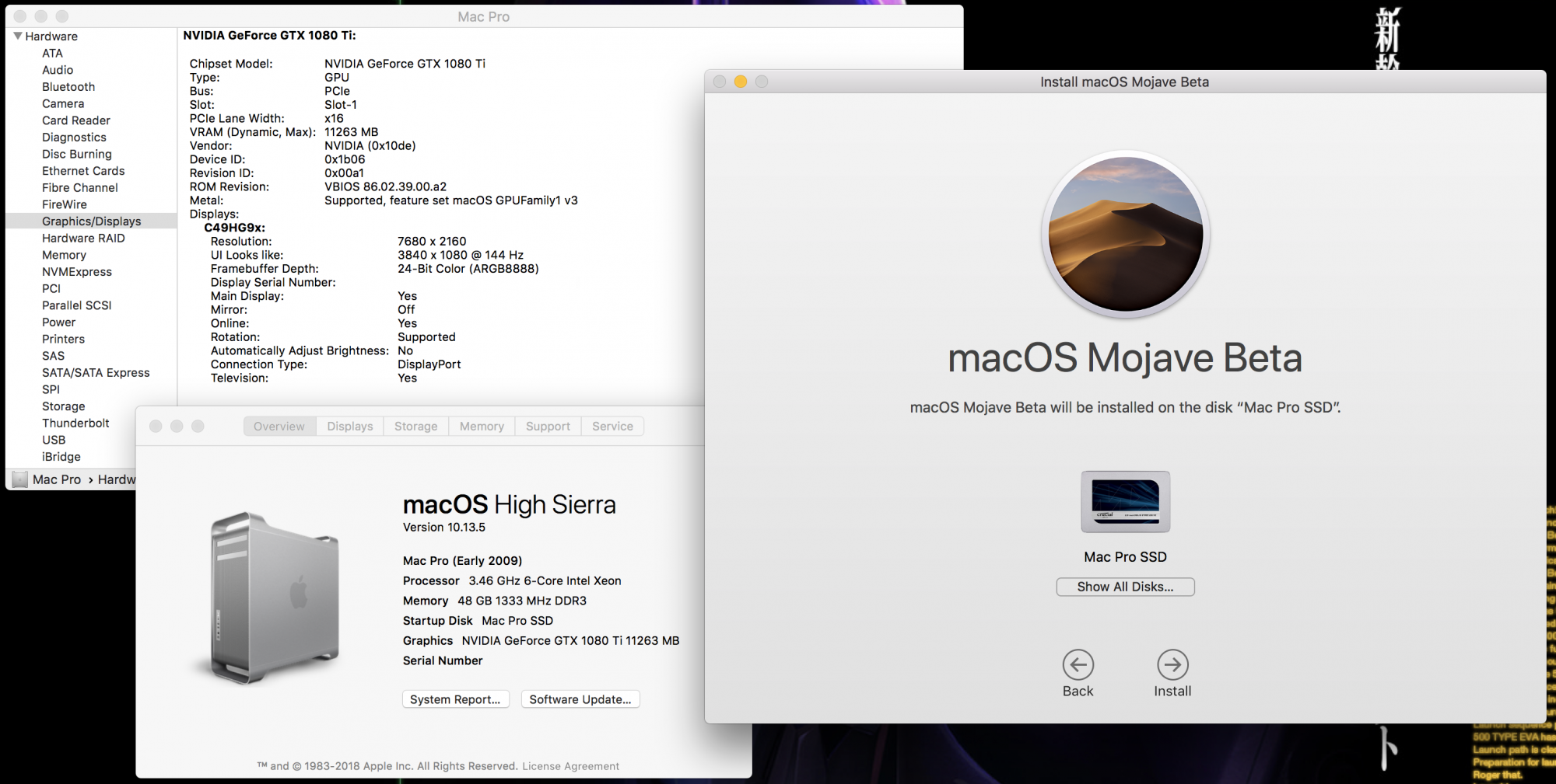

I have a 5,1 running High Sierra and a Nvidia 980ti. Is it possible to jump to Catalina via Open Core with a 5700XT, or would I need a Metal capable card supported in HS/Mojave to do the Open Core install?
I have the Apple 6 pin cables running into the 980ti via a EVGA Powerlink and have not had any Power or shutdown issues. Can I run the 5700XT this way? Do I need 6pin to 8pin adapters? I believe the extra 2 pins are not necessary with the EVGA Powerlink. So we do not need to do a Plexus mod to run a 5700XT Anniversary Edition?
It's fine, tested since Mojave beta.
HOWEVER, you have to think about how to do that in correct order.
e.g.
1) Install OpenCore with VMM flag ON
2) Install Catalina with 980Ti (expect nothing to display. So, better have remove control setup)
3) shutdown -> remove 980Ti -> install 5700XT
4) boot Catalina with 5700XT which able to display boot screen and accelerate.
5) turn off VMM flag
If I were you, I will do that with a backup boot drive. If anything goes wrong, then remove it, and boot back to HS with 980Ti.

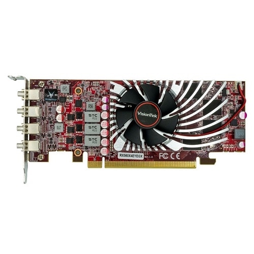

For anyone interested, I can confirm that the Radeon Pro WX 4100 is fully supported up to 6K resolution on Mac Pro 2008 3,1 in Mojave 10.14.6. (using Dosdude1's installer and the SSE emulator patch).
It's an excellent option for ~$110-$180 used, as it gives 4 mini-DisplayPort in a single-slot form factor; which is great if you don't want to lose an extra slot for a second GPU (I have it in slot 3 @ x4).
It plays quite nicely with a Sapphire Pulse Radeon RX 580 (mine is in Slot 1).
Only catch is most of them (WX 4100) come with a low-profile bracket/card, so you'll have to kick another ~$10-$12 for a high-profile PCIe gate bracket, specific to that card (eBay).

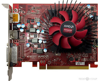

So as a stopgap measure, I was thinking about installing a low key RX 560 for macOS and use the Titan X for Windows.
In particular these two RX 560's caught my eye since they don't require additional power and take up only one PCI slot:
Is this a feasible solution, having dual video cards in one cMP? (and if these particular RX 560's are compatible)

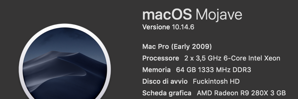

I have a 5.1 cMP (flashed from 4.1 to 5.1 with latest bootROM), Mojave with a flashed Gigabyte Radeon R9 280x.
It is a good gpu but i have a very big issue with it: My cMP stucks at chime if i leave connected the minidp->dp cable to my Samsung 4k monitor. It is very weird... basically to start the system, i have to:
1) unplug the minidp cable from the cMP
2) wait more or less 30/60 seconds
3) plug the cable
and everything works fine. If I forget the cable, nothing will appear on the screen and the only thing that i can do is force the shutdown. I have also installed opencore but nothing changes.
Any ideas?
