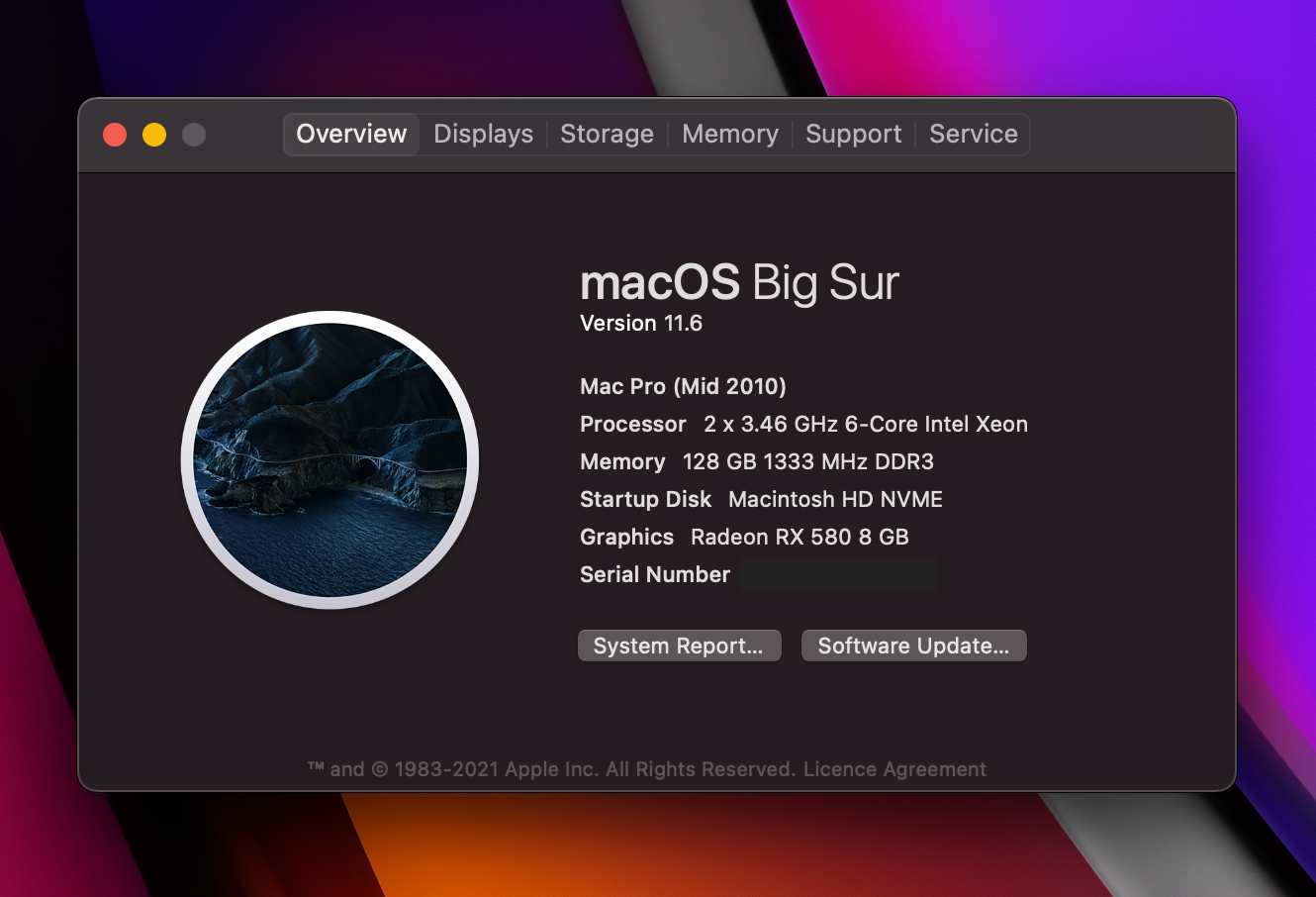

Okay, I can add that XFX Radeon RX580 GTS XXX Edition 8GB card does work on Mac Pro 5,1 2010 with Mac OS Big Sur 11.6 using Opencore / SurPlus.
Power through dual mini 6-pin to 8 pin power connector.
I had the recommended Sapphire Pulse RX580 8GB in this computer before. I just swapped the cards over quickly to test this one. It will go in the other MP5,1 when the faster CPU arrives. I'll keep the XFX card in the computer above until then and see how it goes. So far no problems - it just worked straight away.
