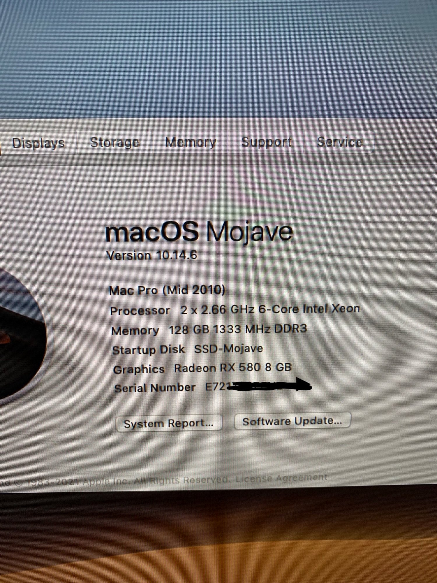

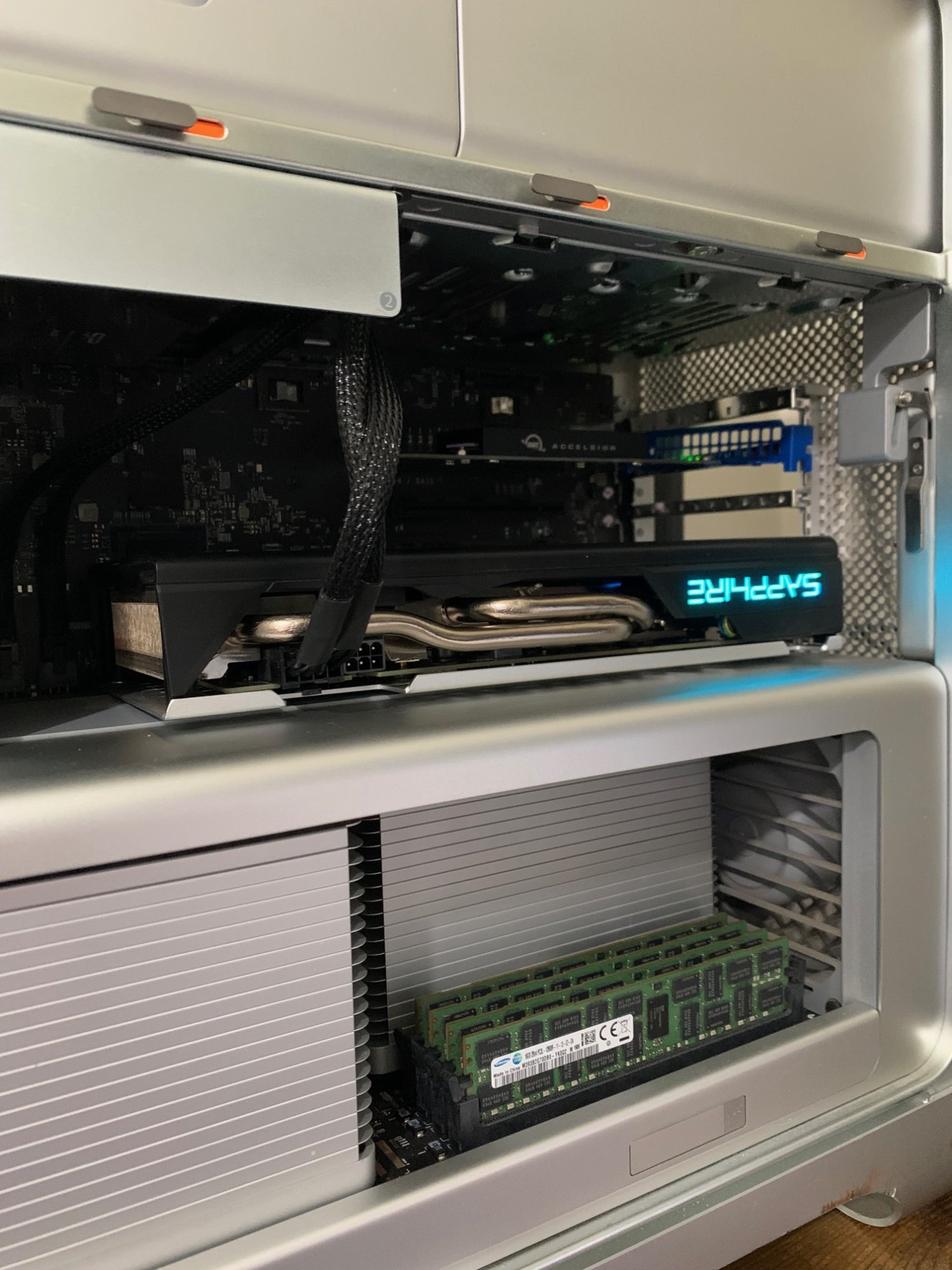

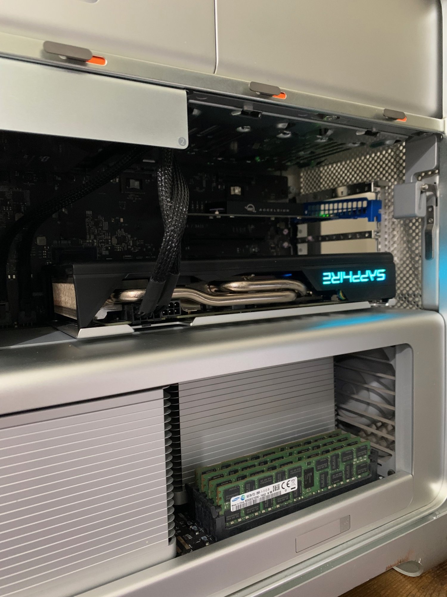

Mini 6-pin to 8 Pin cord arrived this AM. FINALLY, RX580 (Brand new) unflashed is driving 4 x monitors in Mojave. Now to figure out some kind of boot screen and install the faster CPUs once the thermal paste arrives.
crusetech
macrumors newbie
Dec 20, 2022
29
17
I can't believe it... Ventura up and running with all monitors active. I'm giving up while I"m ahead and before I break something :)
I think you better connect the 6pin as well. Sapphire changed their mind, and remove that "6pin is optional" in the card's spec.
I don't know the reason behind. May be only the newer card has no such option (but the older card still have). Or users reports showed that pre-mature failure may occur if leave that 6pins open.
it's been running all day. Found a nifty App called GPU Monitor and then ran the Heaven benchmark. Needless to say I just ordered the pixlas mod components :) May as well. The App reported almost 350W being pulled from the Card. Averaging 93W Consumption at Idle.
One item to mention. The cable I used was a dual mini-6 pin to 8 Pin. Regardless, I will pixlas the PS.
For info, that number is erronous, you better ignore that.
If you want to know the power consumption, monitor the PCIe slot + Booster A & B's current.
e.g. PCIe slot 2.5A, Booster A 3.1A, Booster B 3.3A.
Then (2.5 + 3.1 + 3.3) x12V = 106.8W
I did some study here
From the screen captures, you can see when the RX580 draws about 225W, that "Total Power" reported 393W.
When it draws about ~185W, that paramter showed 345W.
Both numbers are way off, and outside the spec (my RX580 is the PULSE, no mechanism to let it draw 393W)

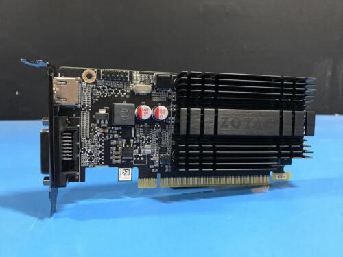

I have to say, I was literally searching for FIVE HOURS STRAIGHT the other day... and finding a metal compatible card for my 2009 Mac Pro (which thinks its a 5,1 2010) to run Mojave is an absolute **** show... unless you want to pay ~$150 USD for a video card (where I can buy an ENTIRE 2012 Mac Pro for literally $200 by me...).
Sure, I've found other cards, which are around what I want to pay (maybe $50-70ish), LOTS of them, which say they *might* be compatible... but when I google the exact model (since there seems to be... oh, literally 80 different versions of EACH card by multiple manufacturers all with slightly different names... of which I can commonly find ZERO instances of that exact card name with "metal" or "mojave" via google search to confirm it'll actually work... and with so many eBay sellers offering NO returns, that is not something I would risk that money on...
So, long rant short, I use my 2009 Mac Pro in my garage is a headless media server most of the time (although there is technically a monitor hooked up to it), so do NOT need anything video-wise besides going through Finder windows, but DO need Mojave functionality... Does anybody know of any current GUARANTEED WORKING metal/Mojave-compatible cards on USA eBay right now I could buy (under ~$70), WITH an option for return, just in case?
Any help would be appreciated... My funds are limited (after buying a 2023 Mac mini since my 2012 died...) so I can either juice my ancient Mac Pro server (Mojave seems to fix my file sharing issues High Sierra has), or literally buy a new $599 Mac mini + ~$499+ TB3/4 4-Bay 3.5" HDD enclosure (new spec everything is required for fast transfer, unfortunately, since NO Mac supports USB 3.2 2x2 which I could get a WAY cheaper enclosures for) ...which I do NOT want to have to charge that craziness to my credit card... (just trying to limp by for a few more years).

Thank you for the link. First is OOS on eBay. I did search for "zotac geforce gt 710 zone edition 2gb" and those are around ~100-125 shipped... Did another less specific search and found this one for $60 shipped - think it'll work? Not listed in the description as "zone edition", but the sticker says it is! (found cheaper ones with 1GB... but assume the 2GB is key).
This post seems to be hopeful for the Zotac 710 so think I should give it a try?
2nd one, the GT 630 "684455-002 702084-001 B4J92AT" google says "it isn’t recognized by the Mojave installer as a metal card" - and the entire point of this is to install Mojave (AND I guess I should add, not have to resort to OpenCore type stuff), so I guess that one is out unless I'm missing something.

Forget that. Horrible card for $30, insane for $60.
It's the same for all NVIDIA Kepler GPUs and MacPro5,1, including the GT 710. You need to install Mojave from High Sierra - booting from USB won't work since the USB installer fails to detect any NVIDIA card as METAL supported.
Get this one, even if you have to buy from AliExpress.
