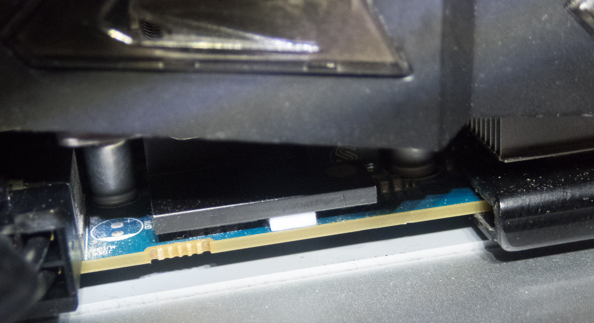

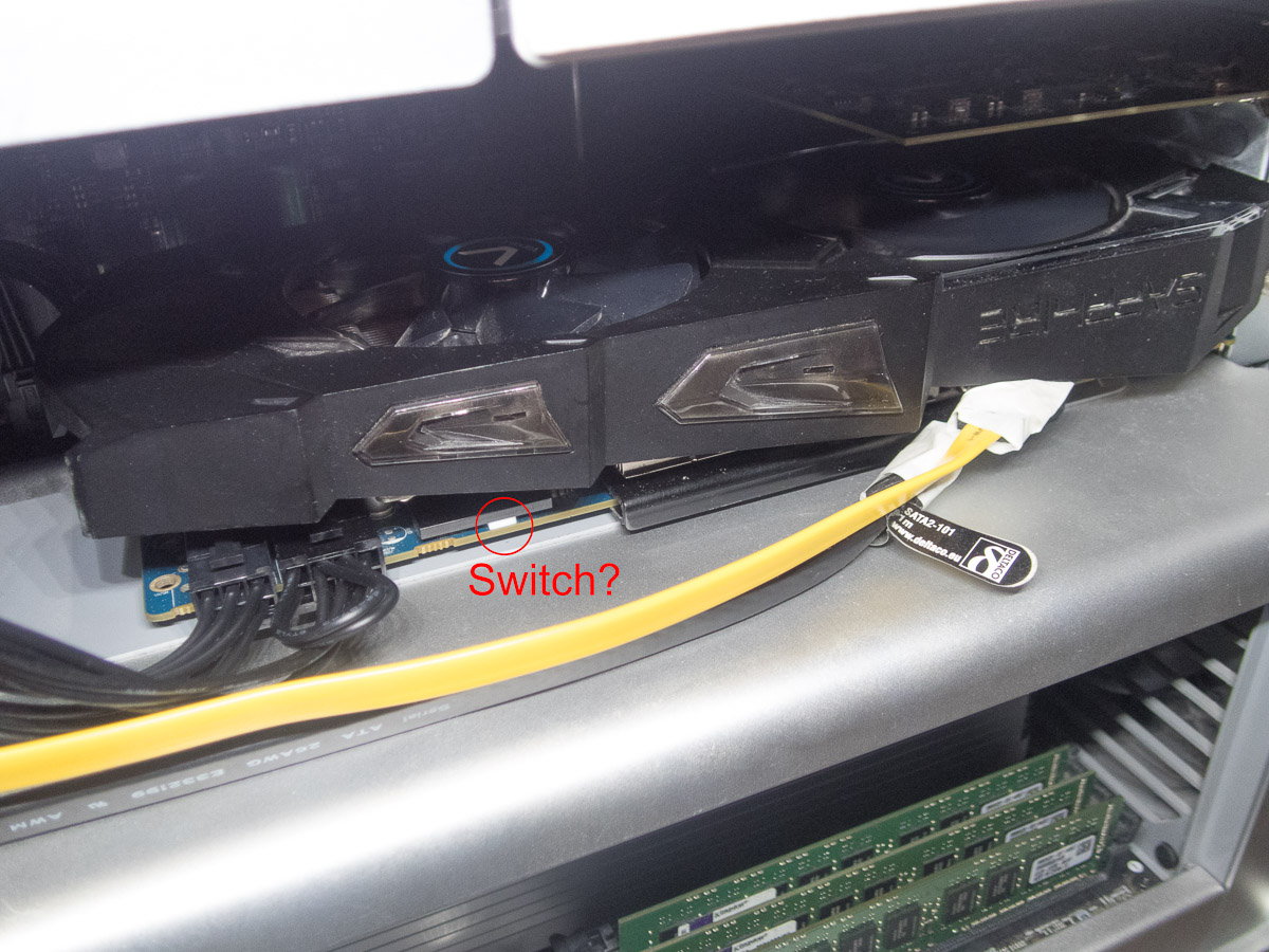

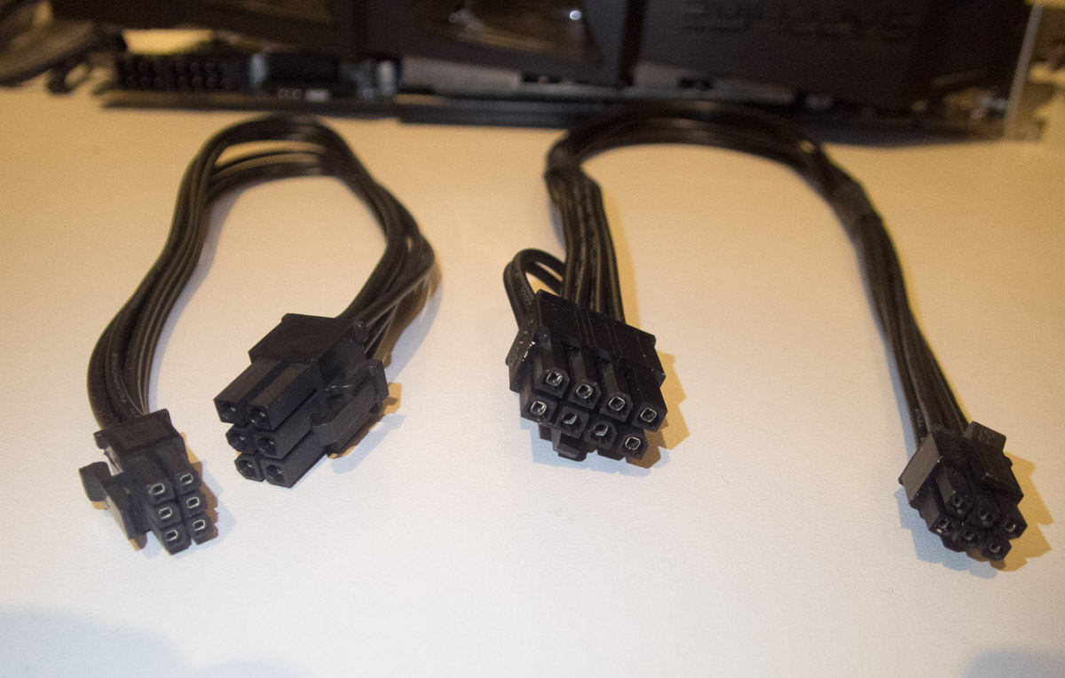

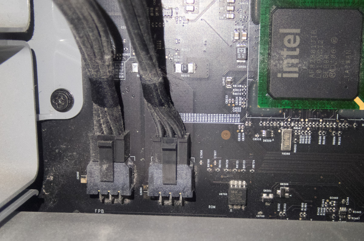

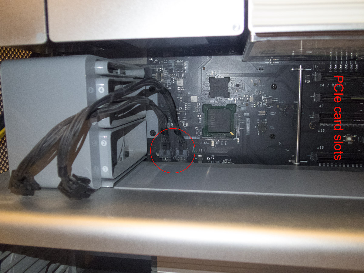

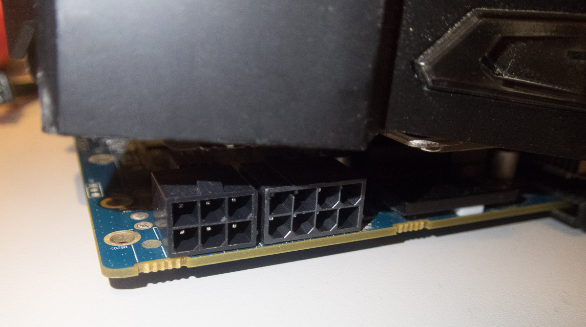

A couple of things along with photos I'd like to share with anyone else looking into getting a Sapphire Vapor X HD-7950 (3GB) GPU card....
First, the card has two power connectors: one 6 pin and one 8 pin. My cMP 5,1 has two 6-pin connectors on its motherboard, next to the PCIe fan, so you need to get the right cables as shown here:
h9826790 mentioned in post #951 that this card has a dual ROM design. I believe I read somewhere that there's a switch for this. I assume it's the white bit of plastic found here:
I haven't had any sccuess in downloading a manual for this card (if anyone knows where it can be found, please do tell), so how does that dual ROM thing work, and which switch settings do what?
Reactions: crusetech
And yes, the white plastic thing you saw is the only switchable one on the card. It does nothing except tell the PC to load the vBIOS from which chip. Out of the box, both chips contain the same firmware, until a user mess them up.
Can be used as a fail-safe mechanism, or dual vBIOS for dual purposes like switching between OSes, graphic working modes or PCs. Modern cards nowadays use software instead of hardware solutions.
For manual, not the exact one, but similar.
Review
Thanks for the links to the user-manual and review.
Actually that white plastic thingy wasn't the switch like I first thought. I gathered it was a piece of polystyrene from the packaging, but now I think it might even be a thermal pad.
In this posting I was told where the switch was, which I found and tried out. It's a push-button which lights up in blue when you press it in and otherwise doesn't light up.
It doesn't make any difference (as far as I can tell) if I have it in one or the other position.

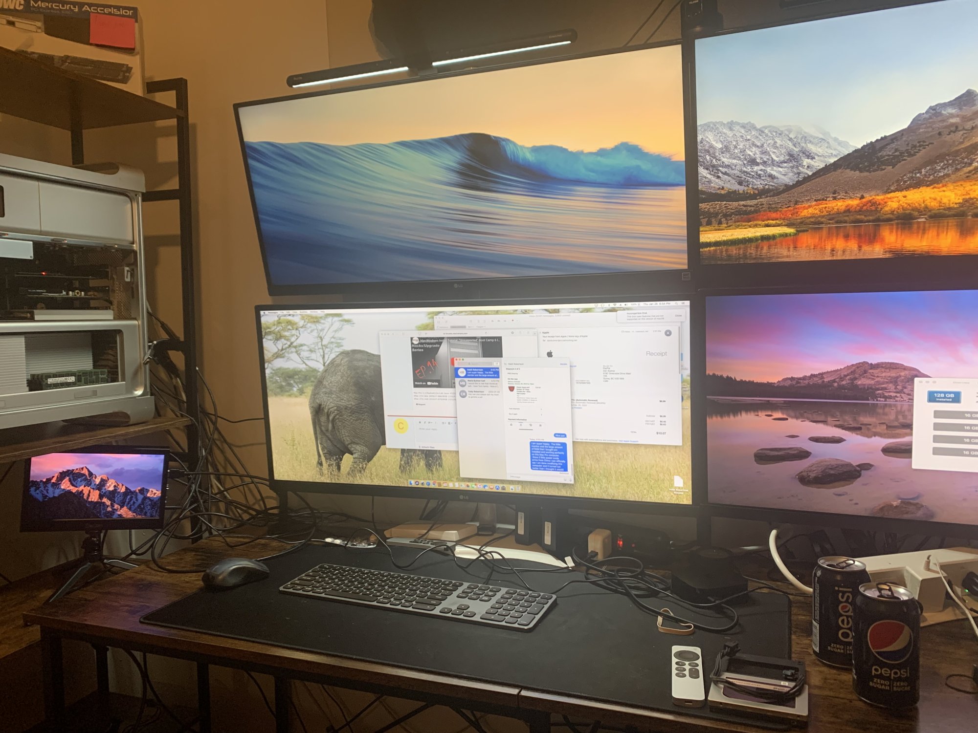

Managed to get 5 monitors hooked up on my CMP 5.1 under High Sierra with the following configuration:
PCI 16x Slot 1 - NVIDIA GeForce GT 120 512MB Stock graphics card feeding the small little 10" HDMI monitor off to the side (I prefer a boot screen as I have multiple drive partitions with Mac OS's installed from High Sierra to Monterey).
PC?I 16x Slot 2 - NVIDIA NVS 510 (which tells me under Metal: Supported, feature set macOS GPUFamily1 v3) running 4 x LG Ultrawide Monitors.
I can't load into any OS higher than High Sierra with the NVS 510 card inserted into the computer. That's where I"m at right now.
I have a Sapphire Nitro+ Radeon RX 580 on it's way which, supposedly is flashed to the MAC EFI and Metal compatible which I 'hope' will allow me to replace both existing GPU's, allow me to have a boot option menu and allow me to have all 5 monitors running successfully under Monterey. When I purchased the NVS 510 I had figured it would have allowed me to do this...

unlike the normal sapphire pulse RX580, you lose slot2 with the nitro+
because of the height of the card, it's not much, but it's enough
Good to know Tommy. As I currently have the two older GPU's this shouldn't be an issue in my case. I"m not a gamer, or intensive graphics user. just need the ability to throw up a few HD Camera feeds.
The problem is mixing the GT120 with the other GPU on Mac OS higher than High Sierra.
What is the mounting system you used....😛
Is it off the shelf or custom build, looks great.
hey Mark, they are dual monitor stands from Vivo that stand on the desk itself. They are plenty sturdy with these LG monitors. I must admit, they are a challenge to initially setup but I love that they don't have to screw to the wall etc.
Reactions: MarkC426
