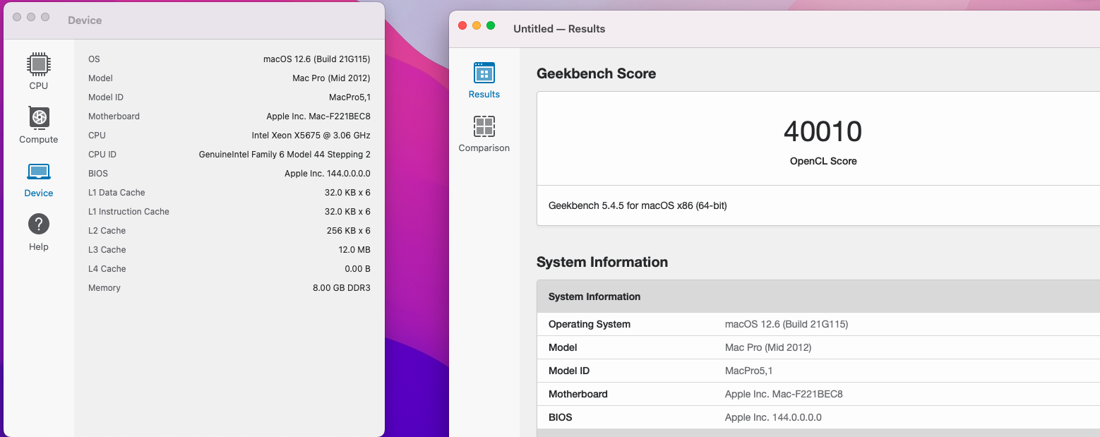

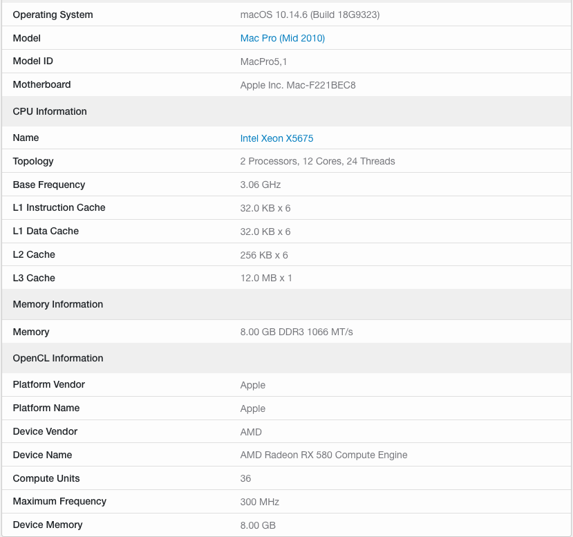

sorry for bothering: took a Geekbench OpenCL-test for RX 580 (Pulse) 8 GB on MacOS 10.14.6 and the score was rather low with 39.000+ points;
a Radeon rX 570 Nitro 4GB the same test but on MacOS 10.13.+ would yield 42.000+points.
My question: is the card RX580 lower in test because it is loaded via OpenCore or what could be the reason?
the same card in Monterey 12.6 would get even lower around 26000+ points.
The Pulse RX 580 got flashed by Professional seller, did not test the card before; the Nitro card was unflashed PC-Version. thanks.

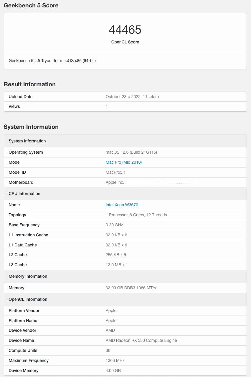

That's peculiar, I just ran it on my RX 580 to see if I could replicate (with everything open, didn't bother closing any of my browsers, Outlook...etc) and got >44,000:

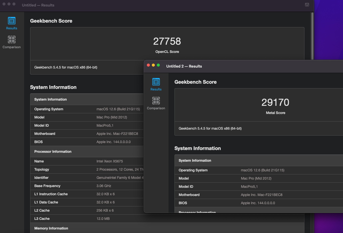

the graphics card is very silent, which is great, but i was hoping that it would yield bit better for Monterey, which is a bit slow on the MacPro5,1 even with faster graphics card.
Metal is 29000 and OpenCL 27000+ for MacOS 12.6

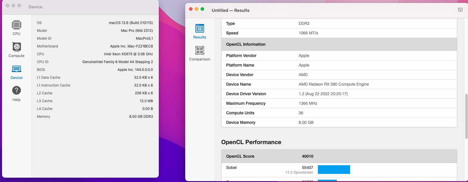

Only real upgrade-option for DualBooting Mojave and Monterey seems to RX Vega 56/64 or Frontier, so i think it might be going for one in the next year, hopefully.

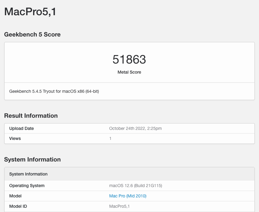

I mean, given the other results shared here, I think something's up with your setup. I find Monterey is the best performing OS I've had on this box.
I just ran the Metal benchmark, and, streaming music to my stereo via iTunes, 56 Chrome tabs open, 23 Firefox tabs open, 8 Brave tabs open, Outlook, Whatsapp, Teams, Apple Maps, Parallels (RDP), Word, Messenger and several finder windows open I still managed to get:

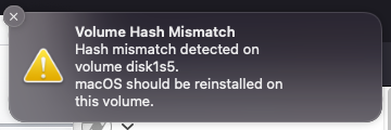

EDIT: well,well,well, speaking of the "devil" ... just got this "image" on my desktop
Ewww, well, that's possibly a hint, lol.

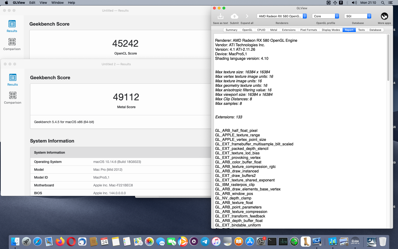

just went into Mojave, and today the benchmarks seems more sober, so i would consider case closed;
thanks for your help;
will report should i reinstall Monterey and get better results; after all, it was one of my first attempt with OC 🙂

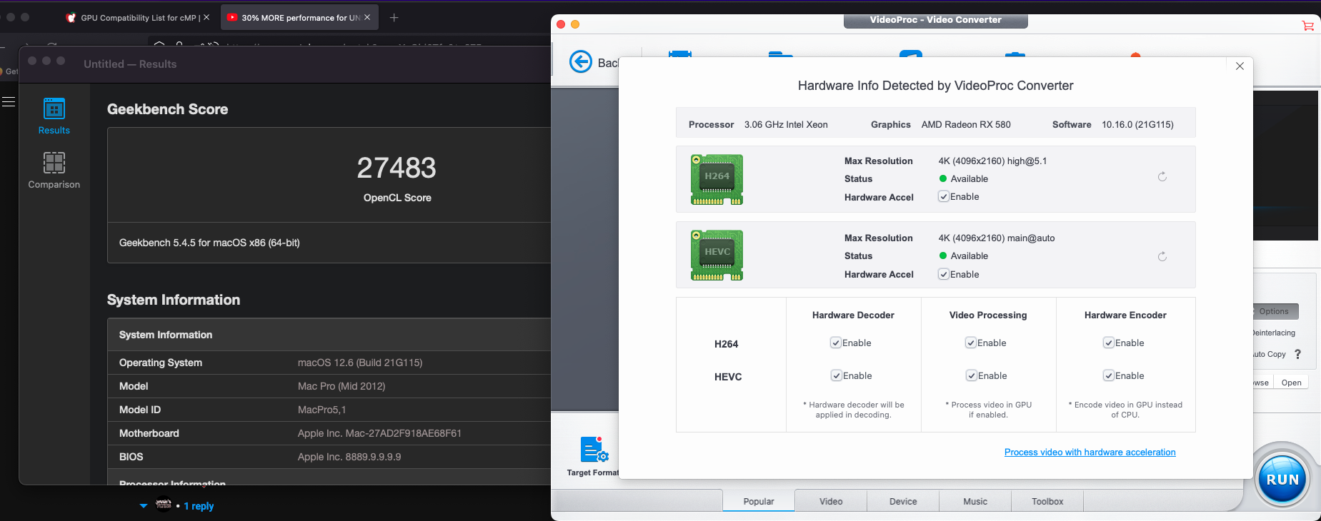

and update to the above post with low benchmark in monterey;
as i got this news update in youtube today, decided, to test it out, and it actually brought back the GPU benchmarks to "normal" eg. levels like in Mojave; hope this is also useful, in real-life 😉
decided to re-install, but it seems that it does just need to edit this setting in OCLP;
don't know if this is easily available for other who dont use OCLP Patcher,

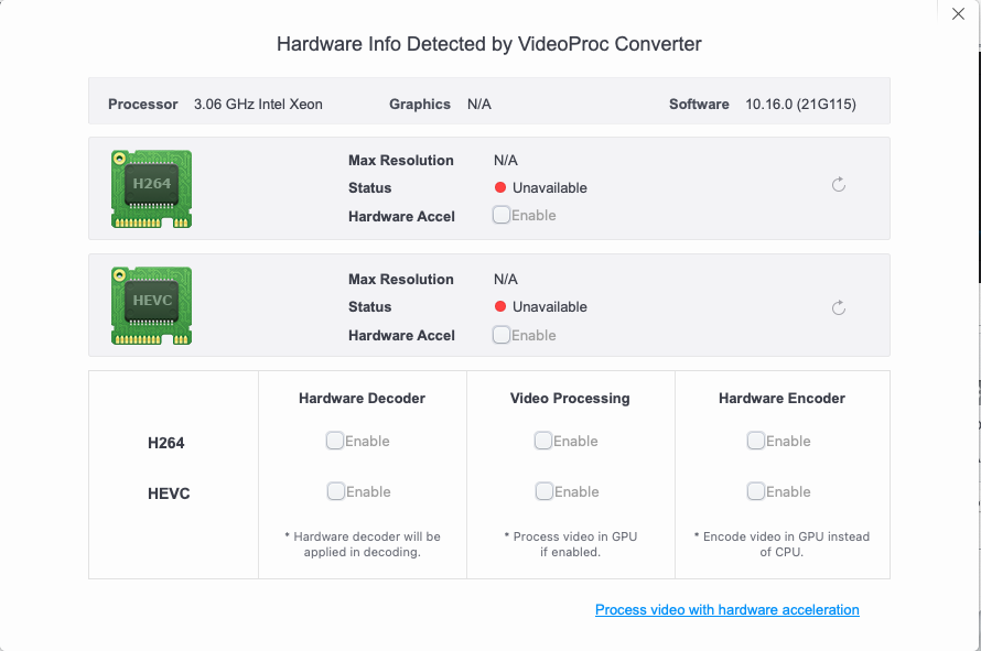

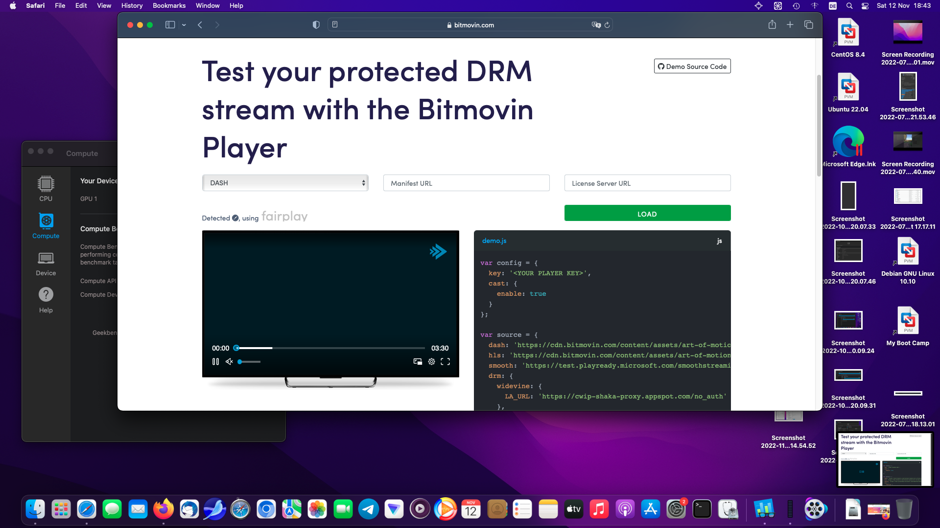

Again this video - try anything that requires SMBIOS spoofing, like HEVC video encoding or Safari DRM, for example.
@tsialex, thank you for your support,
you are right, it is not functioning properly now.
(Videoproc no longer offering HardwareAccelleration, DRM no play in Safari).
Everything that requires SMBIOS spoofing stops working, I really don't understand why someone makes a video that claims 30% more performance if everything that is hardware accelerated stops working and the video doesn't make the adverse effects crystal clear - maybe he didn't even bothered to check anything but benchmarks.
The phrase "Optimizing to run benchmarks doesn't make your workflows complete faster, usually makes it slower" fits like a glove here.

luckily , you could help out , so the "damage" is minor,
my OC is still abit a mess (no regular mac user anymore)
have several OC on my computer, so i could boot into old configuration without changing anything,
and then the benchmark is again around 27000, but video accelleration is back, so most probably will have to re-install and tidy-up.
