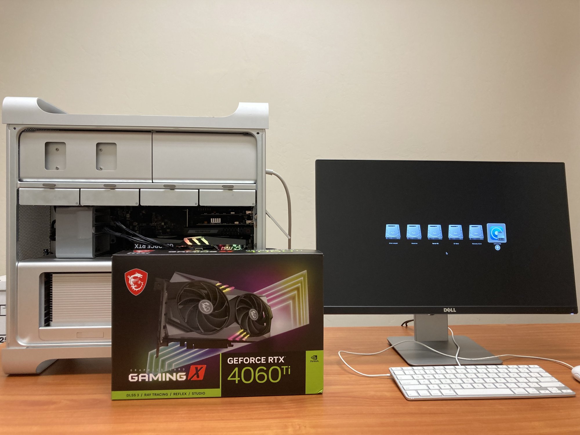

I was able to use dosdude1's ROMTool and DXEInject, as well as OpenCore's EnableGop.ffs file to get past the GPU Firmware block.
This is not correct. There is no firmware block whatsoever, just that NVIDIA GPUs released after RTX 20x0 require UEFI 2.3.1 HII support that MacPro5,1 EFI 1.10 is simply too ancient to have.
EnableGop does not provide HII support, is just a shim to adapt Apple GOP support to the GPU UEFI GOP.
You could have found a RTX 4xxx GPU that does not require HII or have a failsafe implemented to work with older PCs that still does not have HII and kudos for you for your discover, but telling that you magically solved the HII requirement with just EnableGop is incorrect.
At least you are not telling the whole story here.

I've already explained the issue to you previously. Your GPU requires HII support and nothing that you add to the EFI or to the OpenCore ESP or config.plist will make it work. The MacPro firmware fails at POST with a boot loop.
HII is a basic firmware requirement. If you GPU requires it and will not have a fallback, the Mac Pro will not power on correctly, failing at POST.

Sorry I'm late to all of the new responses; had a busy day. Also, sorry for posting my findings in the wrong section at first, still learning the landscape.
Regardless, I wanted to start by restating that this card only works on Windows 11 at this point, not macOS. There's probably no way that this card will work on macOS because there are no current Web Drivers and the ones that exist are too old (3XX where as the current PC Drivers are 551 or something close to it).

@startergo DXEInject is a command line tool from dosdude1 that allows injecting the GOP ffs file from OpenCore into the Firmware.bin file that gets dumped from dosdude1's ROMTool.
@tsialex I honestly had no clue about what you mentioned about HII (I'm not that deep into this yet). I wasn't claiming that I solved that problem; I just claimed to have found a guide and a function that got the 5,1 to POST with a 4XXX Graphics Card, that's it. Is there a way that I can find out if HII is required for this card, or if I'm using a Fail Safe/Fall Back Mode? I'd like to confirm, if I can.
@Supermimmo I didn't realize that HII was a thing and that certain Graphic Cards had it, which prevents it from working at all. Gonna try to get more info on this specific card to see what we can learn.

I should be a lot more careful with your posts, you are incorrectly leading people giving hope for something that we all know that does not work. Adding EnableGop to the Mac Pro firmware does not provide HII support or make it boot sucessfully. Making anything anywhere with OpenCore won't make the Mac Pro magically complete POST with a RX 3080Ti.
I never claimed that doing this method enabled support for the 3XXX graphics cards (I simply wondered if it could work and I don't have the equipment to test it, myself). However, from what you are saying, there is no possible way that this method could work on any 3XXX from any vendor because of HII (I'm sure you and many others have looked into this issue and through that research arrived at this conclusion). I have a working result with one 4060 Ti graphics card and I'm really just looking for additional information as to why it works and whether or not these findings could, in some way, affect the 3XXX series as well. One other person offered to try this method on their 3XXX graphics card because they wanted to. But again, from what you've mentioned, they're not going to get any result, it's going to fail. But by me even having this conversation at all about the 3XXX series I'm getting up the hopes of everyone in MacRumors? I think I'm seriously missing something that I should probably know. I know that there's a lot that I don't know when it comes to this particular issue and that, thus far, there has been no reason to suspect that any fix would work for the 3XXX series, because it probably would have been found by now. I would like your or someone else's help, if anyone is willing, to point me in the right direction to find out what mode my graphics card is running in (a Safe Mode/Fail Safe Mode) to get more information on why this particular 4060 Ti does work.
I would like to know, are you expecting me to not talk about the 3XXX at all because it's been thoroughly tested and nothing is going get it to work based on other findings? I guess I'm just trying to find out what your expectations are when it comes to this so that I don't keep stirring up trouble. I'm here to learn and share what I learn.
