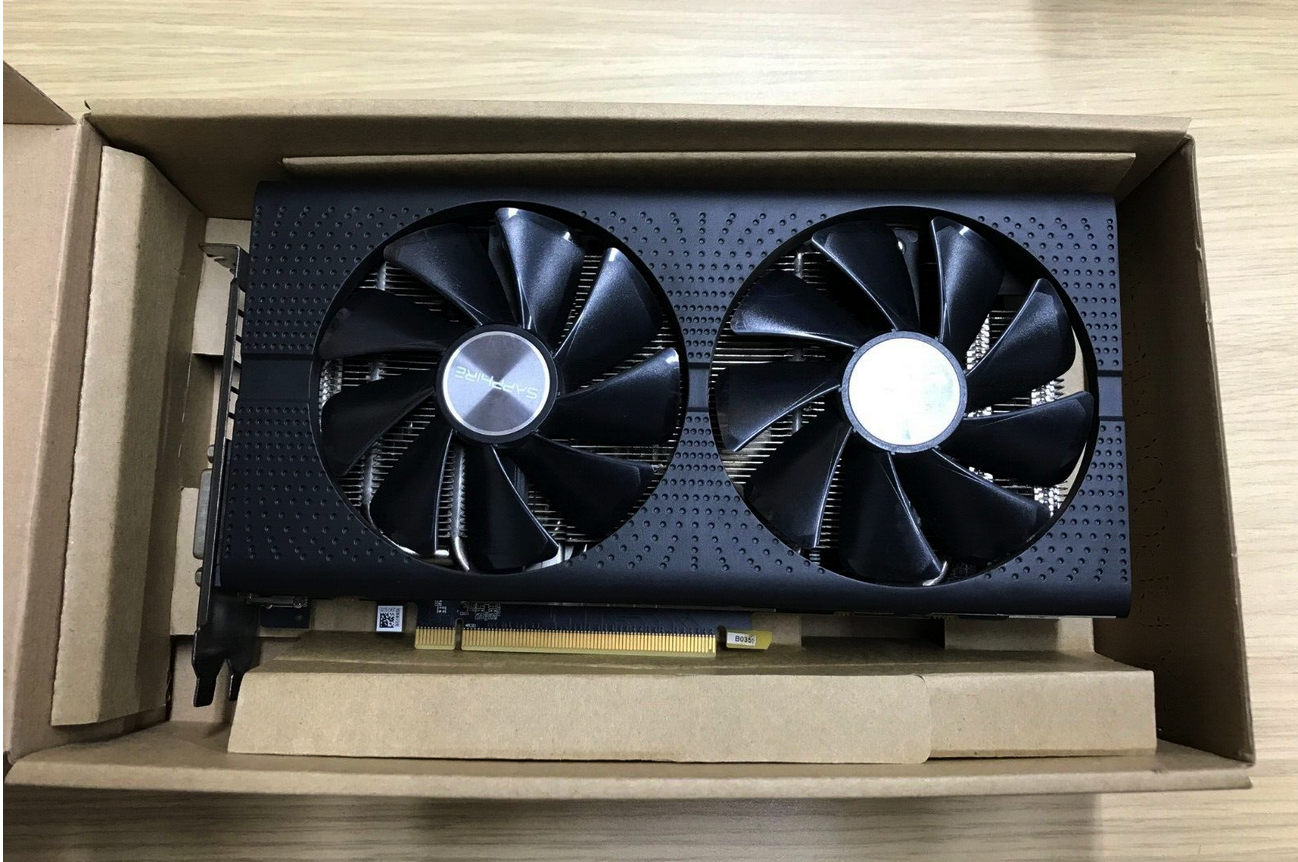

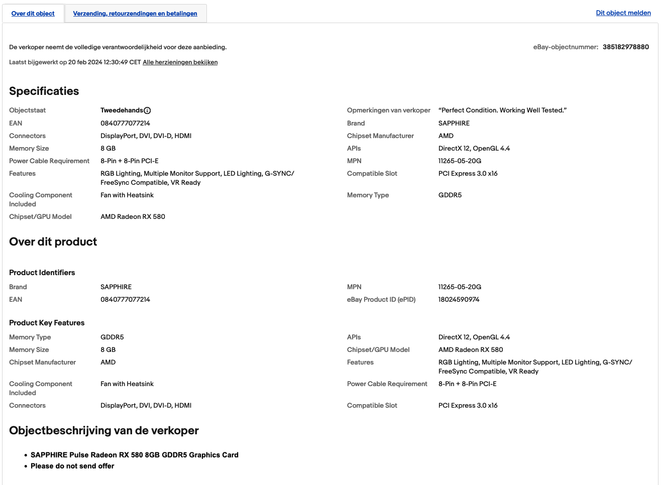

Stockphoto RX 580 8GB - 11265-05
Offered RX 580 8GB on Ebay as 11265-05

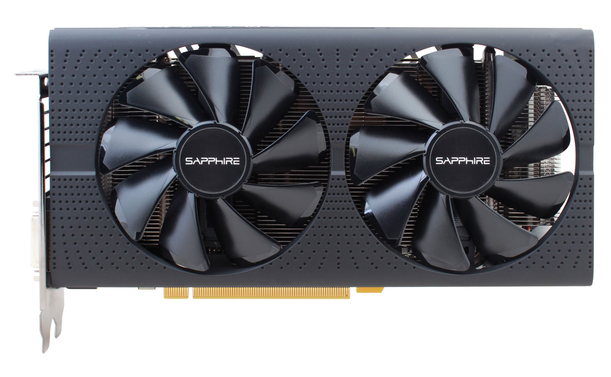

SAPPHIRE Pulse Radeon RX 580 8GB GDDR5 Graphics Card GPU​
Received: 11265-05-20G

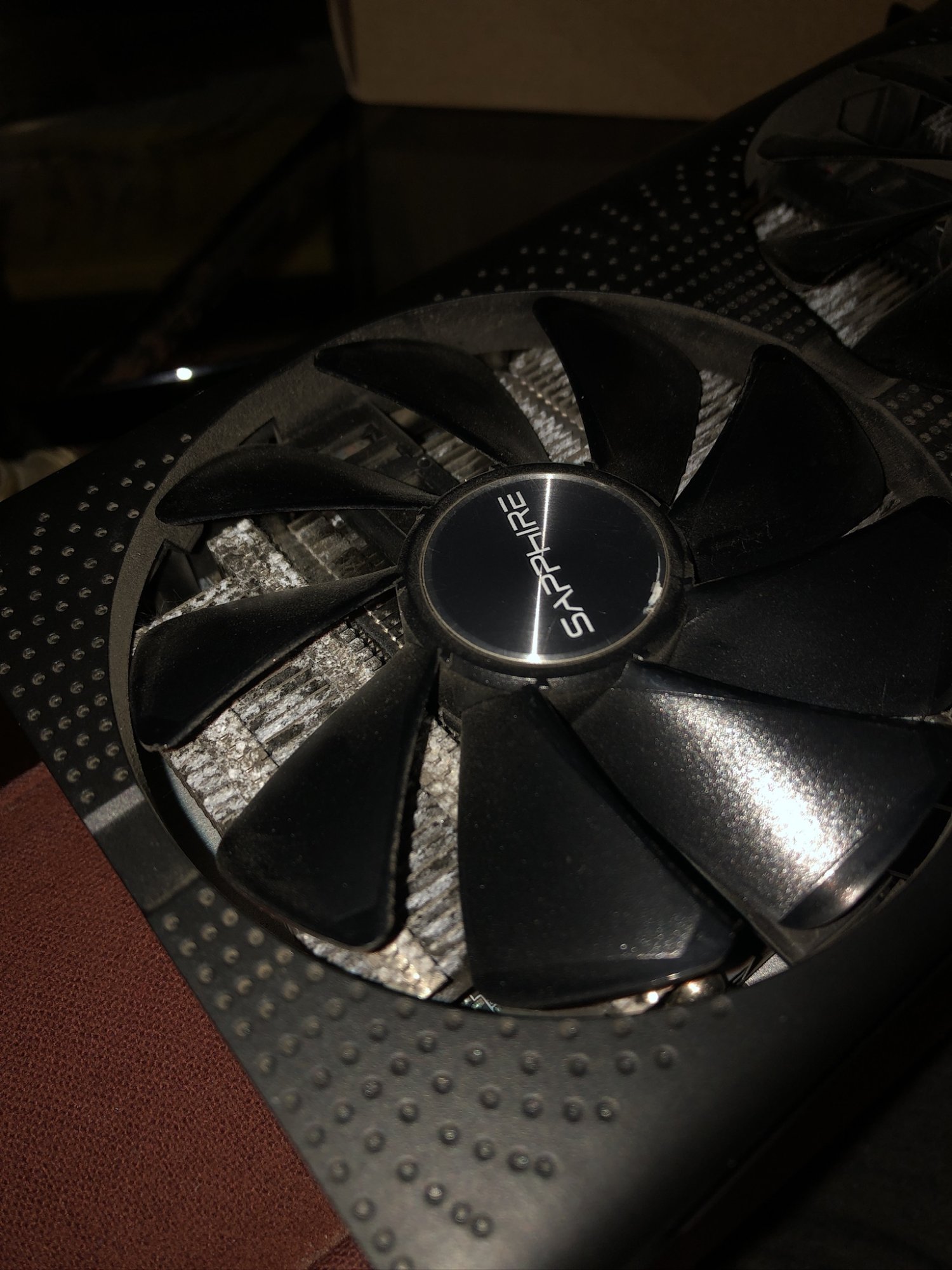

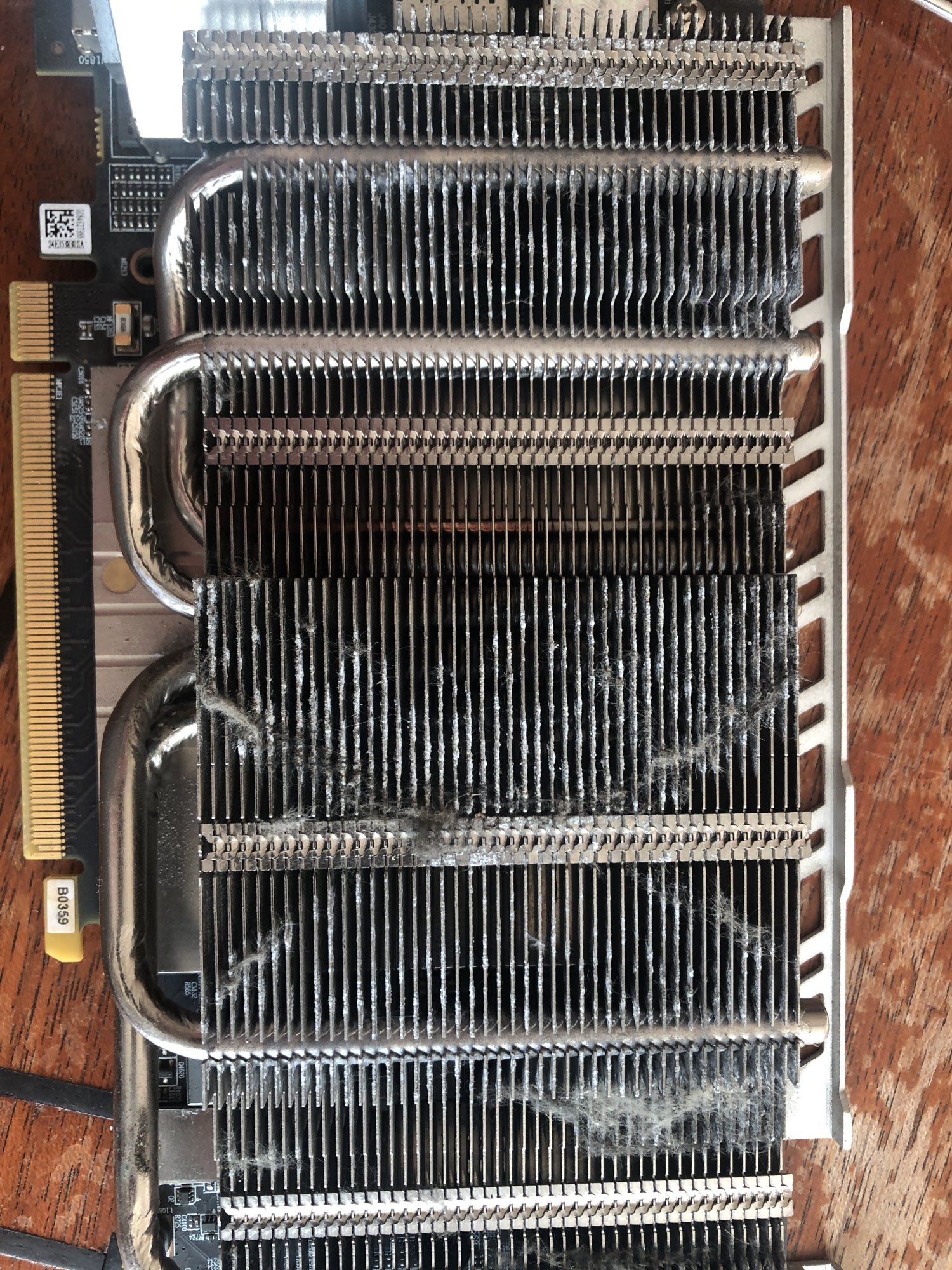

I assume this one needs to be returned, what am I seeing beneath the fan? This unit seems to have a BIOS switch for Gaming/Compute.

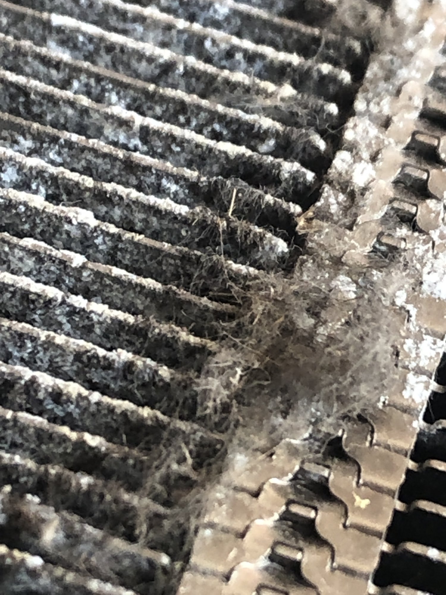

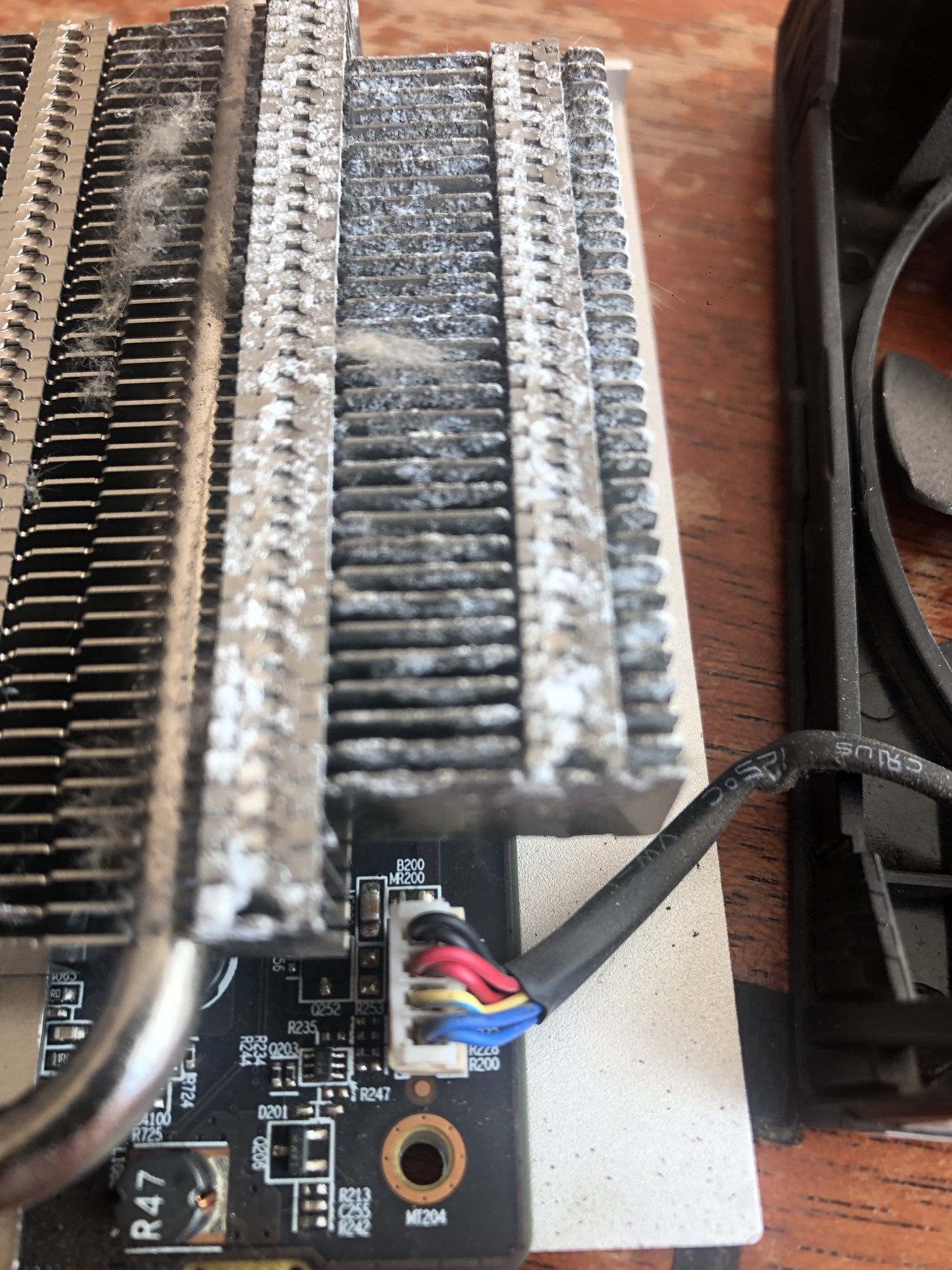

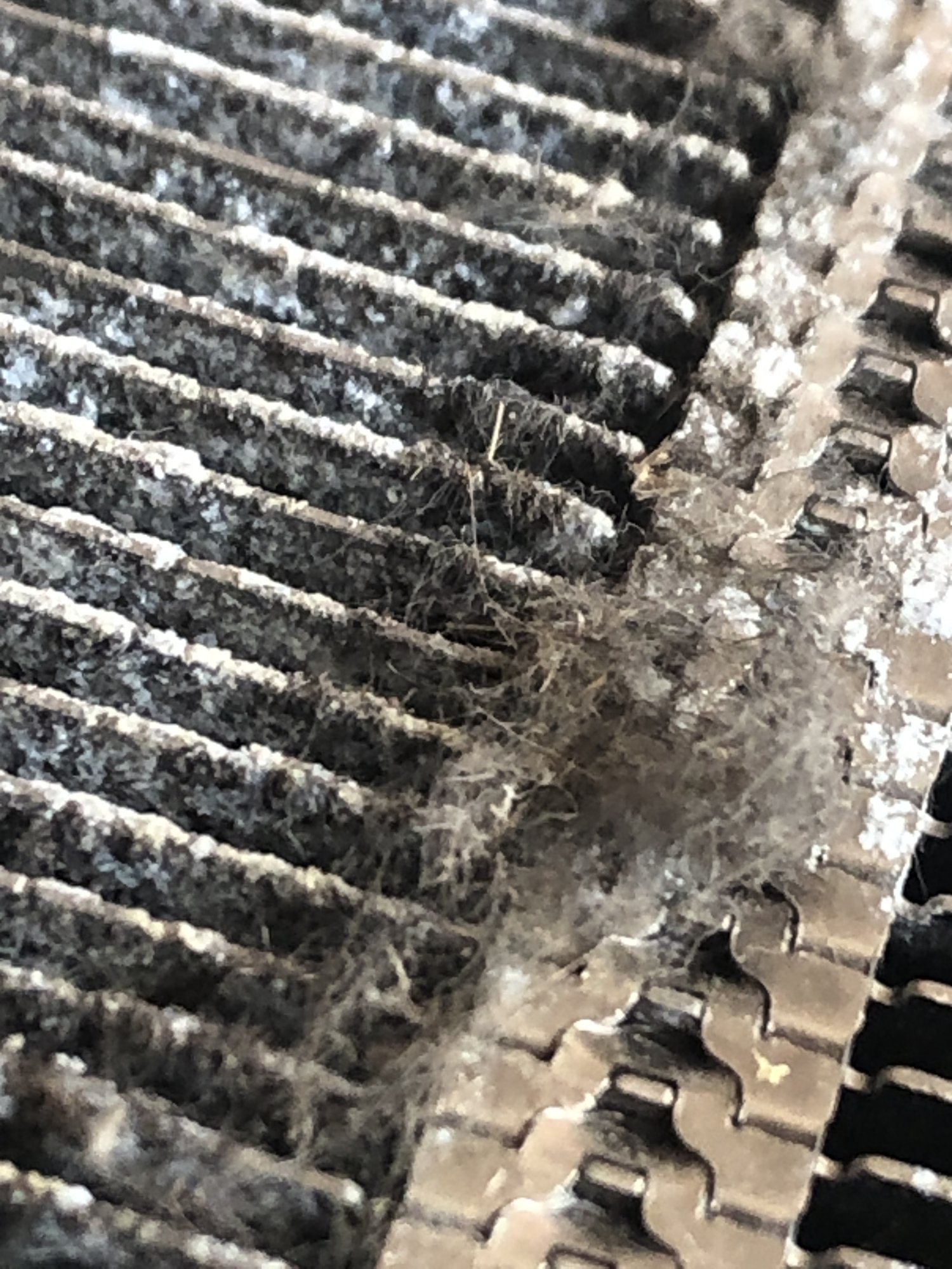

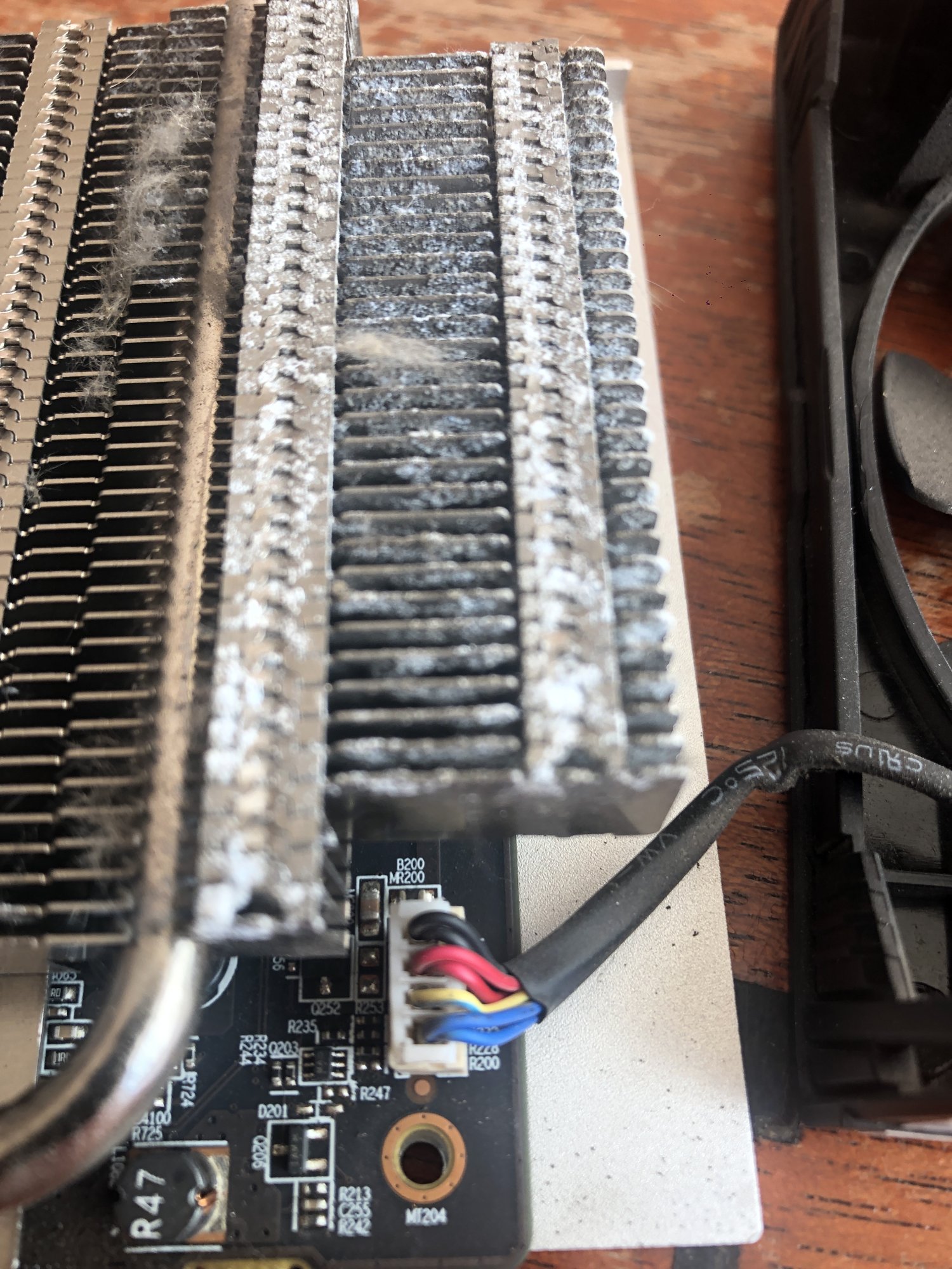

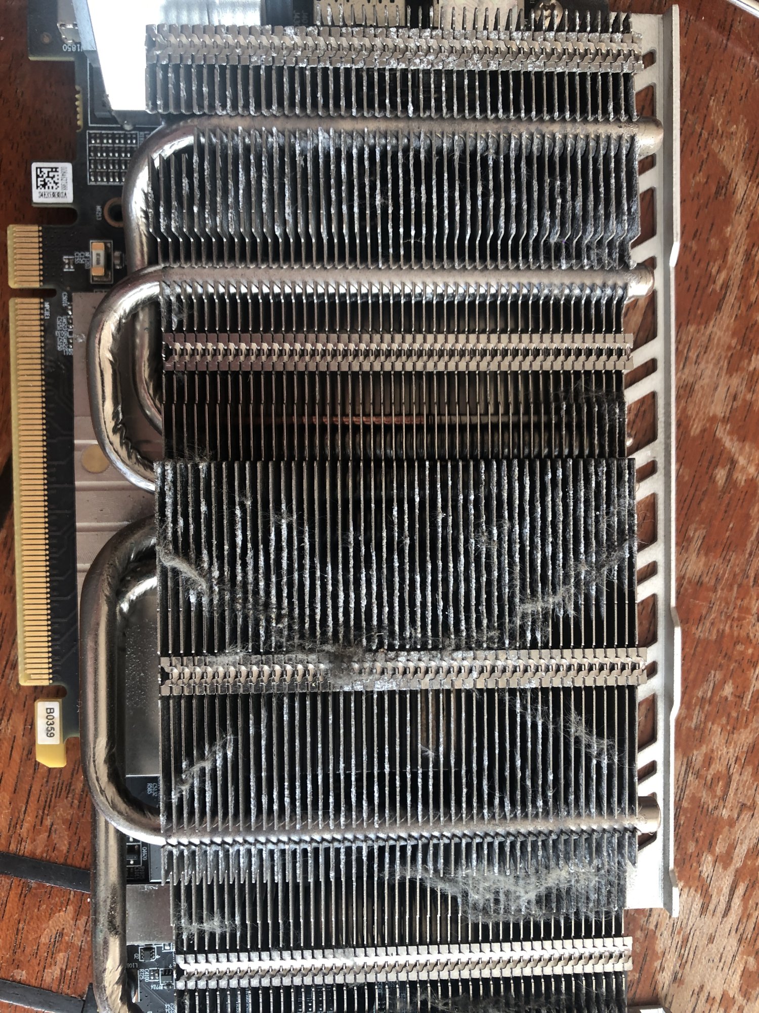

Seems you're in the right. Humid salty corrosive air and a cat lover. Returned it today.

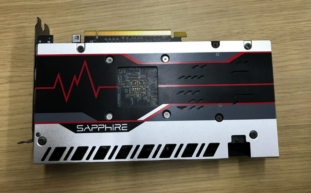

Did you took photos of the GPU backplate? The tamperproof seals over the screws are intact?
I'm surprised that the heatsink is so badly corroded and the PCB is still in a very good shape, judging only from the photos that you uploaded.
Seems very weird, maybe this heatsink is from another GPU.
Reactions: m4v3r1ck

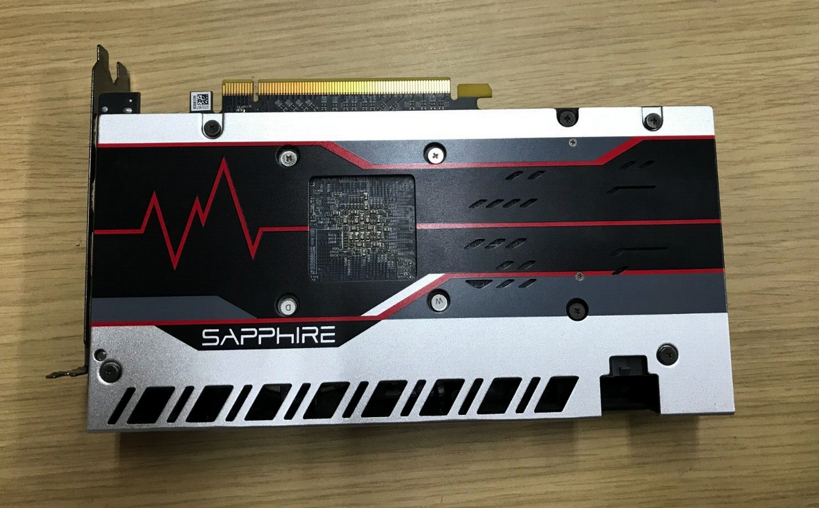

Yes, there were 2 screws with stickers.
source: ebay seller
Never knew/realised those were seals, so didn't pay further attention to them and took the fan-enclosure off to look behind the fins. Can't one not just peal the stickers/seals off and open the screws and put them back after tinkering/replacing the heatsink? There is indeed something weird going on.
source: ebay seller
I asked the seller some questions about his/her QC before sending this item to me. These are just ignored fully...
The stickers are tamper-proof and can't be peeled off easily without damages, it's probably not impossible to peel the stickers off without visible signs, but extremely unlikely.
This is the same GPU? Seems brand new.
Reactions: m4v3r1ck
Thanks for your insights en elaboration in my case. Much appreciated.
This is one of the photos of the GPU that were used in the item description/photos. I got fooled by these photos, as indeed it looks in mint condition.
