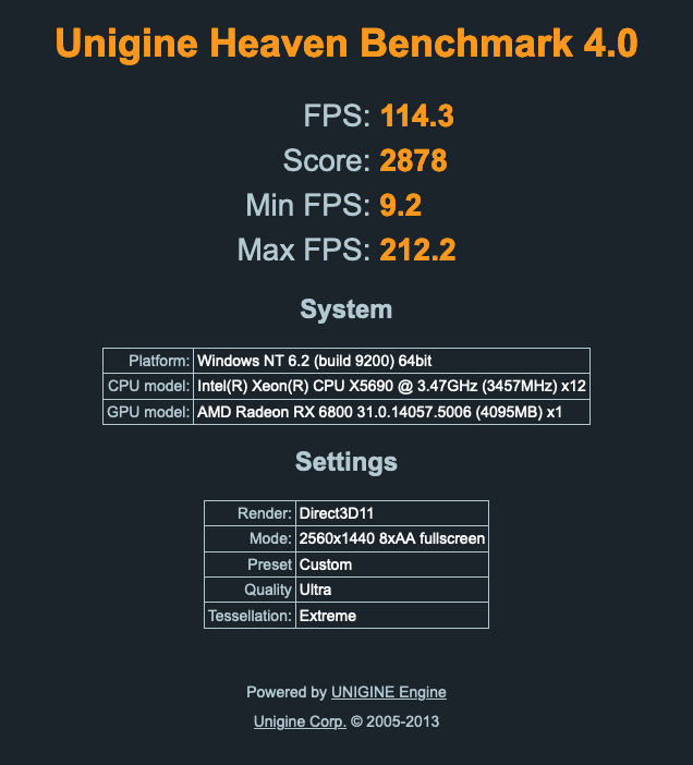

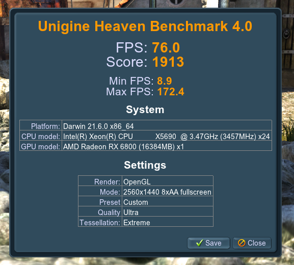

Sure it's better to use Win for gaming. And i also get more than 50% higher scores with benchmarks like Unigine Heaven with Windows (DX11) than with Mac (OpenGL). No matter if i check the RX 6800 or the Vega.
