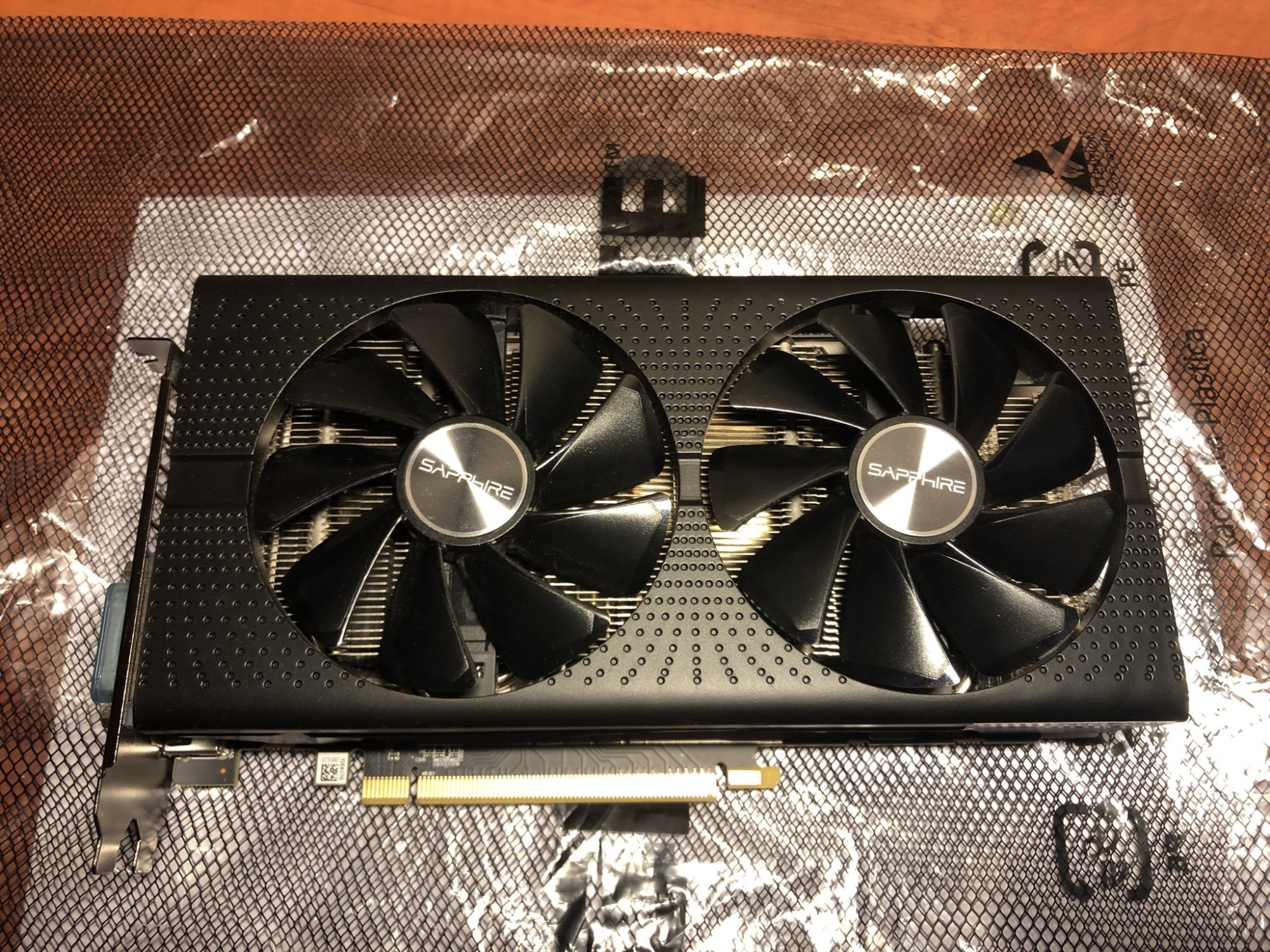

Stockphoto RX 580 8GB - 11265-05

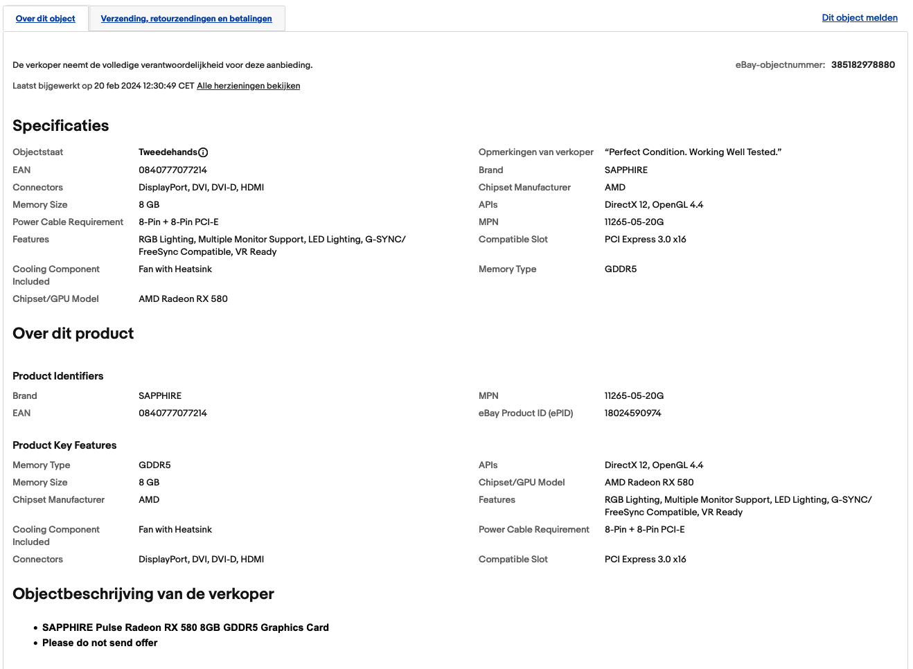

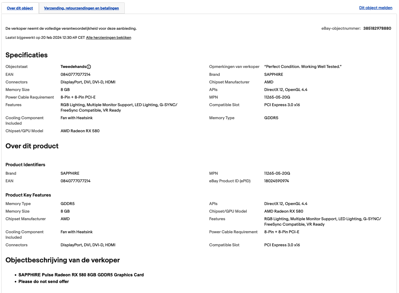

Offered RX 580 8GB on Ebay as 11265-05
SAPPHIRE Pulse Radeon RX 580 8GB GDDR5 Graphics Card GPU​

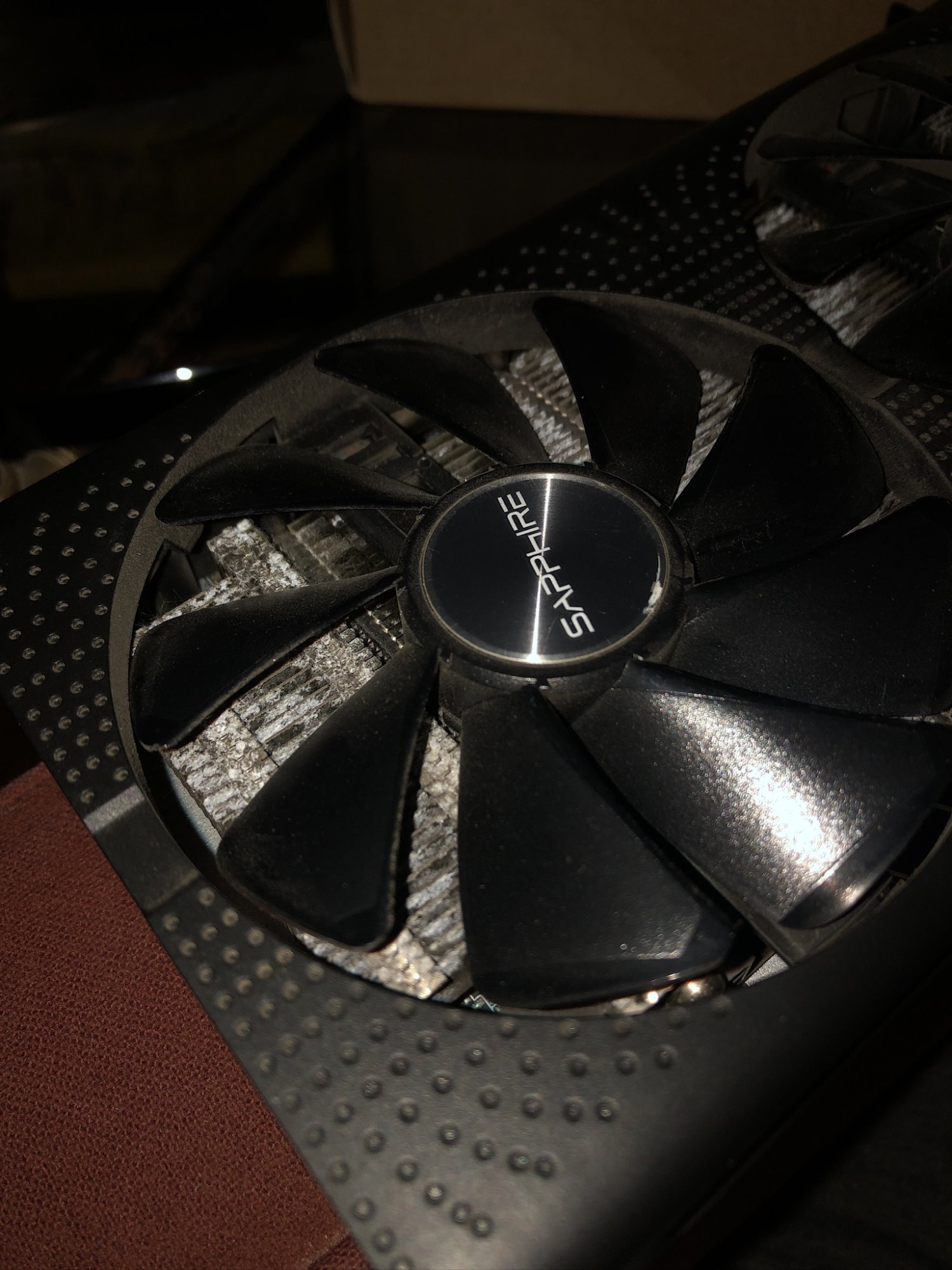

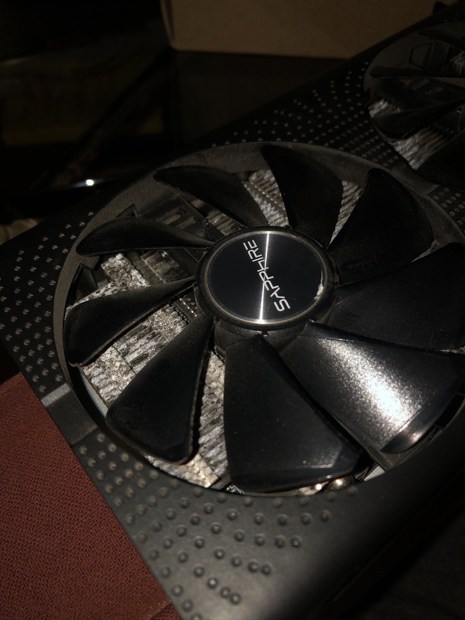

Received: 11265-05-20G
I assume this one needs to be returned, what am I seeing beneath the fan? This unit seems to have a BIOS switch for Gaming/Compute.
Update: Got a refund from ebay, great customer service. Happy with that.

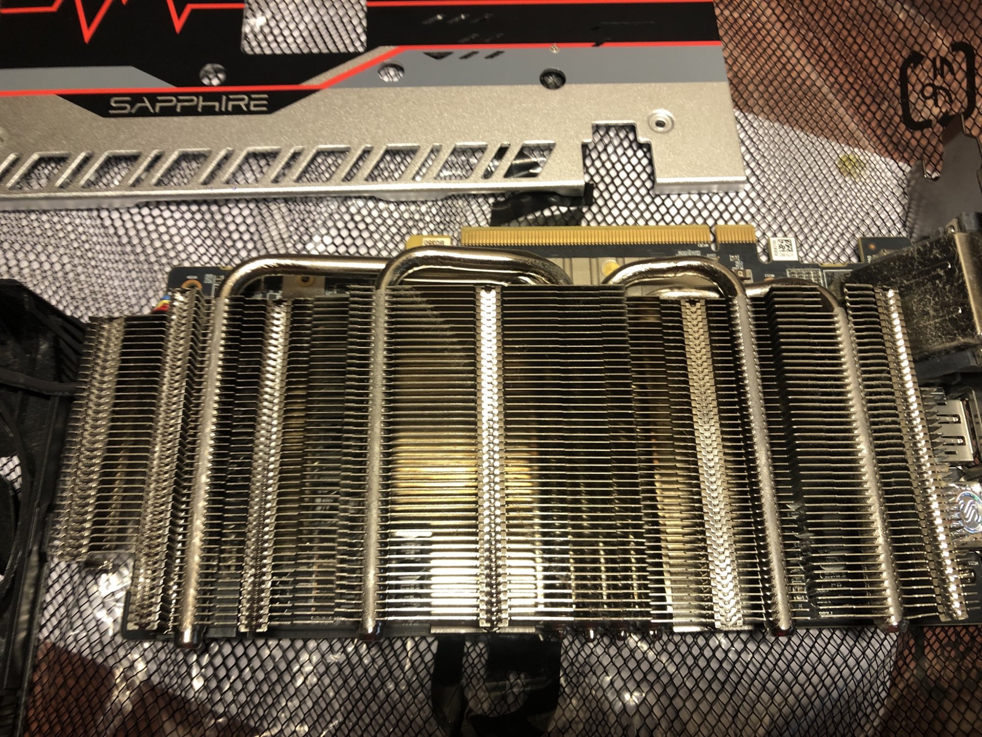

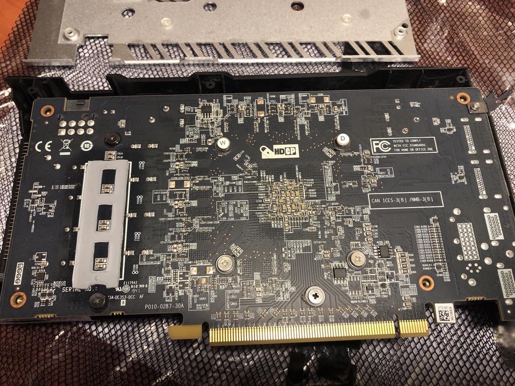

Got another used Sapphire Pulse RX 580 8GB in 100% better condition from Marketplace in The Netherlands:
Heatsink:
PCB:

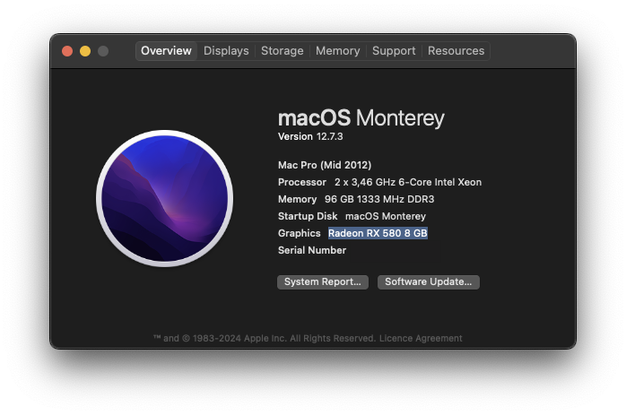

Gave it a cleanup, put it together again and installed it. So far so good.
Set-up ROM switch mode 1 = Gaming (Default)

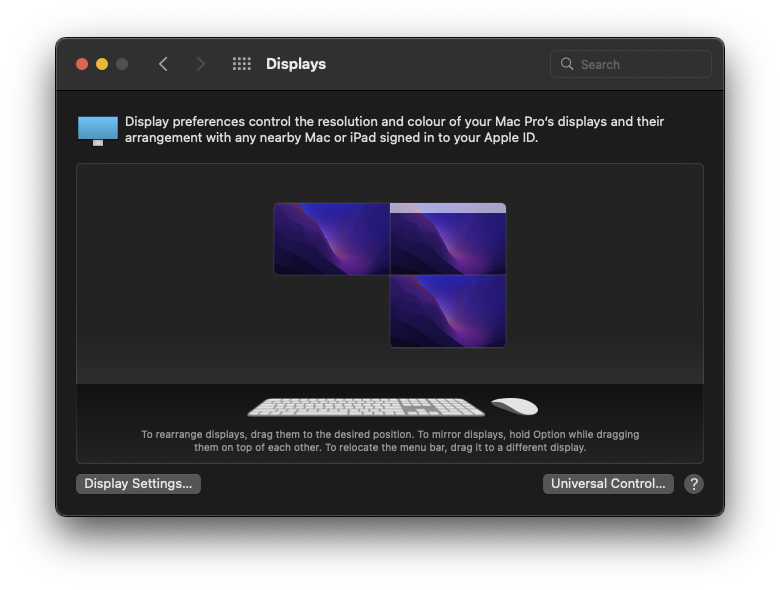

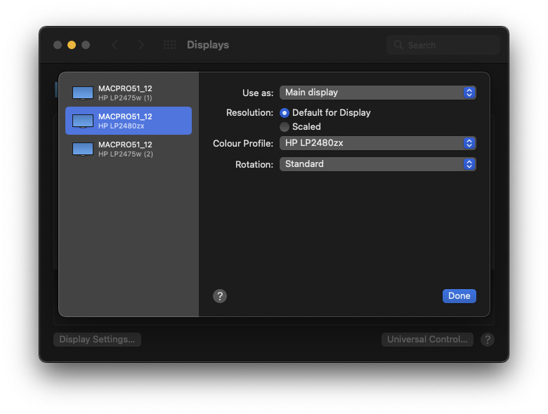

I'm experiencing a (text) render issue on the second HDMI port for monitor 0:
Monitor 0 - main display 2nd HDMI
Monitor 1 - extended display 1st HDMI
Monitor 3 - extended display DVI
What could be the cause of the render issue? Is it OCLP related perhaps?
Update: resolved the issue using a DisplayPort cable iso the HDMI cable.

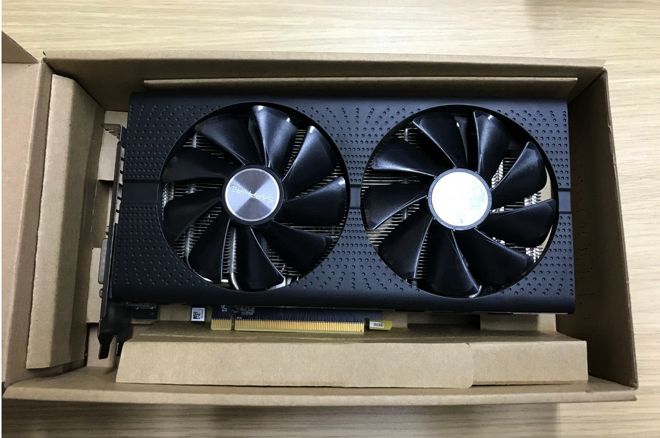

Item arrived well packed and in perfect condition from Ebay (seller was from Czech Republic). The Radeon RX 580 card is compatible with my Mac Pro 5,1. A pleasant surprise. It replaced my Geforce 980 which doesn't support Mojave and higher although it was a reasonably fast card.

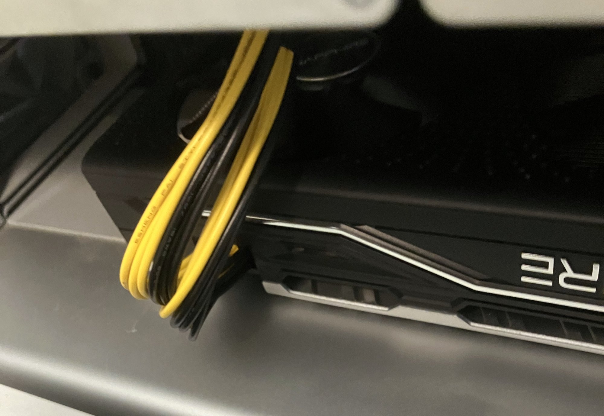

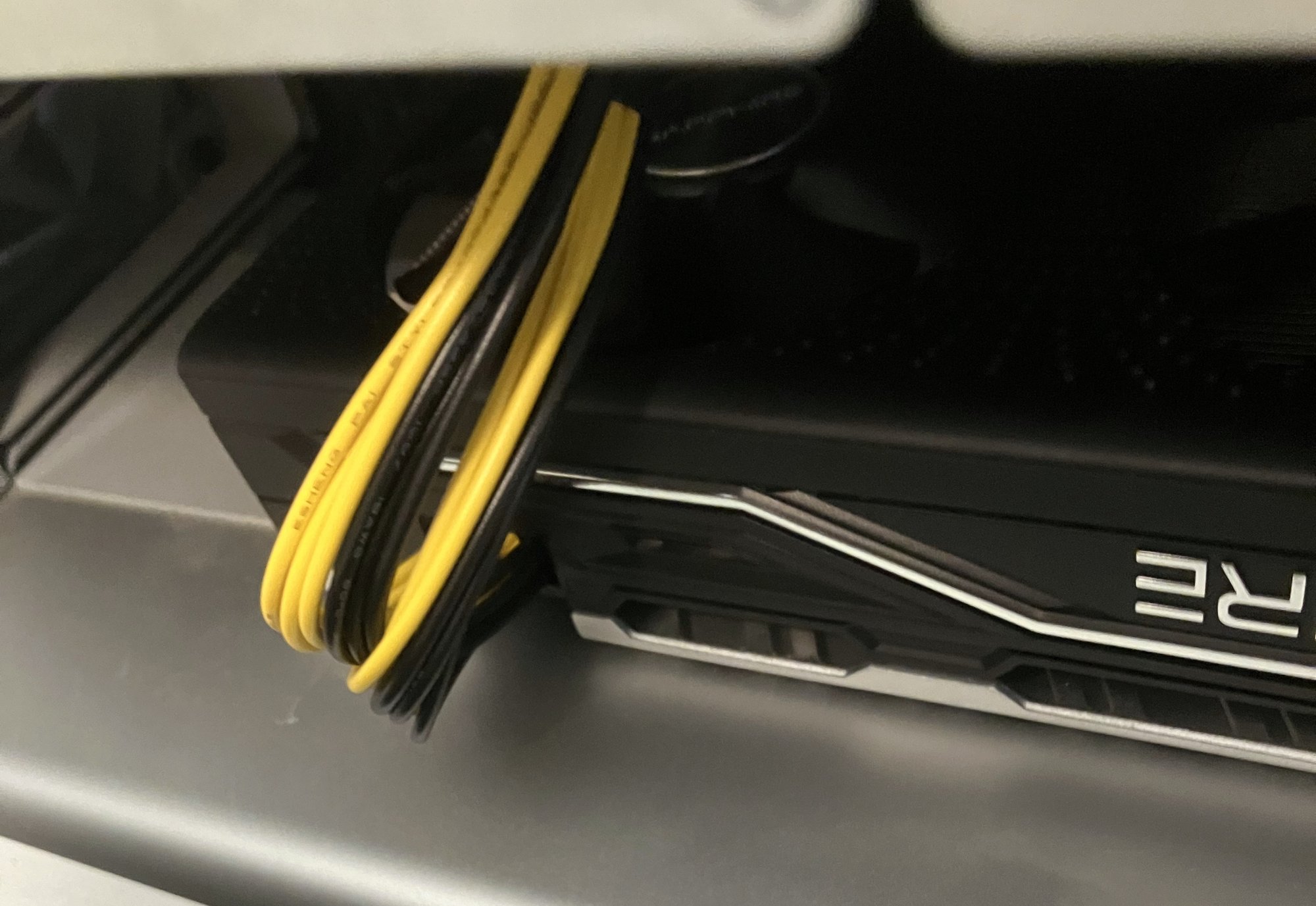

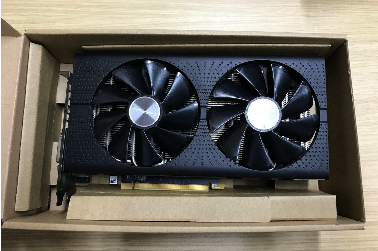

This is the one I bought
It has an 8 pin and 6 pin slot, but it seems the 6 pin is not used or needed. It's the same card as my first Sapphire Pulse, except it's now from China. Luckilly, I definitely don't have the Nitro. I never used the 6 pin with my first card and I didn't have unexpected shutdowns, even not with Furmark.
tsialex
Contributor
Jun 13, 2016
13,452
13,601
It has an 8 pin and 6 pin slot, but it seems the 6 pin is not used or needed. It's the same card as my first Sapphire Pulse, except it's now from China. LUckully, I definitely don't have the Nitro.
There is no Sapphire Pulse with 8 + 6-pin power connectors, go to the Sapphire site and check it.
The PCB of Pulse have pads for ONLY one 8-pin power connector, see this photo of the back of the PCB from @m4v3r1ck Pulse, first post on this exact page:
774a2a45-cc6e-4ba2-84ab-c030669259de_1_105_c-jpeg.2369962
If you got a one that have 8 + 6-pin, is a Sapphire Nitro something with a pair of Pulse fans, maybe a Pulse heatsink or something along the lines.

Is this card compatible with a Mac Pro 5,1?
Sapphire Radeon RX 580 8G Pulse, 4895106281905. from China
I have another Sapphire Radeon Pulse RX 580 in my first Mac Pro 5,1 that works well without additional power.
I bought the same card from the same seller and have issues trying to enable GOP as it seeems that the BIOS from the card has been modified. I can't seee the OCLP menu. The sellers marks it as unmodified GPU but seems otherwise. Did you manage to enable GOP to get the Boot menu?
Reactions: m4v3r1ck
AritzUrr
macrumors newbie
Oct 29, 2024
6
2
For anyone interested, I've flashed the original BIOS of the card and now I have the OCLP boot screen menu. Till then, creating the OCLP with amd gop inject worked fine as well. But these ebay ads are misleading, be careful.
