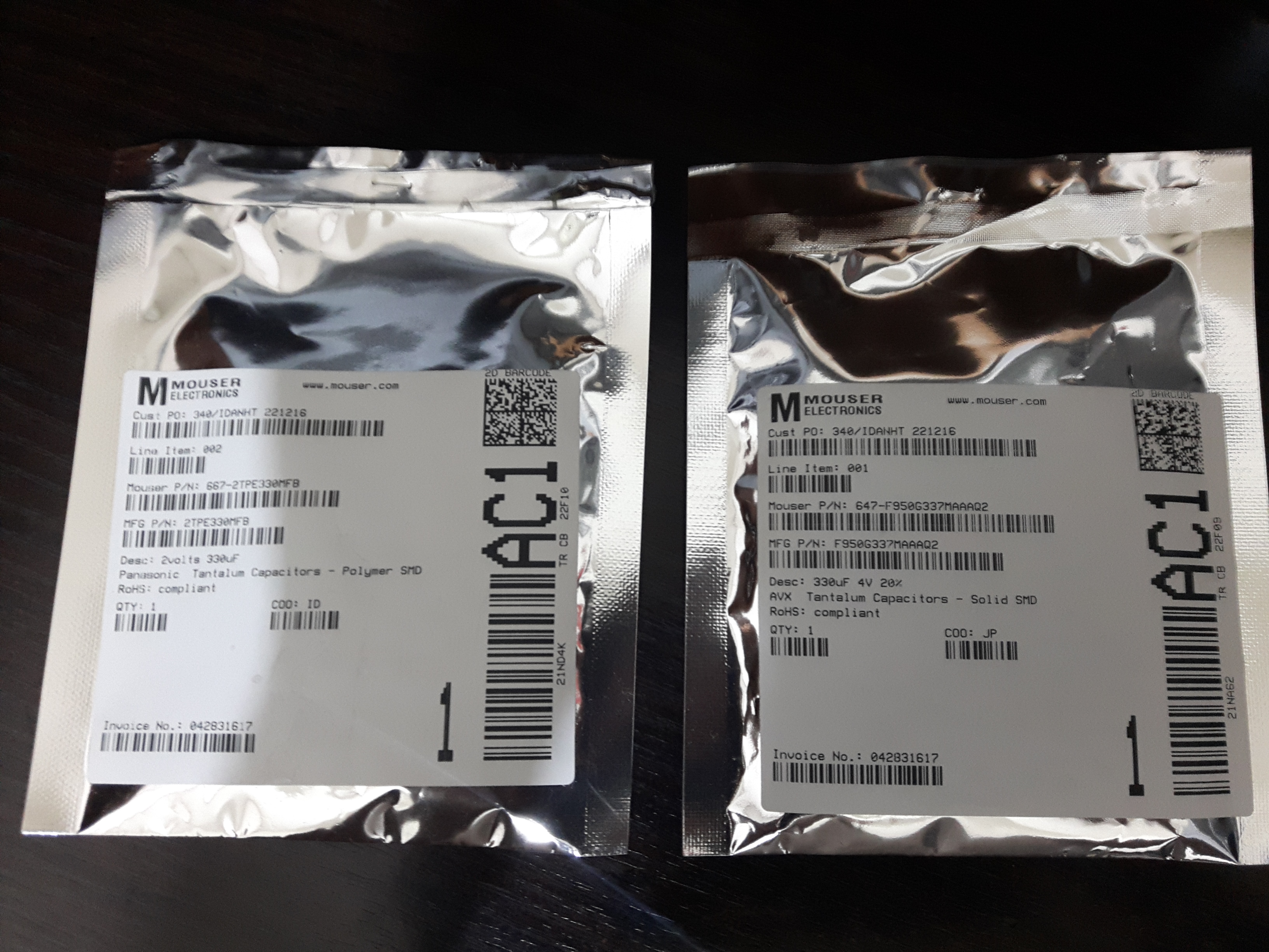

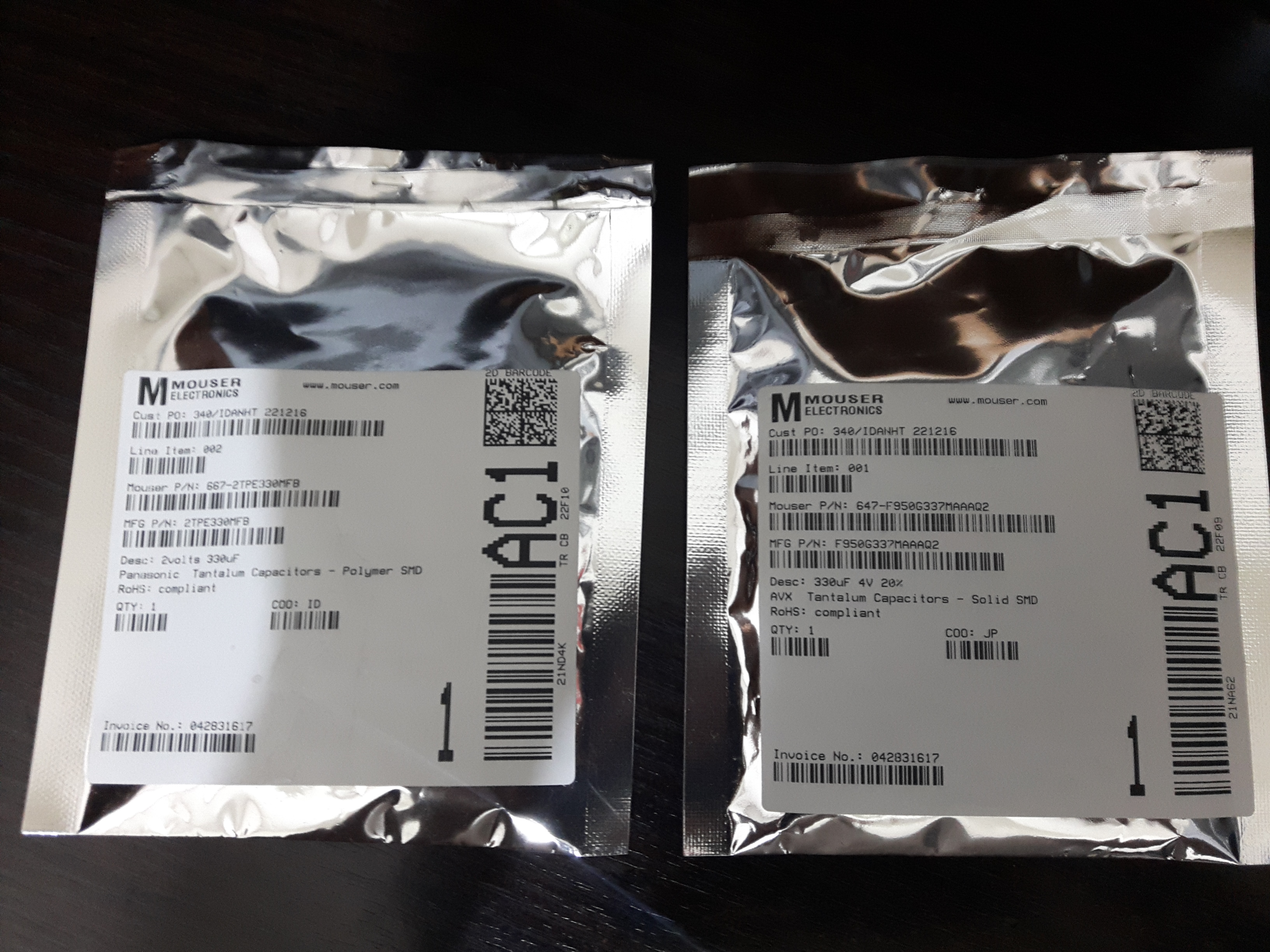

So I finally received the delivery of 3 different caps, took 1 month (!) as I don't live in the US, and only could get it through a local dealer... I though if I'm already going to open the mac up, it's a good idea that I have a few optional caps which I could use (all should be ok).
These were:
330uf/2v tantalum
330uf/4v tantalum
330uf/2v non-tantalum (polarized)
Removing the board was quick! desoldering took some time and patience though. I finally got it up and running, and no GPU panic so far, even when connecting to an external display.
I still have the two tantalums (as originally used in this model), so if anyone is interested please send me a private message and I might be able to send it to your location for the price I paid + shipping. They both should be able to do the job.

Hi,
no, it is much larger. Sorry I forgot to take some pictures.
Its the same size as the one used by "Louis" in this video, the repair starts at 25mn 30sec.
Or this one, but warning in this one Louis places the capacitor the WRONG way !
The strip (+ pole) of the capacitor should be on the other side.
According to the data sheet, the size is : 7.3 x 4.3 mm.
