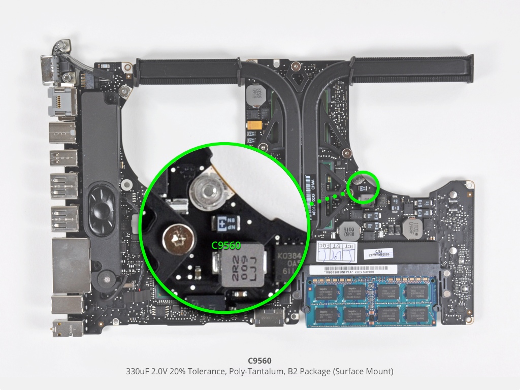

I have access to the Apple Video System Test for MacBook Pro (15-inch Mid 2010), so when my machine started to exhibit video issues, I ran the test. It failed within seconds.
I used a replacement 330uF 2.0v non-tantalum poly-film capacitor removed from a 13-inch MacBook Pro (Mid 2012) logic board with water damage. I keep spare boards around for small components and hard to find pieces. That said you can order them new as well from suppliers like RS, Element14 or Mouser, like so:
http://au.element14.com/panasonic-e...cx0d331r/cap-alu-elec-330uf-2v-smd/dp/2358262
After the capacitor was replaced, I re-ran the Apple Video System Test (VST) and it passed. The issue never reoccurred after that.

I have also ordered a few of the capacitors to try the swap. I have access to a microscope and soldering station, so I will give it a try. If not, my birthday is in Oct.

Had the same issues with my 15-inch Mid 2010 machine. The repair extension program had since expired and because the machine had entered vintage status, replacement parts were no longer available.
I'd already bought soldering tools to repair a Mid 2009 MacBook Pro, so I decided to have a shot at changing the troubled capacitor. Problem solved. Not the easiest repair in the world but it would be a straightforward job for an electronics repairer or anyone skilled with a soldering iron.
This would be the better solution for anyone that isn't content with a temporary software fix, boots between multiple operating systems or needs the use of the higher powered graphics hardware.
Ohhhh yeah ! thanks a lot for this, iMacC2D ! I replaced the faulty cap and the discrete GPU is working without any issue :-D Thank you so much...you saved the live of 3 MBP2010 :apple::)
