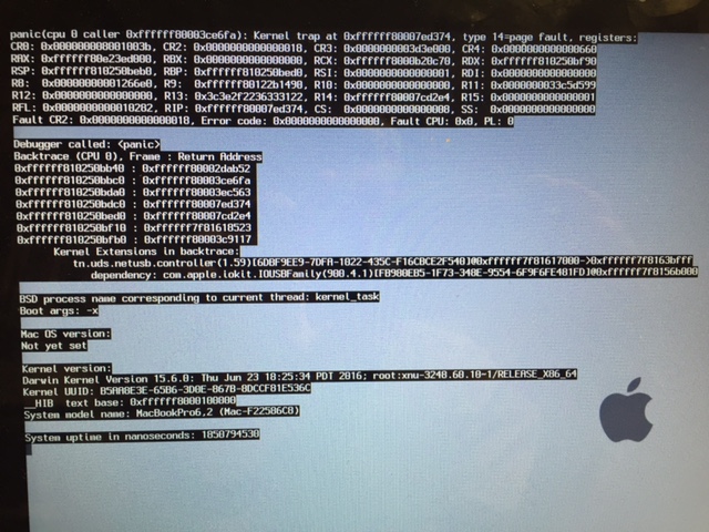

I actually do have the 256mb graphics card and I'm still on El Capitan.
Unfortunately I did have another panic. I edited the info.plist with your values so this is what I added, I assume I didn't make any mistakes.
This is what I have:

This is the log report for the crash
Anonymous UUID: D2CF532E-D725-DC92-7835-79E5EF679B46
Thu Sep 29 13:44:55 2016
*** Panic Report ***
panic(cpu 0 caller 0xffffff7f8c6bcbd5): "GPU Panic: [<None>] 5 3 7f 0 0 0 0 3 : NVRM[0/1:0:0]: Read Error 0x00000100: CFG 0xffffffff 0xffffffff 0xffffffff, BAR0 0xd2000000 0xffffff9126316000 0x0a5480a2, D0, P2/4\n"@/Library/Caches/com.apple.xbs/Sources/AppleGraphicsControl/AppleGraphicsControl-3.12.8/src/AppleMuxControl/kext/GPUPanic.cpp:127

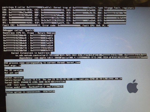

Any way to reverse the fix? Worked for a day and then shut down. Now, cannot get past apple screen. Goes about 10 seconds and keeps restarting. Safe mode pic attached.
this is not a problem with the fix.
Can remove with: boot into single user, type this command: rm -R /System/Library/Extensions/AppleGraphicsPowerManagement.kext
after type: exit
