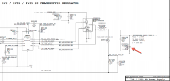

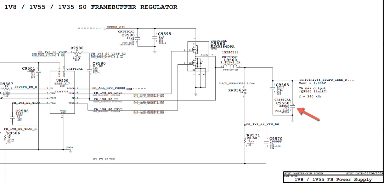

Hi Lynmond, I bought the capacitors from RS Components but they only sell them in strips of 5, so I have plenty. If you PM me your address I'll happily send you a standard capacitor (as per C2D's post and Louis Rossman's Youtube video) and a tantalum capacitor (which is a like for like replacement) when I've had my logic board repaired. I must admit I'm very nervous having somebody stick a soldering iron on my motherboard, but I've searched and searched for a local shop and have eventually found an iPhone, iPad, Games Console, laptop repair shop that seems to have the required kit and appears to be competent enough.
If you want to order your own from RS, I got these:
Capacitor Polymer SP-Cap 330uF 2V - Stock no.: 8663696
http://uk.rs-online.com/web/p/alumi...3743D38363633363936267374613D3836363336393626
Capacitor Tantalum TPE series 2V 330uF - Stock no.: 7955878
http://uk.rs-online.com/web/p/tanta...3743D37393535383738267374613D3739353538373826
The fix on Sierra was a piece of cake, it really was. I grabbed this file https://dl.dropboxusercontent.com/u/35721057/10.12.AppleGraphicsPowerManagement.kext.zip and I used the other KEXT injection tool, KEXT Utility.
The capasitor i ordered is 2.5 volts. Will that work?? Did the kext fix. So far no panics.
Reactions: fabioroberto
I wouldn't be able to tell you I'm afraid, I just went with the specs shown on this picture https://forums.macrumors.com/thread...010-whats-the-best-fix.1890097/#post-23317162
Have you replaced the capacitor yet? That KEXT fix is an absolute god send... If the hardware fix gives me he full use of the GPU again that will be even better!
No I haven't. Waiting for the capacitors to arrive. But I don't know if it is okay to use 2.5V instead of 2V as describedBut 2.5 was the only ones I could get. I'm in Denmark.
Ordered the right one now.
cant wait for it to get here. A giant applause to fabioroberto for finding the kext fix:):)

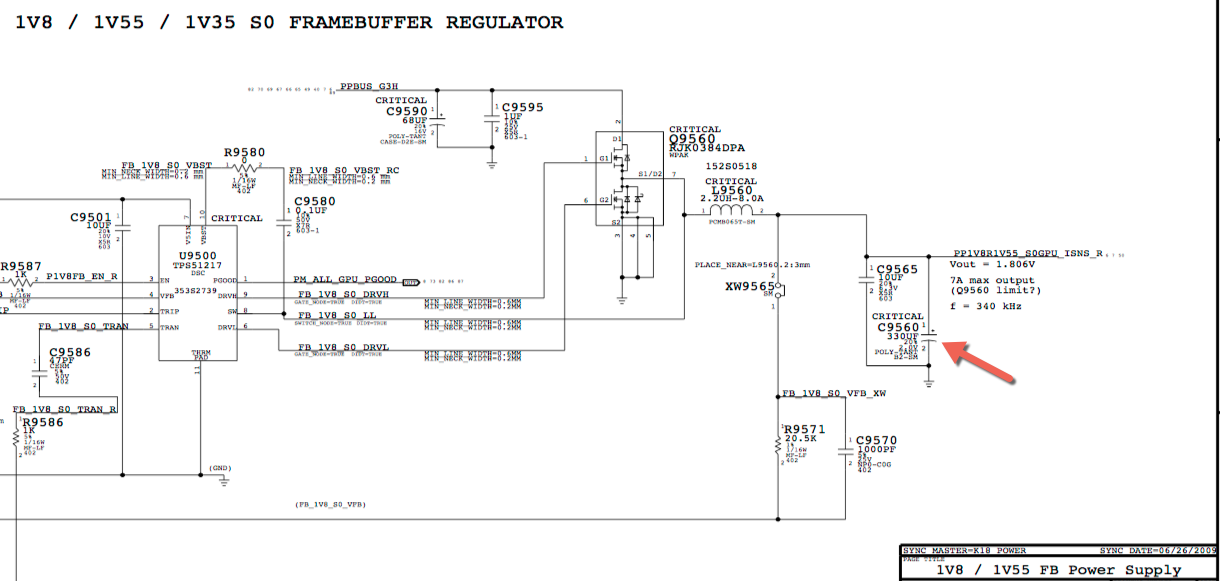

Problem is the voltage on Framebuffer regulator PP1V in the logic board depends to an tantalum capacitor very very fragile. So, when voltage change from 1.05v to 1.806 the capacitor fails. So logic board is perfect, exception this capacitor.
https://forums.macrumors.com/thread...ats-the-best-fix.1890097/page-3#post-23617760

Can anyone confirm what a good capacitor is to use? Any surface mount 2-2.5V 330uF?
I found this one on DigiKey: https://www.digikey.com/product-det...c-components/2TPE330MADGB/P16190CT-ND/4146633

That's the one I've got as a like-for-like replacement.
But isn't that a tantalum capacitor that will fail again over time?
It is and I've also ordered non-tantalum capacitors as well, covering both bases in case my repair shop says that they won't bare a track on the logic board. I'd rather it fail over time again knowing that it can be repaired rather than leaving it slightly crippled with the kext fix.
I don't know if it's all tantalum capacitors that are bad, if there are better brands, what's causing it fail etc. It would be great if an electronics expert could shed some light :)
My preference when I take it to the shop is for them to fit a non-tantalum cap, but if they won't then at least I have one that's the same physical size and whatnot.
Thought the exact same thing. I have also ordered both tantalum and non-tantalum. Except I am trying to do the repair myself:eek:. Still trying to decide whether to scrape for the non-tantalum or use the like for like option:confused:
