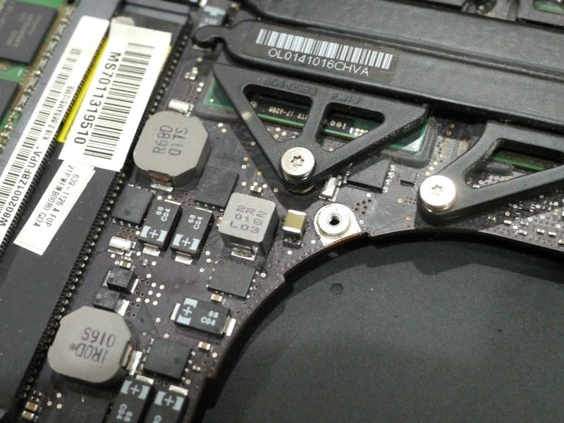

Yeah its a well known issue. Mine had it. I'm typing on it now. See if the Genius Bar will send your computer to Texas for the $300 fixer upper. They replace everything that's wrong with it for a flat fee. I believe it was a fault with the graphics switching/GPU and you'll need a new logic board most likely in addition to whatever else may be wrong.
Succes. Switched the capacitor myself this evening. It was my first time soldering anything so I am happy with the result.:D:DMy MacBook Pro is running great again without kext fix an above all, no kernel panics.

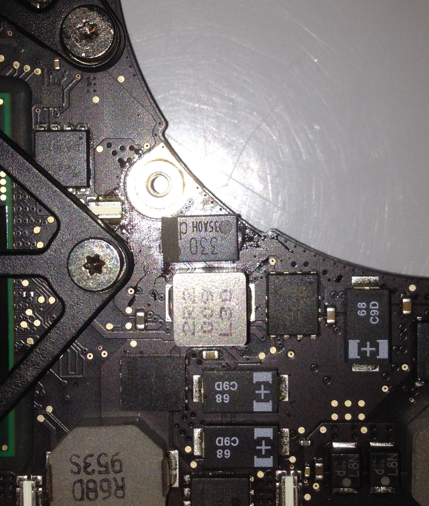

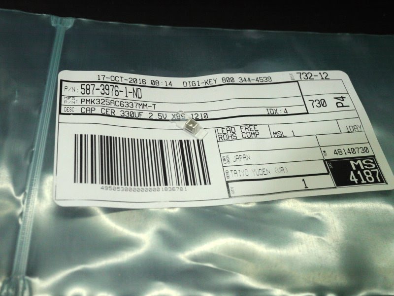

I've replaced the C9560 with this one:
The length of this MLCC is almost identical with original cap.
I can directly replace it without scrapping the Logic board.
After replacing the cap, no GPU panic and reboots happen anymore~~!!
It also passed the Cinebench test and exported screen to TV without crashing.
I suppose my macbook to be fixed completely. :D
All the information in this thread is very useful. Thanks everyone~~

i would like to check with you @therionchu, how much did it costed you to courier this little saviour all the way to Taiwan? I'm living in Malaysia, this little thing cost me penny but the courier fee is a bomb. Is there anyway i could buy this without spending hundreds since i'm not 100% sure changing the c9560 would solve my macbook 2010 15', if it does solve that would be great, what if it didn't work out, spending usd50 for a component with our weak currency is really a pinch!
Digikey in Taiwan offered Free shipping for all the orders of 100 USD and greater.
If I want to order small amounts of products from Digikey or Mouser, several companies in Taiwan could provide "Group buying" service.
The capacitor + additional handling fee and local postage fee only cost me ~6 USD this time.

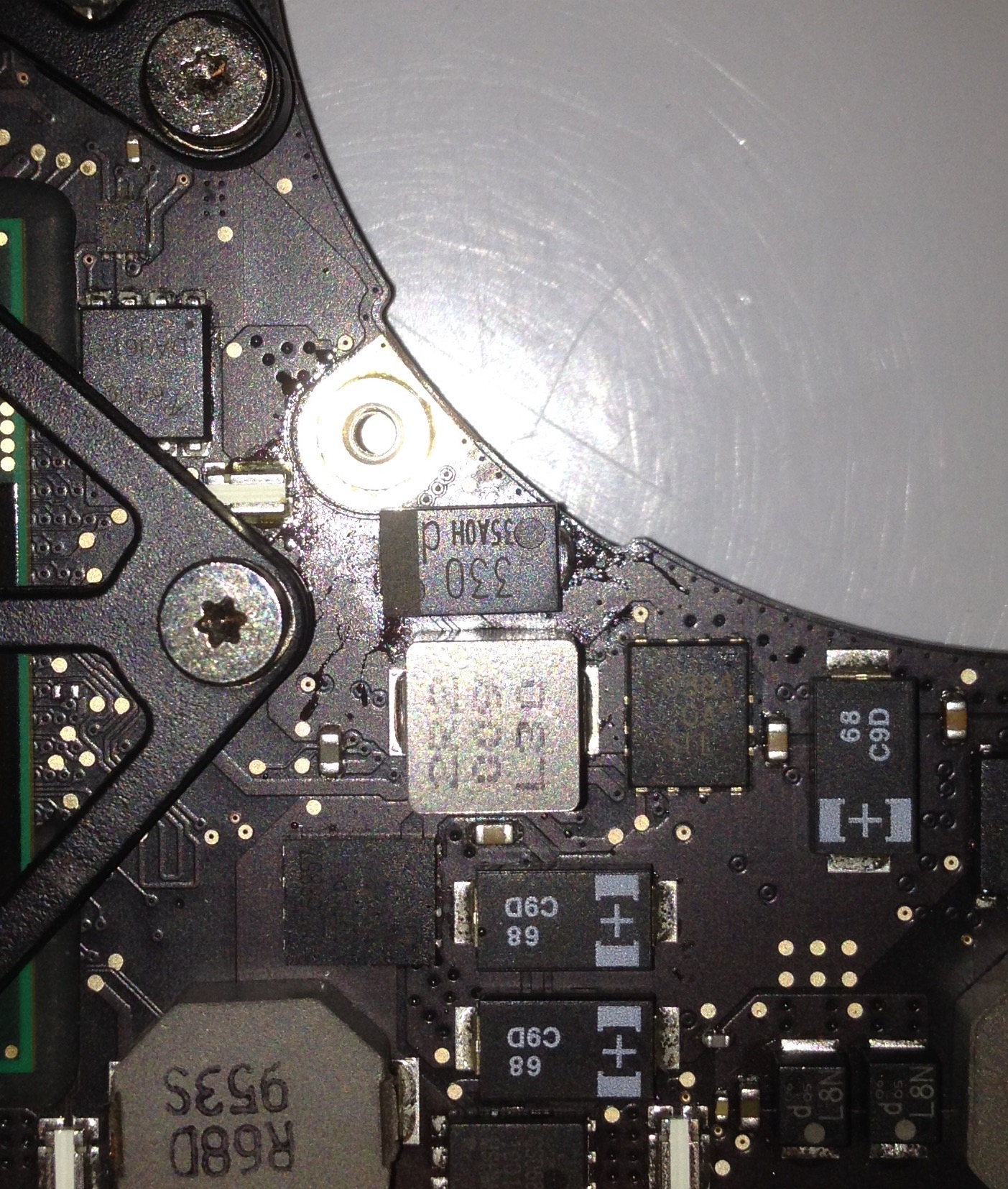

This fix is just to Gpu Panic. If you dont have this issue into built-in display, the fix will not help you.
If you wanna have a sure, test many and many time repeatly the Cinebench app (gpu test) if will fail. If your problem is the instable Framebuffer pp1v voltage that is invoking the begining of the glitches, artifacts.. test will fail. And yes, here is the problem that the kext edited will fix.
Otherwise, this is not your problem for now.
Problem is the voltage on Framebuffer regulator PP1V in the logic board depends to an tantalum capacitor very very fragile. So, when voltage change from 1.05v to 1.806 the capacitor fails. So logic board is perfect, exception this capacitor.
