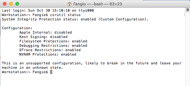

Fangio
macrumors 6502
Jan 25, 2011
375
473
10717
SIP won't allow unsigned KEXTs to load, so I imagine it's that. Why are you reenabling SIP?
I was under the impression that you could re-enable SIP and the kext would still load, as several people in this thread mentioned doing that.
You can configure SIP to disable the kext-signing part only, right from the beginning, or re-enable without kext-signing, as per instructions here. I've been using this command
Code:
csrutil enable --without kext
SIP status check will show this as result
thats enough to run HDMI Audio just fine.
