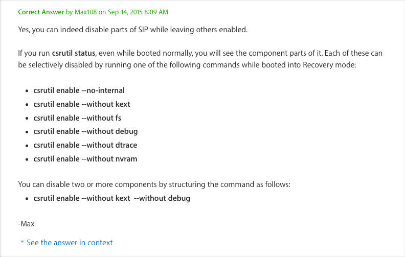

Pretty sure you can just disable the kext signing part, but not the whole SIP. I can’t remember the command because I never use it. But google is your friend.
Anyway, I always keep SIP off. It won’t help anything for me, but just create more trouble. Also, there are plenty Mac users out there have a broken MacOS and they don’t even know what SIP is (never disabled).
Yep, he can but i've never done it. As you were saying in some topic, cMP is becoming more and more like a Hackintosh, so you loose a lot of functions if SIP is enabled.
Anyway, here are specific commands

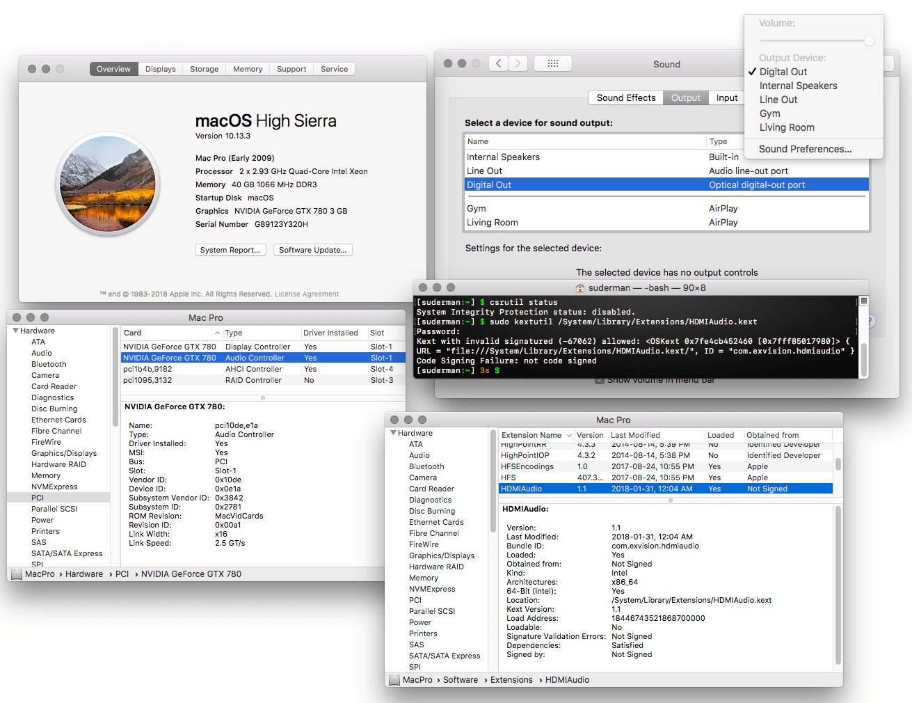

This used to work for me, even on High Sierra. But it's been gone for a few months I can't figure out why. The strange thing is that the HDMIAudio kext appears to be loaded, but there is no HDMI device to select for output.
I'm running 10.13.3 (SIP disabled) on a 4,1 -> 5,1 Mac Pro with a MacVidCards GTX 780 native driver.
Does anyone have any idea what's going on?
So far, the only way to make it work in High Sierra with my Nvidia card is by using Clover. But I don't think it's a "solution" for most Mac user.

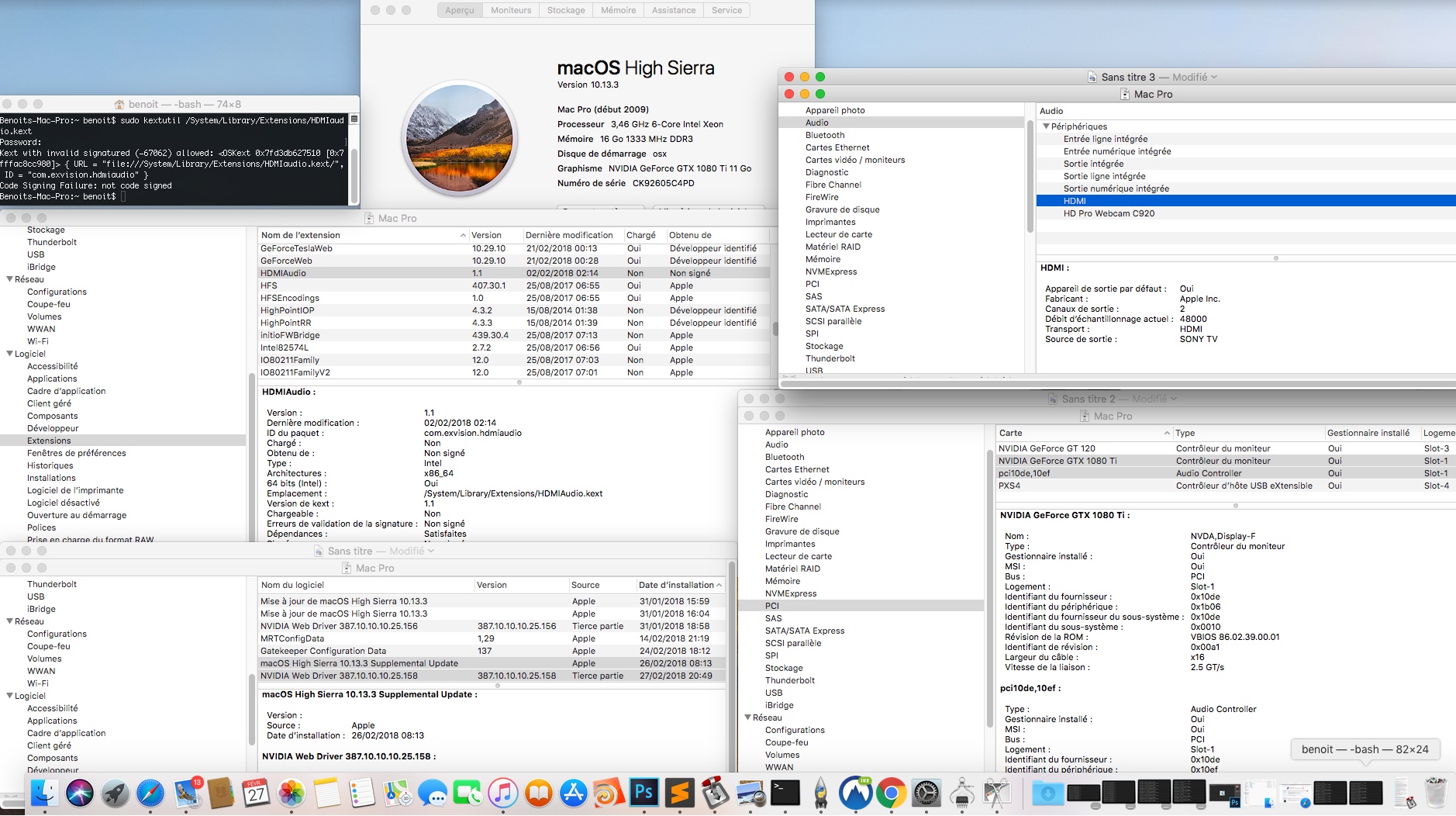

It looks like the HDMIAudio.kext stopped working in the latest 10.13.3 with supplemental. Loads with no error, but no results using a Gigabyte HD 7970.
Bummer...

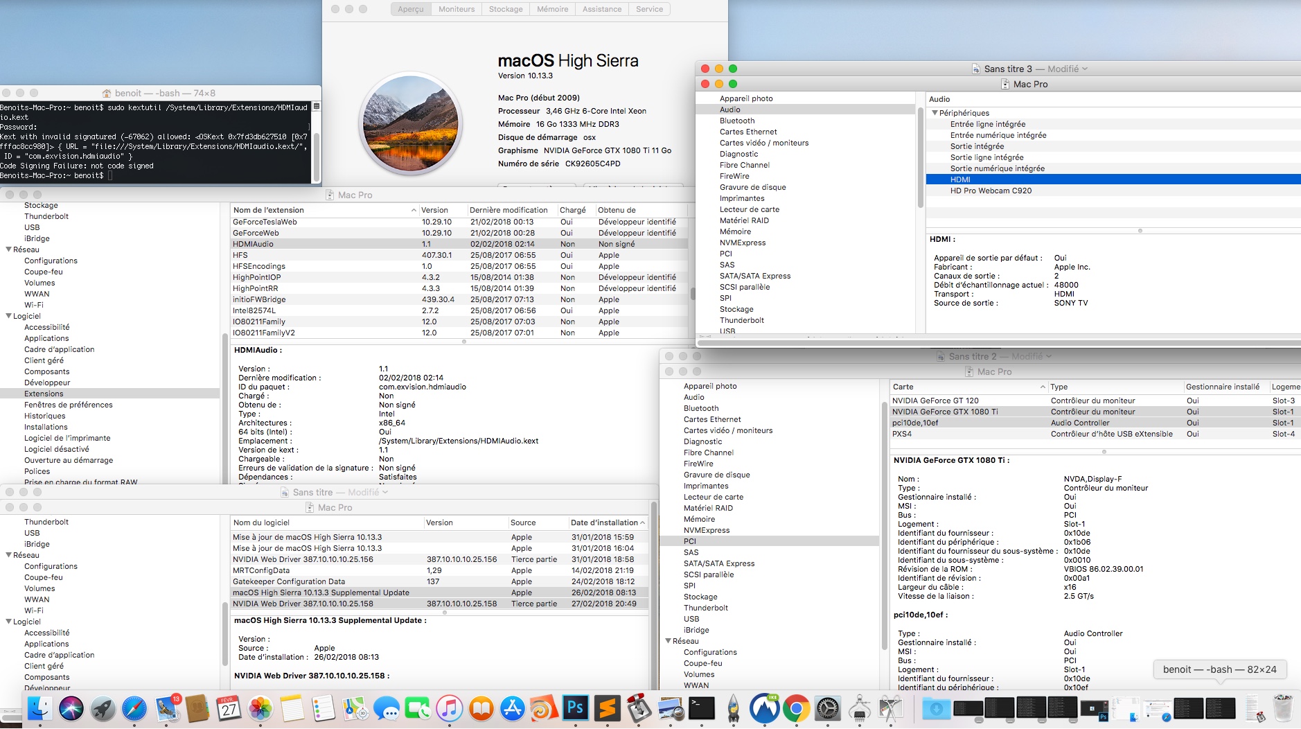

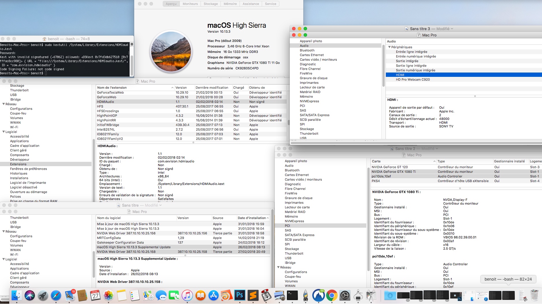

ben4096
macrumors newbie
Nov 25, 2017
5
To me HDMIAudio is back with the 10.13.3 Supplemental Update.
Just as for everyone here it was not working anymore since the 10.13.3
I just install the Supplemental then the latest Nvidia driver 387.10.10.10.25.158, restart. And the miracle happened.
Really I have no idea why or how...
Sorry the proof screenshot is in french, I didn't bother to restart to change the langage. hdmiaudio.jpeg
h9826790
macrumors P6
Apr 3, 2014
16,656
8,587
Hong Kong
Sorry the proof screenshot is in french, I didn't bother to restart to change the langage. View attachment 752659
It seems your screen capture shows that the HDMIAudio 1.1 extension is not loaded. I can see that the HDMI audio is working, but I doubt if solely due to that particular driver.
ben4096
macrumors newbie
Nov 25, 2017
5
You’re right. That’s all weird since I didn’t install anything but the suplemental and the latest nvidia. Could it be the nvidia that now support audio output ?

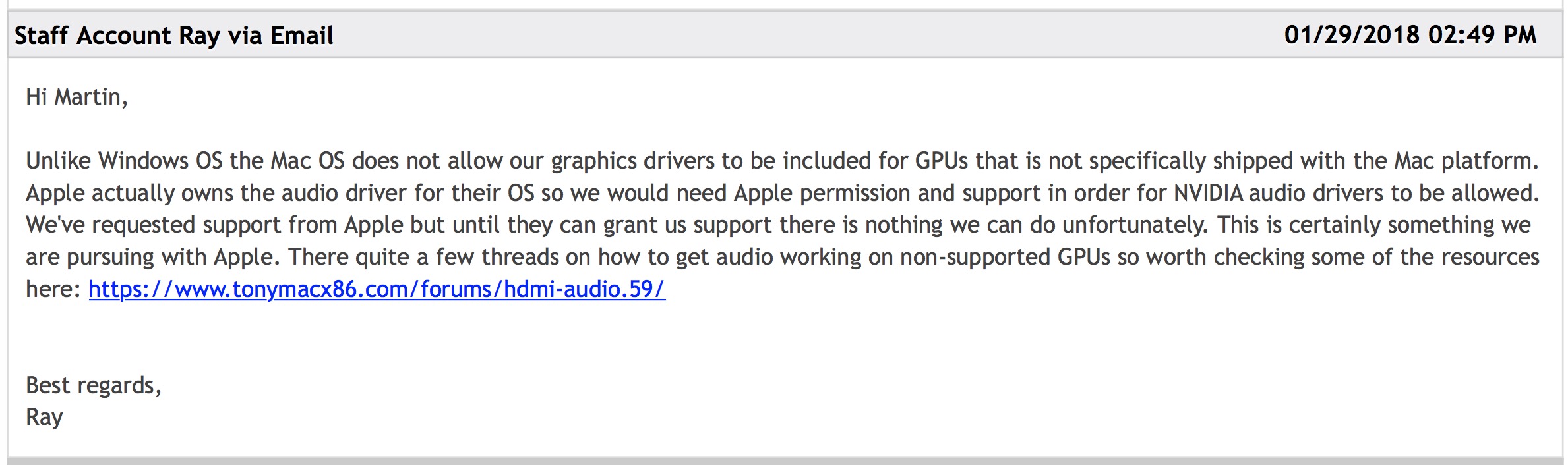

I actually opened a ticket in Nvidia support. And this is their official reply.
So, the chance of the latest web driver activate HDMI audio is zero (at this moment).
Thanks for the info.
