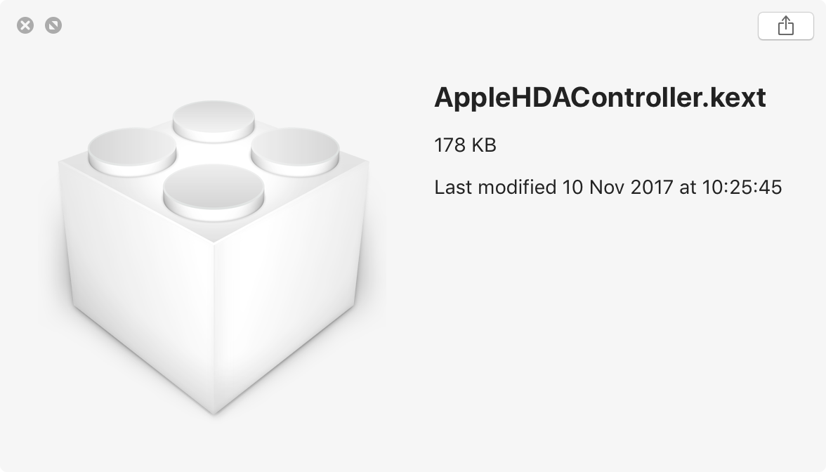

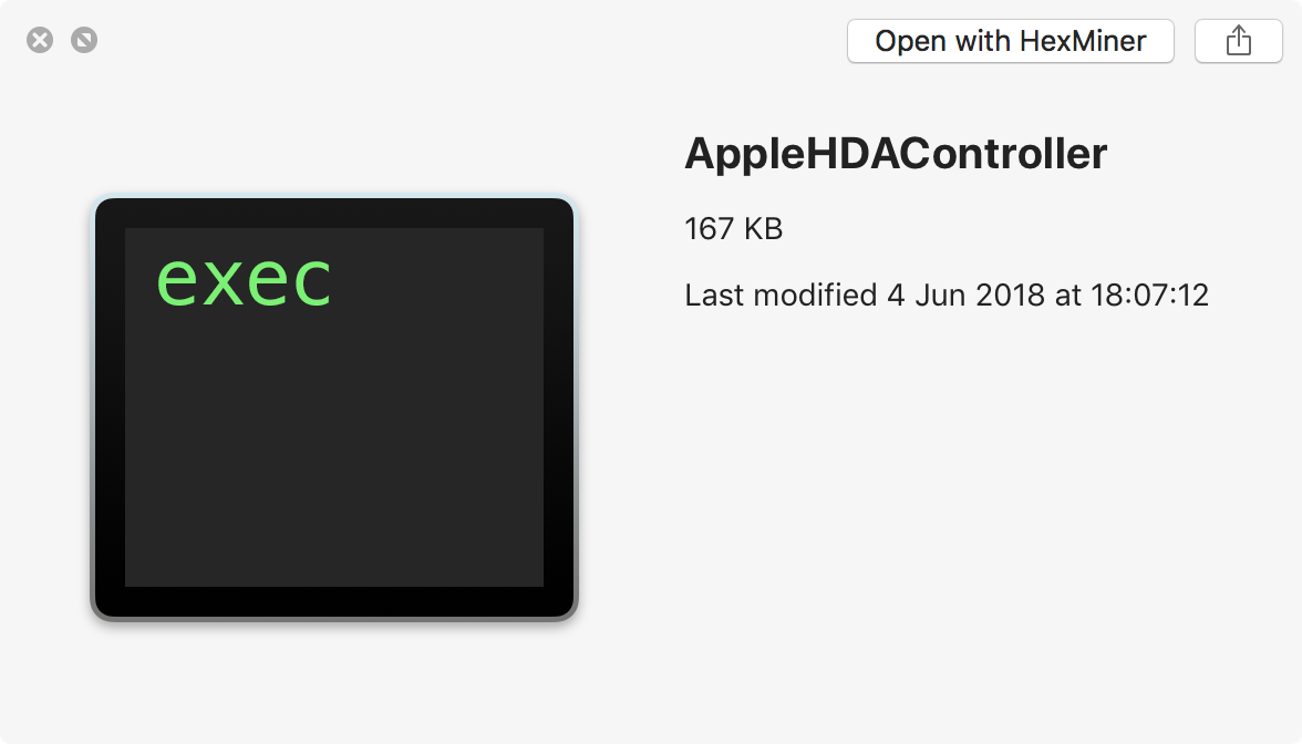

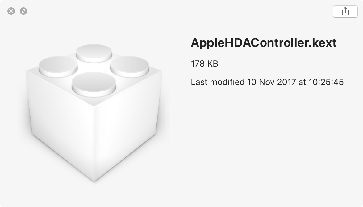

2) May be you look at the wrong place. Did you go all the way
/System/Library/Extensions/AppleHDA.kext/Contents/PlugIns/AppleHDAController.kext/Contents/MacOS to locate this file?
This is the one you should search the string and replace it accordingly.
NOT the kext itself.

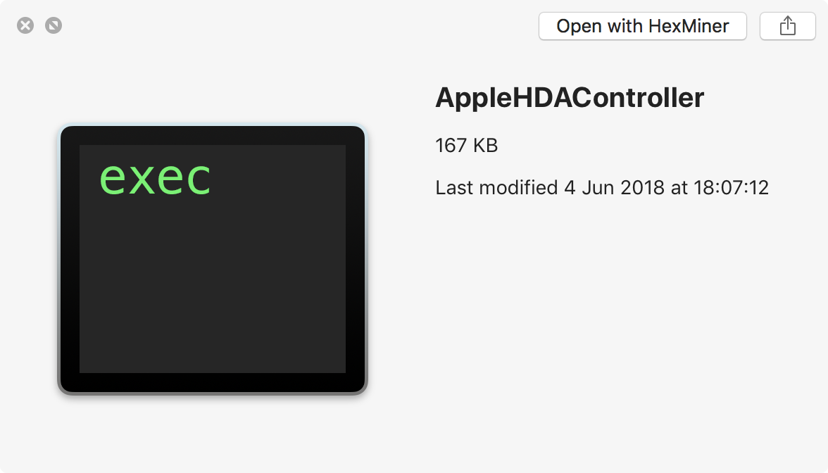

Hi H9, I had the wrong end of the stick. I see what's going on now and will give it a try.......

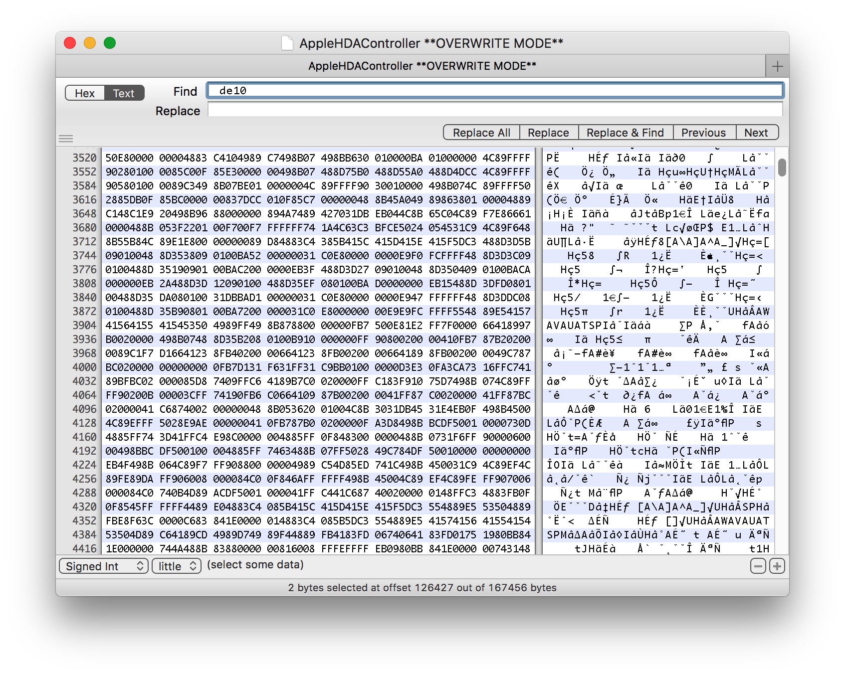

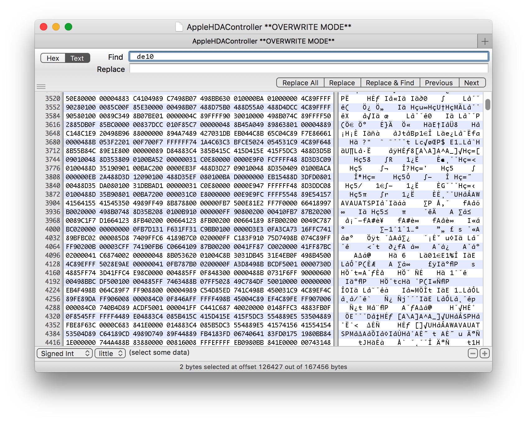

EDIT: Ok, something screwy is happening. I can't find the original Nvidia string in the HDAkext;
..........so I'm going to copy that kext from a completely untouched Mac and see what I can find.
Search for the hex, not text

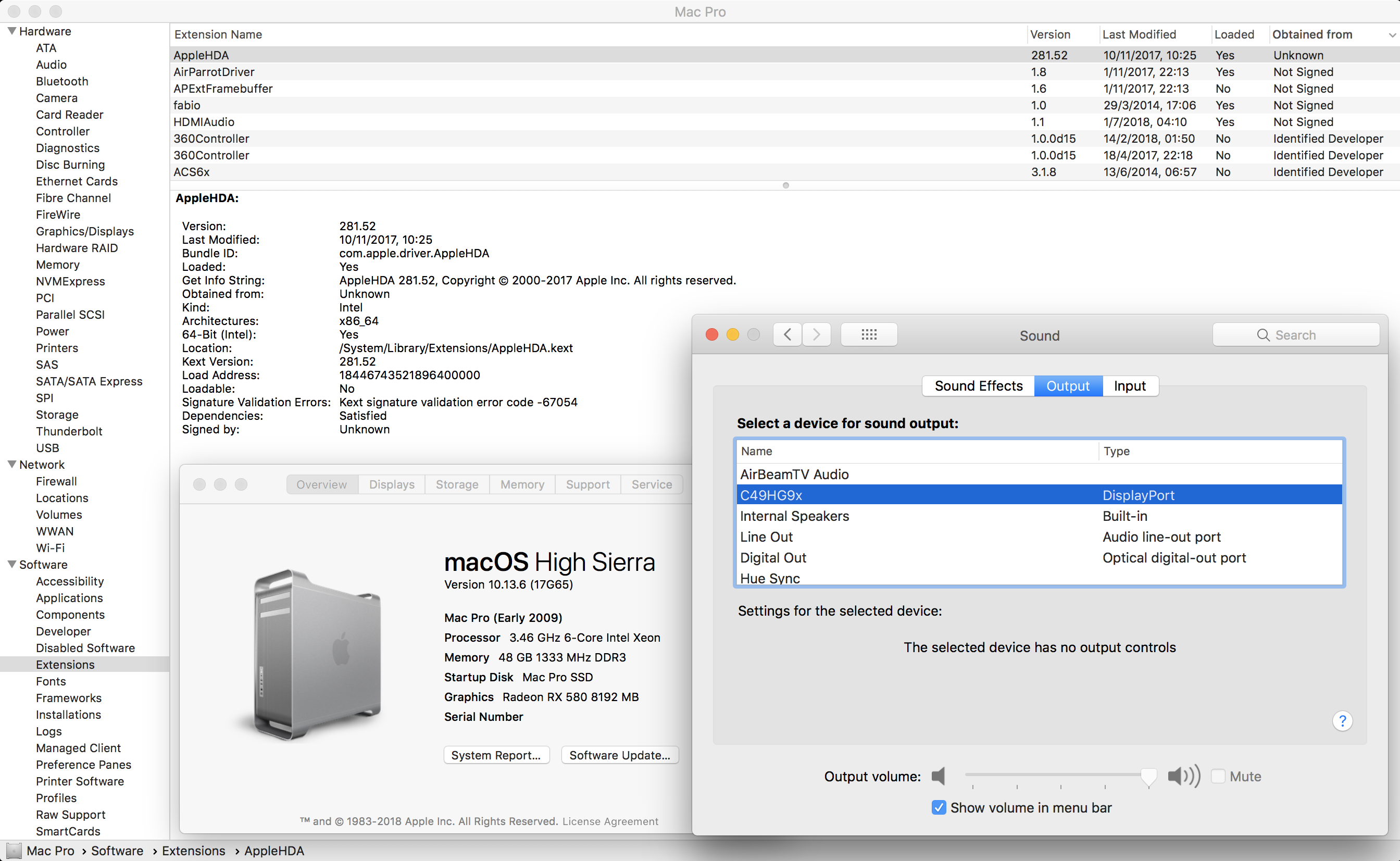

Please note that the fix is for Nvidia cards. I cannot confirm that it works for AMD cards. Try it with the right device ID (as mentioned by h98) and let us now. If it doesn't work, have a look at the WhateverGreen Lilu plugin.

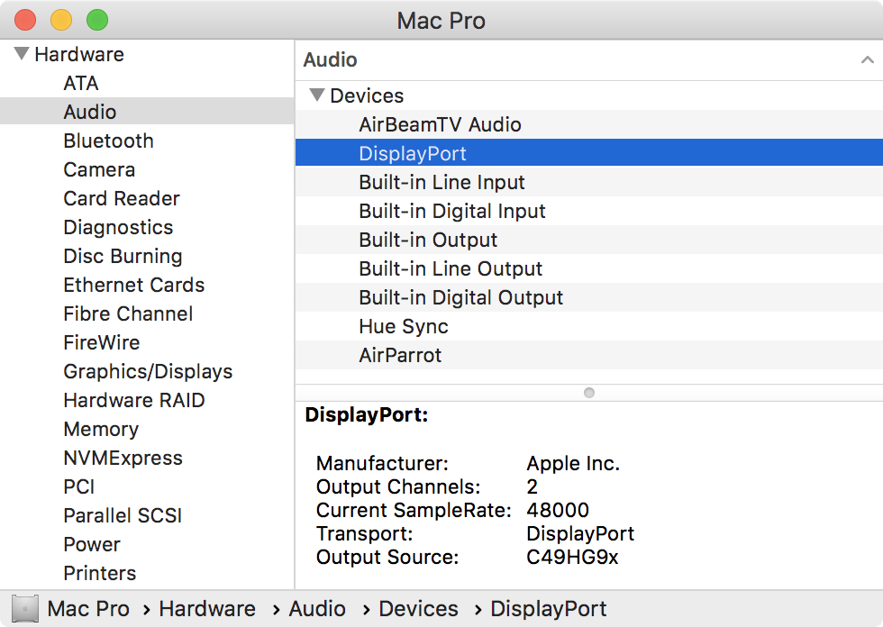

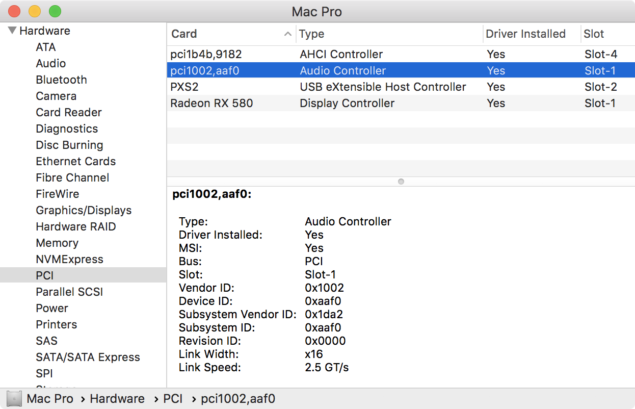

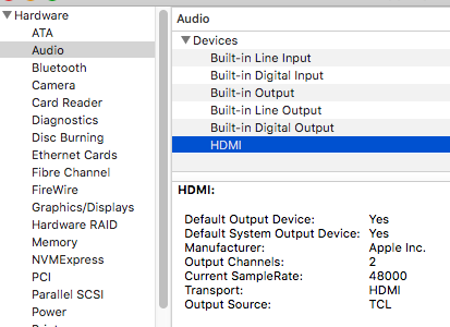

Just confirmed the exact same patch work on my RX580 as well.
Reactions: cdf

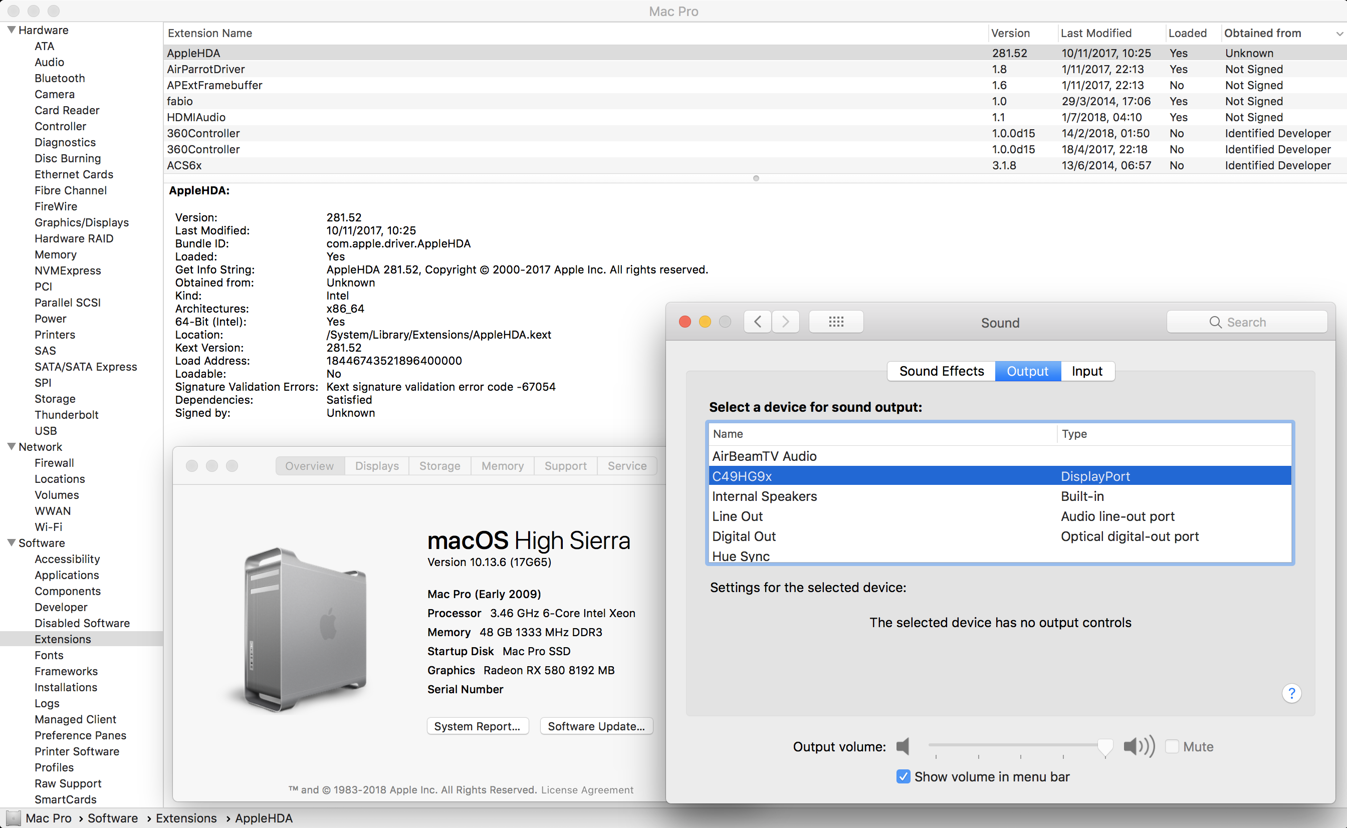

So, in the PCI info page shows audio part has driver loaded, but no relevant sound option available?

Did you patch the AppleHDAController kext yet?
I did, yes. Also reinstalled HDMI AUDIO and have SIP off. Even did the KextUtility thing too.

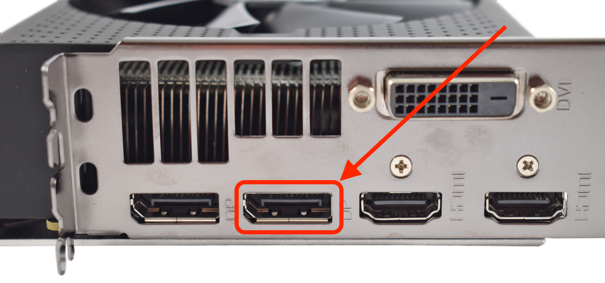

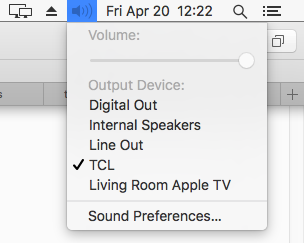

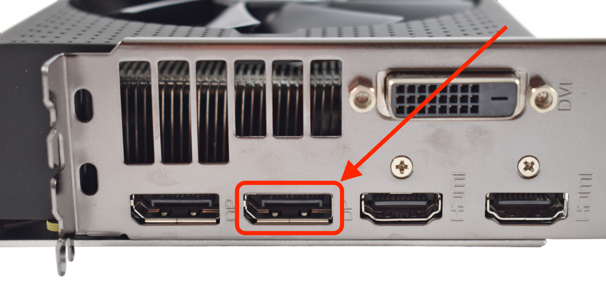

That's strange. My RX580 can still output audio even after 10.13.6 update. (Because no update on AppleHDA)
Anyway, I use this port to get audio after editing the AppleHDA kext.
If you can't get it, I suspect you didn't edit the AppleHDA kext correctly.
