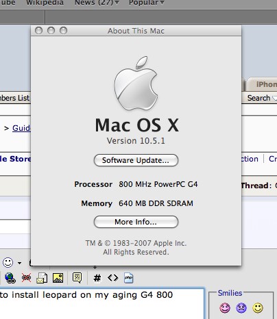

Thank you for the guide. Managed to install leopard on my aging G4 800 ibook.
Suprisingly though it seems faster than tiger on it :confused:
Dashboard, Expose & Spaces are all flying no problems, the only thing missing is the transparent menu but guess thats no big deal.
So again. Many thanks all.
